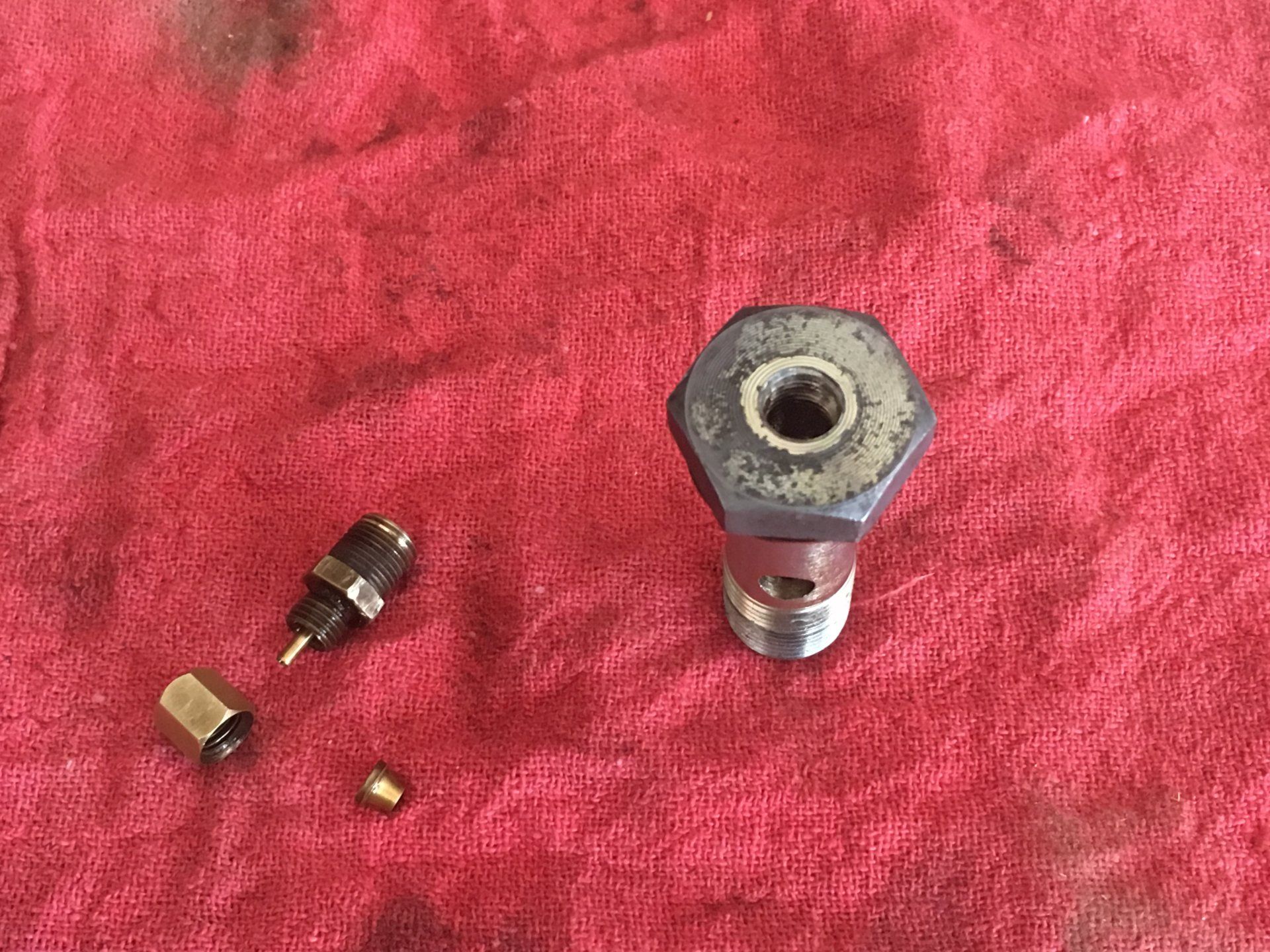

So, the gauge line is fed from this fitting coming out of the oil cooler. The “kit” gave me these fittings with the conical ferrules that don’t sufficiently clamp the plastic spaghetti line in the brass compression fitting.
First, the thread coming out of the cooler fitting is a mystery - not an NPT or metric bolt thread. Metric pipe? I have no idea. I may need to drill and re-tap the thread to something that’s obtainable here soon.
Second, full on aeroquip ferrules are needed for this line
