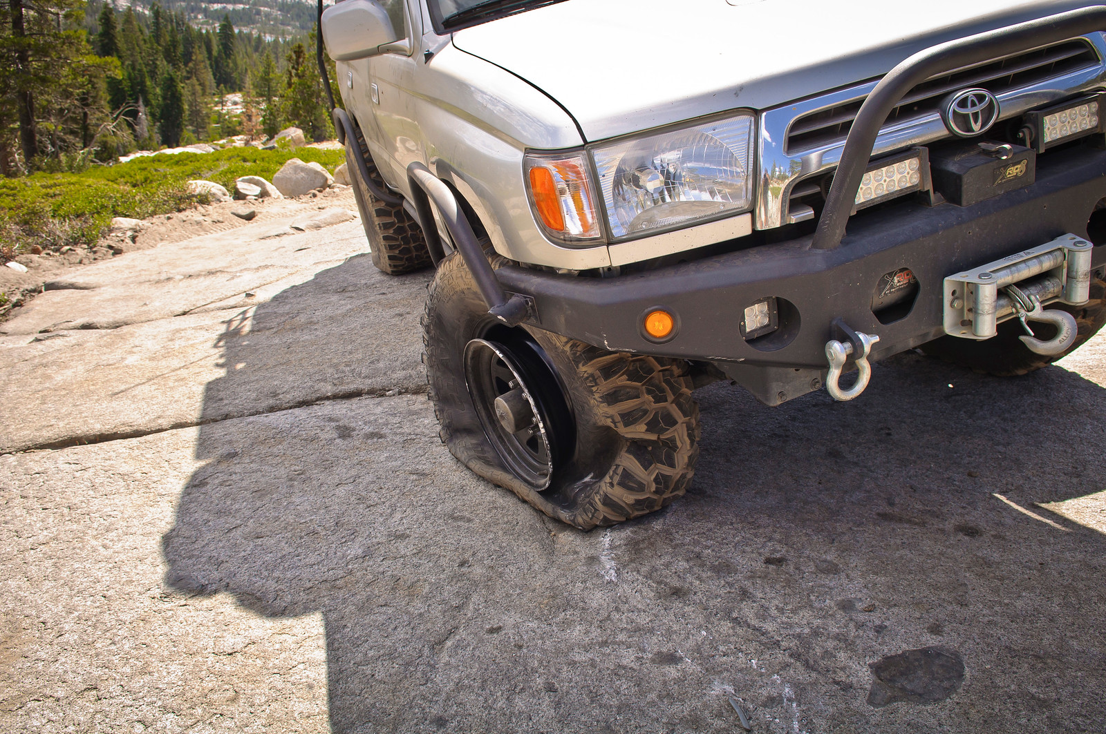

Thanks all for the comments and support. When I get home from work next week I'm going to repair the damaged undercarriage stuff. Both trails were rough on the underbelly. I bent a rear lower control arm, thrashed the exhaust and used the bumpers and sliders to their fullest. I CAN say that metaltech sliders and my 4x4 labs rear bumper more than paid for themselves on this trip. I'll sand down the surface rust that's already formed on the bare metal that I exposed from the rocks and shoot w paint. I'll probably pull the interior pieces (headliner, plastics etc) and see about pounding out the big stuff. Once I get it back together I'll drive it for a bit to see how I feel. I may buy a donor rig to hold onto in the event that I want to swap everything(I've got a line on one already). I'll post up my progress if I go that route.

I know this is an old thread...but like others have said I know that spot well. Hate everything about that whole mountainside. My buddy almost rolled on the way down. On the way up he popped a bead almost in that exact same spot, had to winch him to another rig to keep from going over. Then right after that he snapped another axle shaft (IFS).
