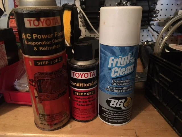

Bought these 2 cleaners a few years ago and still haven't used them. They are old enough than most of the stuff in the Toyota cans leaked out. I didn't like drilling the hole to apply and its probably better to pull the condenser out and clean it.

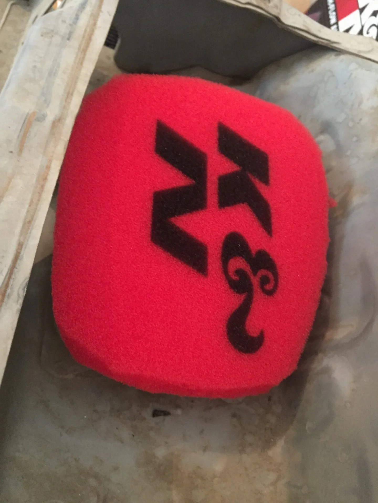

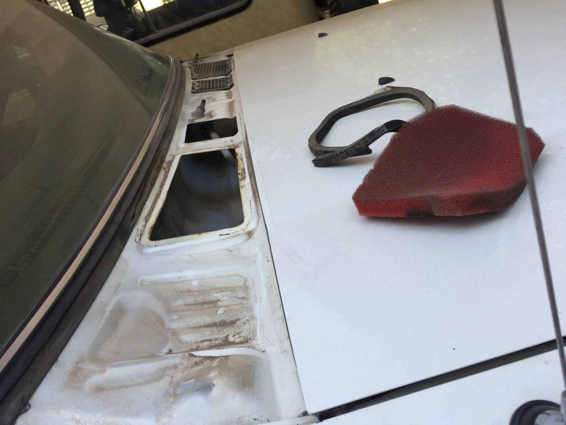

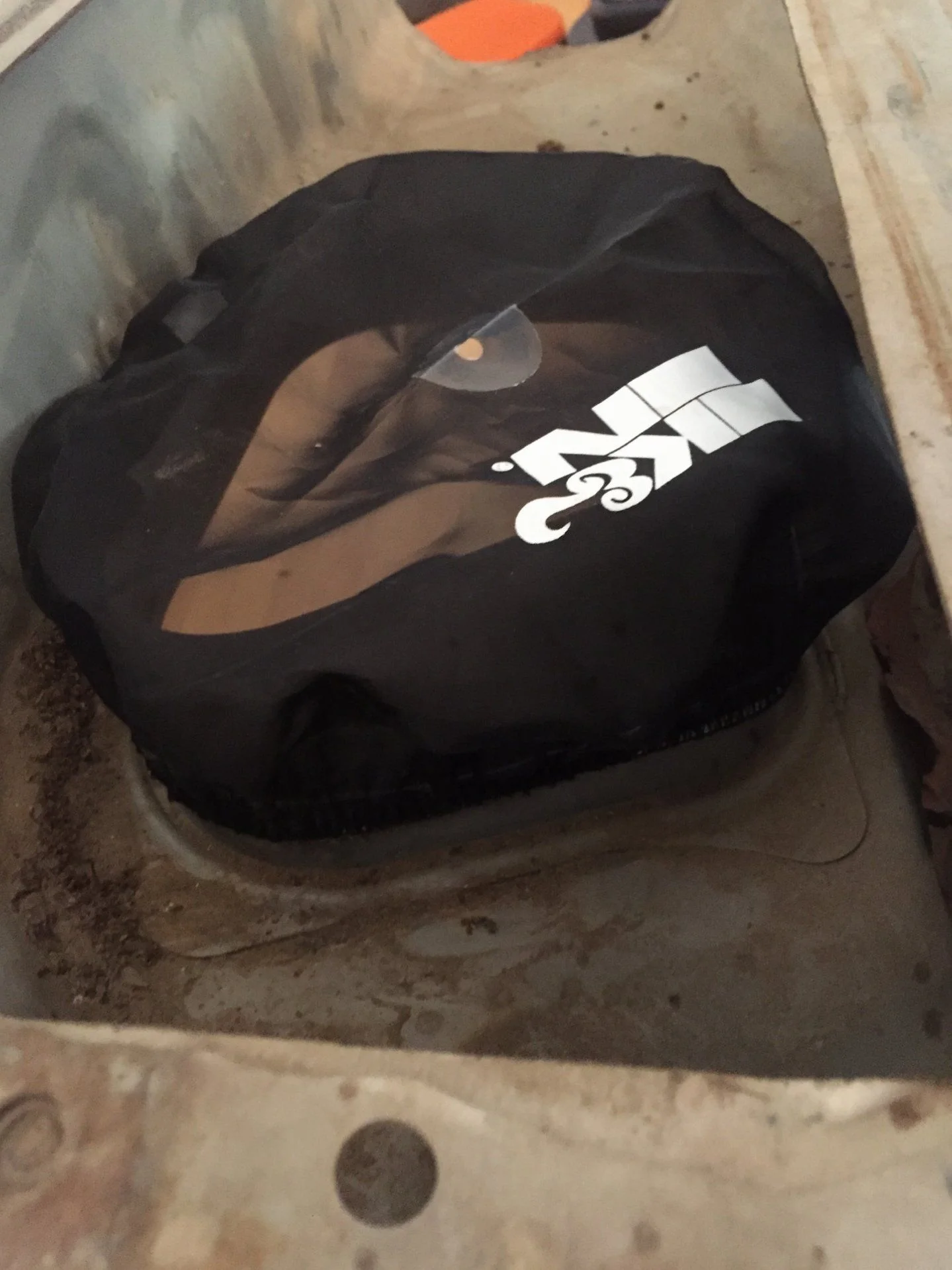

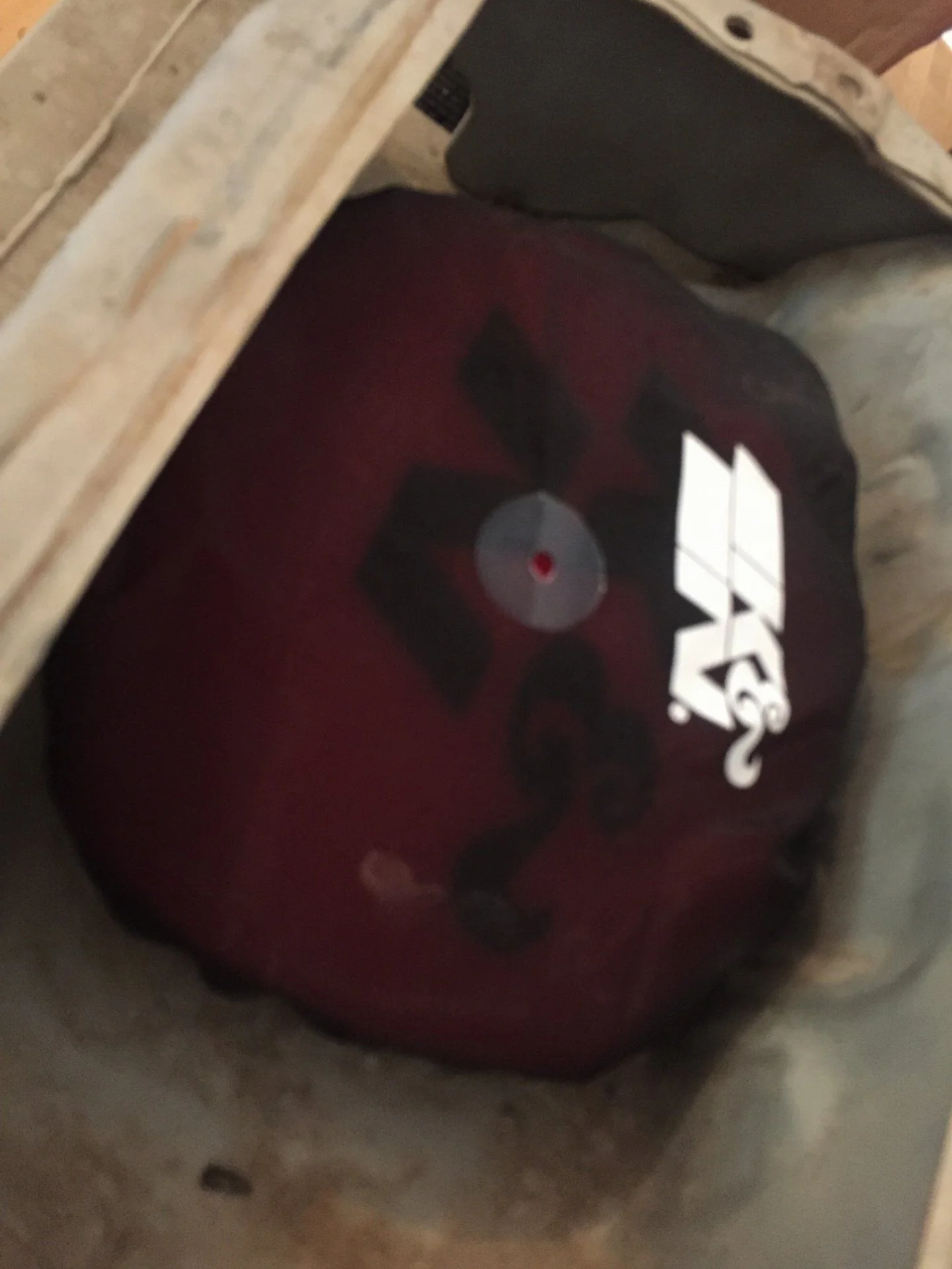

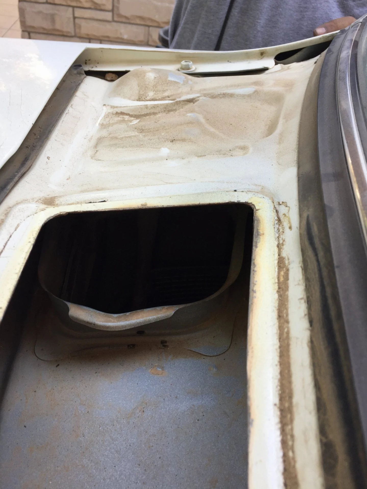

So I have finally managed to get this sorted.
Ended up using a k&n motorcycle precleaner for the air filter with a k&n flat sponge.

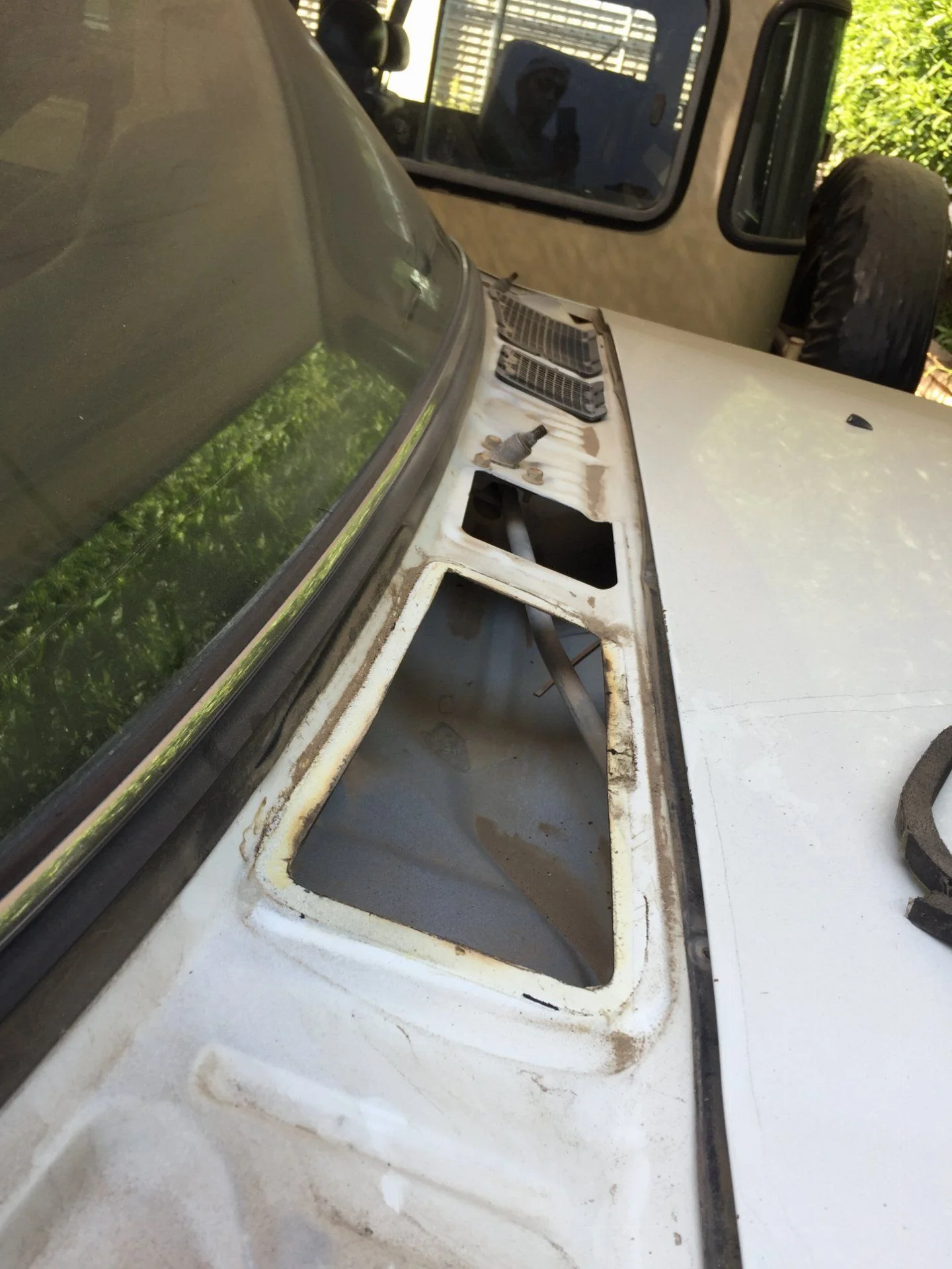

The pictures are from a cowl I got from the junkyard. But it gives you an idea of how it finally fits.
You will need to open up the cowl where there is a stamp unit for a right hand drive plastic grill. Then I closed it up with a rubber sheet and silicone to stop water from entering the new opening.
So far it's working fine.
