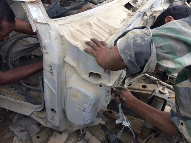

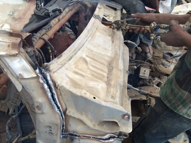

Just came back from the junk yard. Went to eye up a donor truck for the funnel and agreed on one with Joe the junker. Will cut the entire section and bring it home. From the hole above the blower all the way up to the cowl cover so we sit indoor and measure it up as the weather has turned and it's bloody hot outside.
Taking my Honda generator and disc cutter to get it tomorrow for free as he owes me money.

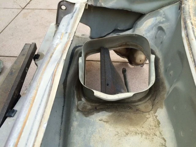

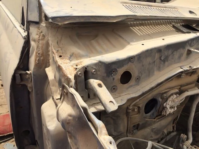

While walking around found that the fj60 has an opening in the firewall just next to the scoop and their scoops have a domed net on it. Would be checking toyodiy for related part numbers just for kicks.
Ahhh. Also noticed the FJ 60 has these drains which are way cool

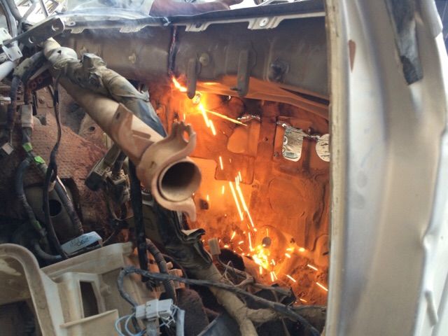

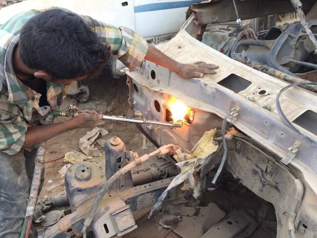

That appears to be more than a Honda generator and a disk cutter.
Well spotted.
It was faster that way.

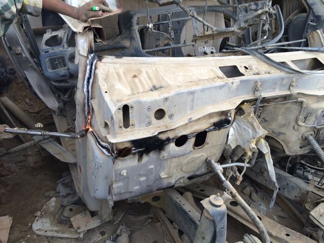

Decided to get the guys to do the cutting. They ended up running out of gas so we pulled the disc cutter and generator out but was also out of gas.
So I had a choice to either go get gas for them of fuel for us and decided to go with the acetylene. Way faster.

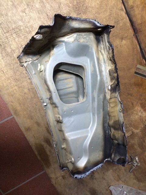

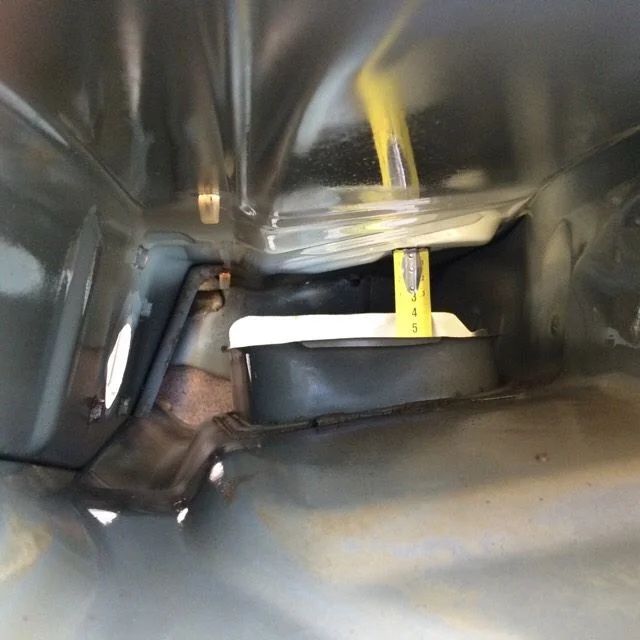

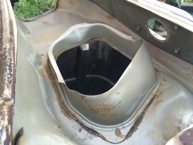

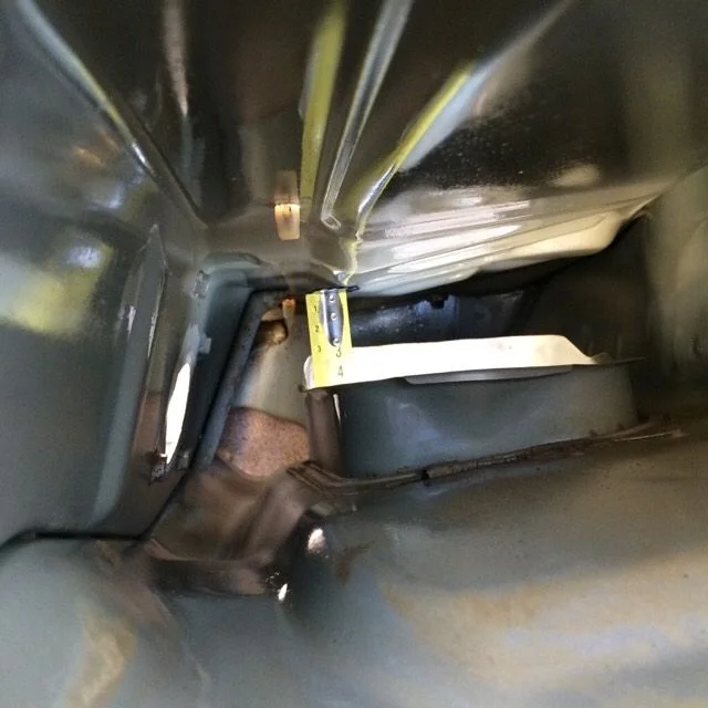

Ok guys. Managed to get some measurements taken of the space inside before I cut the top section.
Measurement where taken at each corner to show the difference of heights in the cavity.
Corner closest to the passenger and windscreen

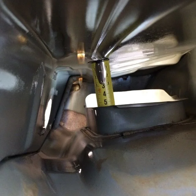

Corner on the passenger side but closest to wiper motor

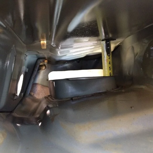

Driver side corner closest to engine bay
Driver side corner closest to windscreen.

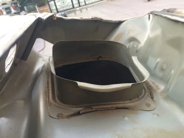

Also, are we assuming the horizontal lips on the driver's side half of the intake snorkel are to keep water from sloshing inside? or did maybe toyota design it for a filter and never finish the project?

No idea why there are flaps. Maybe it's for the splash
