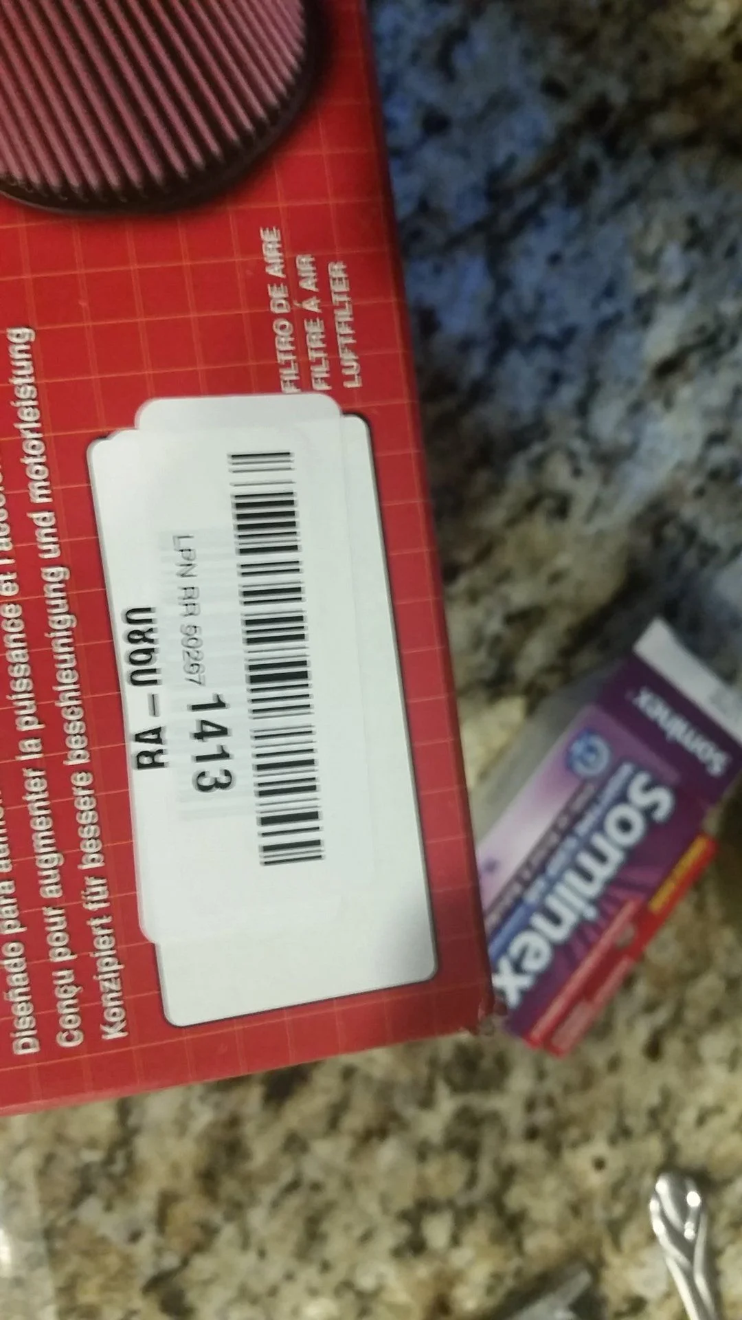

i think it was this part number for the pre cleaner as i bought 10 different sizes to try them for the best fit.
K&N Engineering KT-4511DK air filter wrap
Amazon.com: K&N Engineering KT-4511DK Air Filter Wrap: Automotive

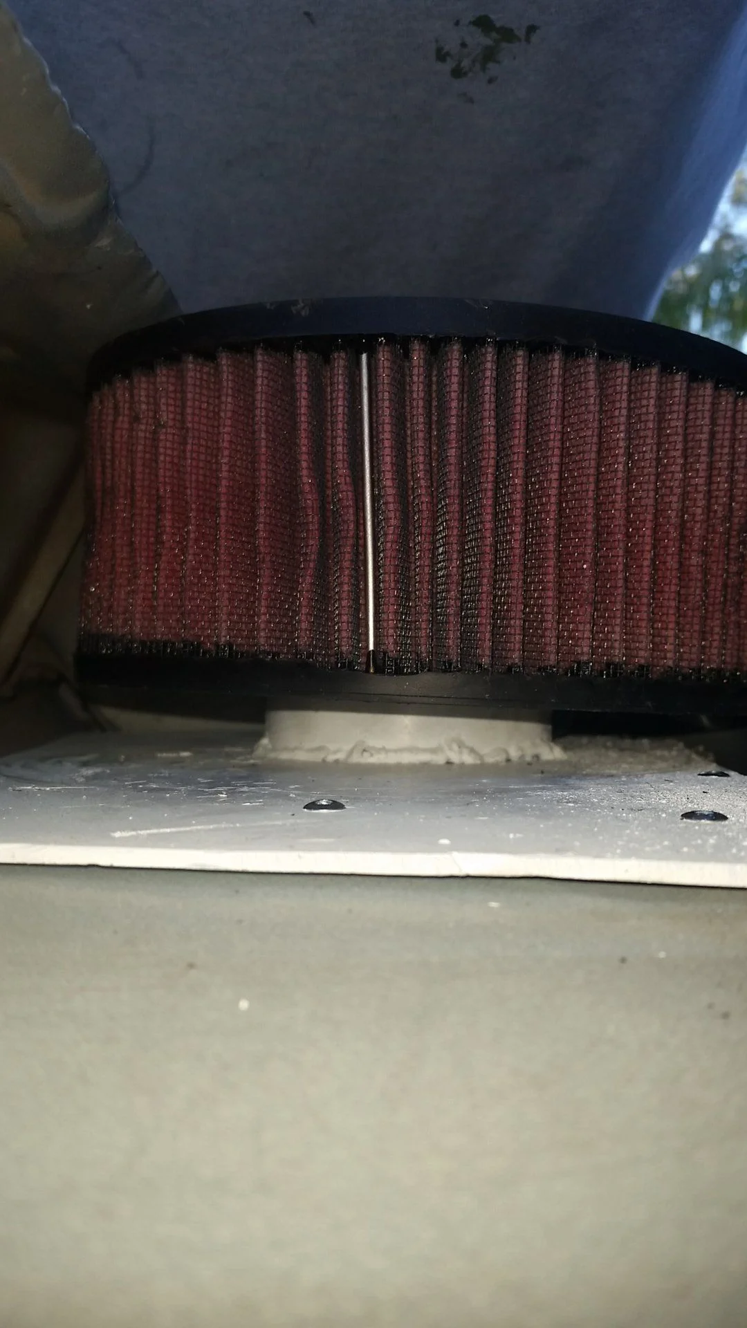

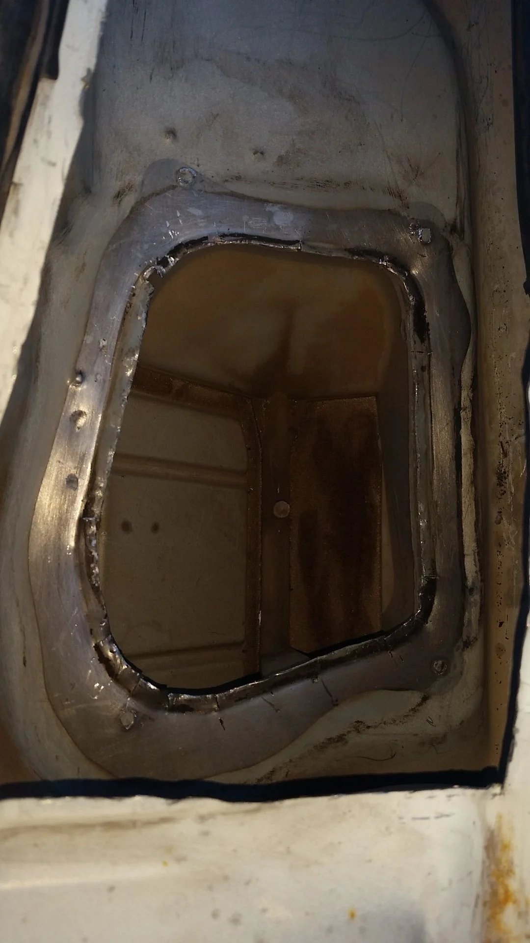

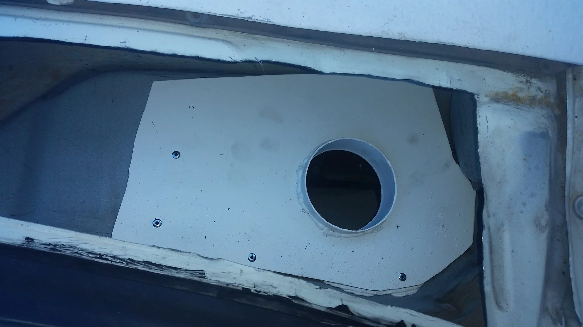

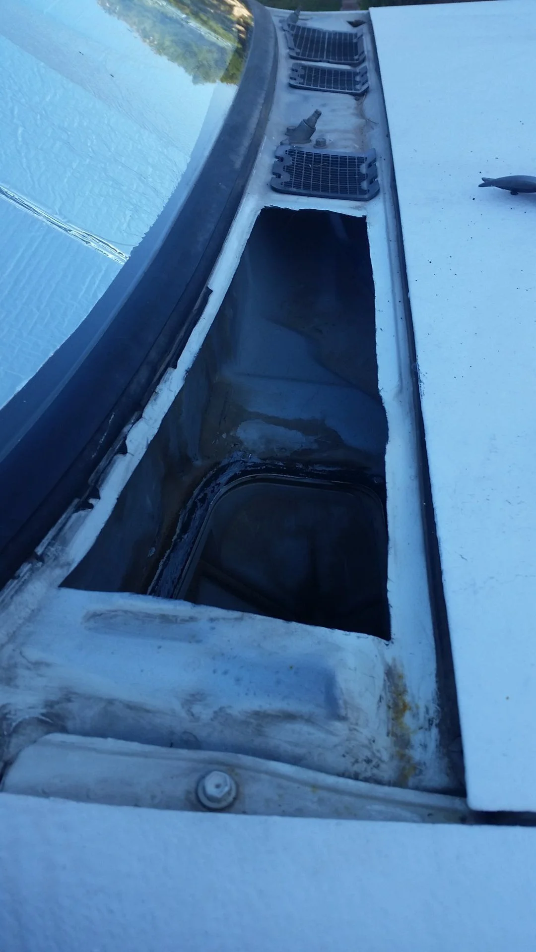

So after my last four wheel drive trip and getting hit in the face with dust on the way home I decided to do this. I also decided to go completely different route instead of trying to work with Toyota funky Mount I decided to make my own which then opened up my options for air filters also trying to fight with everything in that tiny little hole isn't going to work either so I made the hole bigger
Snorkel with two arms: one to cabin, one to intake????????????
