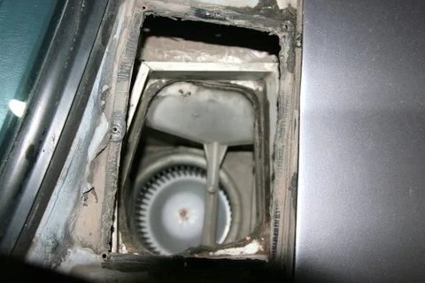

FJ80 cabin air intake
I am thinking of cutting in shape of the inner duct right above the cabin air intake and make custom duct with cowl snorkel on top of the panel. Something like that but more accurately.
Cut in like that, and install this kind of snorkel with air filter inside, but little lower to the panel.
Why not just find a flat K&N filter a little bit bigger than the hole and wire it in place? In my experience they are pretty good at water repelling and since they con go so long between cleanings, you can just forget about for a couple years.

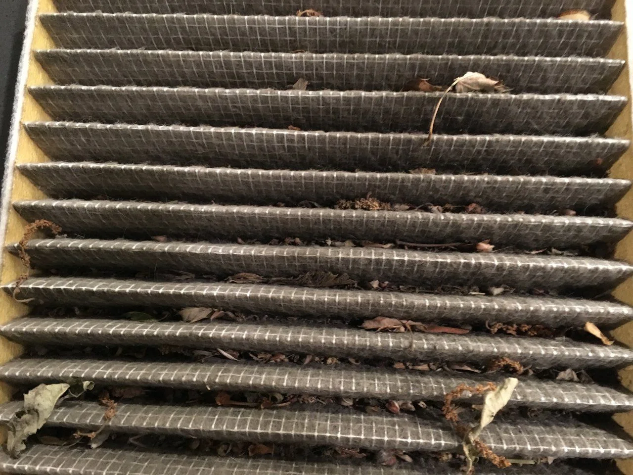

I just replaced my cabin filter in my Camry and was floored!
I was hoping we would have that intake scanned, have 3D printed adapter, and a commonly available slide in filter by now.

I don't own an 80 anymore to work off of. I might be open to developing something this summer when I have some time off. I could probably use a locals 80 for the dimensions.
I may be able to get this scanned and a holder printed. Any recommendation on what filter? If I can get the filter, I can create the adaptor to bridge the two.
Wonder if a filter/filter holder could be designed to slide up into the plastic duct just before it enters the AC condenser box??

How tough is it to get the grille off to see the inside?

5 or 6 screws IIRC. Not difficult at all.
