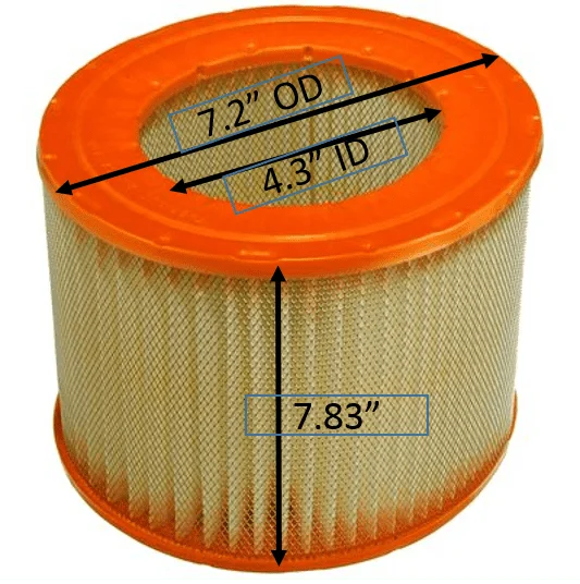

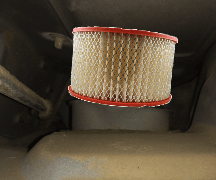

FJ80 cabin air intake
That's great work! I wonder why go with a strange shaped filter element but instead make your adapter but place a widely available square/rectangular filter above the funnel. Simply adapt the weird shape to a square received placing the filter above it but keeping the slide in cartridge idea. Easy peasy. ;)
Agreed. Only reason not to would be more surface area.
I would love to do that. But space in there is against us. Will measure again today.

What I was thinking is a filter like this, based on dimensions, would it fit and allow for full flow of air with minimal changes? Maybe needs a sheet metal interface on the bottom where it connects with truck. Then the top is jammed against top metal (as it is rubbery) and stays in place like that. this filter is $6.99 FRAM CA3688. The sheet metal interface could be cut with simple tin snips (until mass produced by one of us). The filter would be up and out of the water, and it is an engine air filter so should work fine if wet.

Now that I printed the scale version of the opening, the OD of the filter would almost cover the entire area. It wouldn't fit in intact, I would slice one side to it can slide into the opening first (then add filler to complete circle), add a simple clamp to ensure it stays in shape. If the vertical distance is too short we are screwed. But if it is just short, capping the top to provide some mechanical securing method might not be too hard. I will tinker this summer on it. Might even fire up my old version of Pro-E and design an interface and cost it out.

Is there enough room between the sheet metal louvered cowl cover and the plastic grills beneath that a few rectangular pleated filters could be clipped to one surface or the other in that space? The problem I see is that in the rain the paper pleated filters would cause a lot of very humid air to be sucked down the intake when the fan is on. If the filter material didn't adsorb water that might not be an issue, but then were would the water drain to? Just brain storming to stimulate ideas for possible solutions.
How is that humidity issue any different than the current setup?
