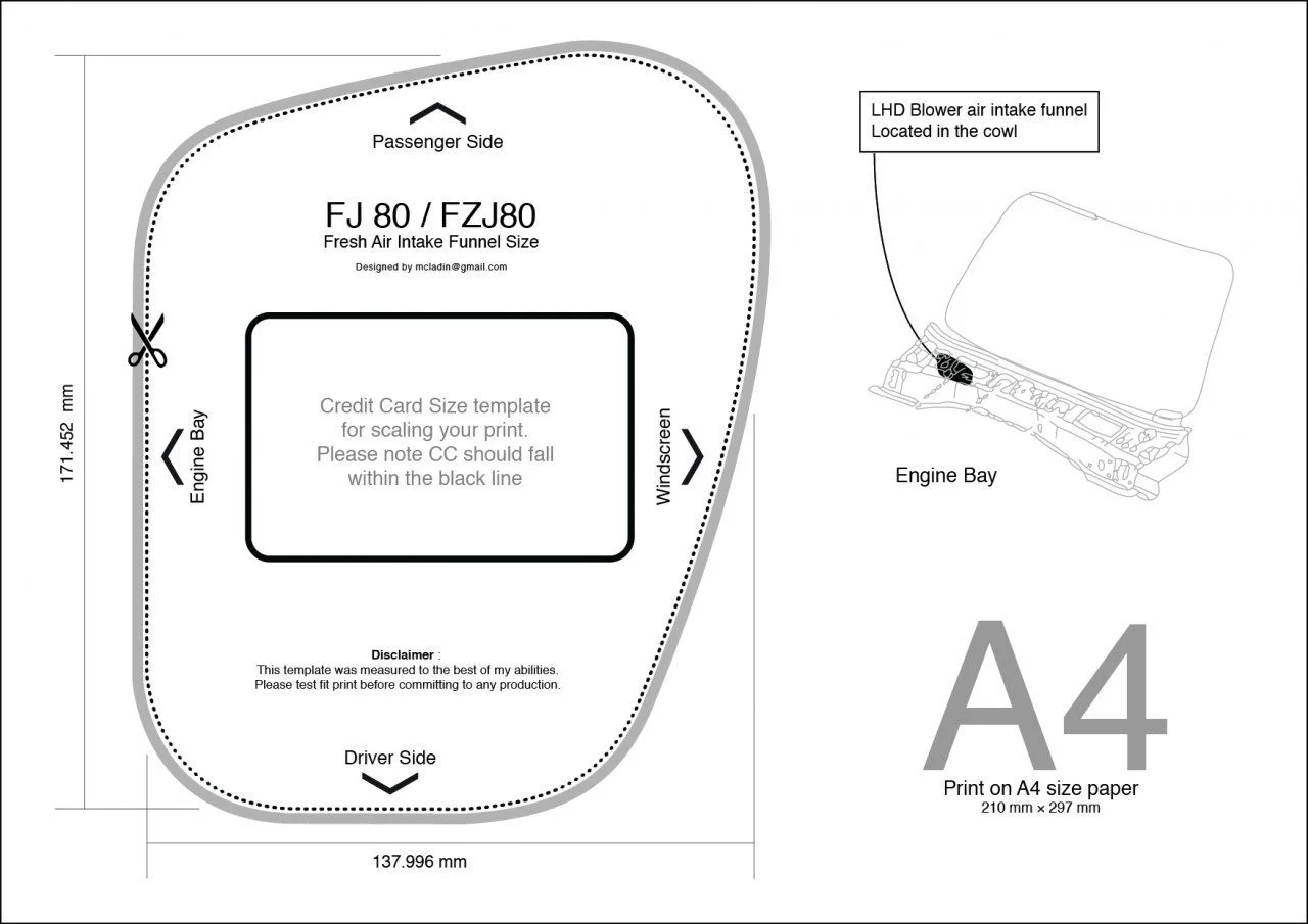

I don't know what's the best way to measure it as it's not a square
Any ideas on the best way to measure it ?
Put a small ruler/scale/measure in the picture and then take the photo from straight above... I can then scan that into CAD and puslish a PDF/CAD template for folks to download as they'd like.
Ok. I'll scan it and make a pdf file for you in its actual size.
Printable Funnel Size template.
Ok here you go guys have put some effort into a dummy proof printable template.
I hope this helps.

The driver/passenger is for LHD vehicles right?
Ok, maybe I'm dumb, but I'm having a hard time following what the final design is here. Are you going to make your own stand-alone writeup at the end?
Dumb no, confused maybe : ) . This template or size was requested by some of the guys on mud. I presume they will either develop their own solution or send it to a company to make them a filter.
So in no way is it a solution at this stage.
Was not planning on making my own build thread. Just solving it in here if that's alright ?
Stay tuned and hopefully we will all have something to add to the development of a solution.

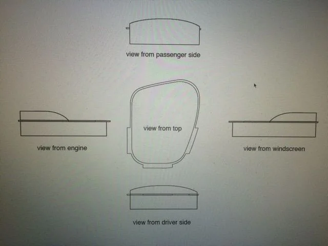

Started to hash out some ideas on paper.
The problem is that the funnel has an elevated area on the passenger side
Which makes sticking anything on top impossible. The solution needs to slide in and clip onto the flaps
These are rough elevations of the funnel just for thought.

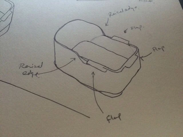

I think this would be a good solution
Placing a permanent case that can hold a filter. The only problem is the size of the filter is reduced due to the strange shape.
So working on another idea. Will share it when it's done.
