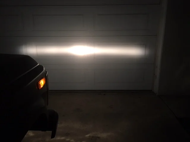

Xprite installed on one side. I have used it since Tuesday the 9th, and so far the beam is perfect. The only problem is that it doesn't exactly fit in the headlight bucket, but some convincing makes it happen.

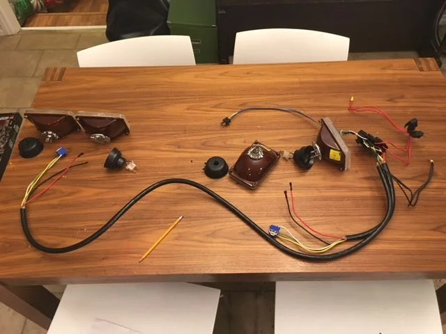

I just installed the Susquehanna Motorsports harness in my 62 last night and I'm VERY pleased with the results. I was intimidated by it at first because I couldn't figure out how I was going to tap in to the existing harness/switch, but once I realized that I was literally plugging the new harness directly (gray cable at the top of the harness pic) into the connector where the low-beam bulb would plug in to the stock harness, it all made sense... too easy.
Susquehanna supplied the harness
HL282S SMS Upgrade Headlamp Harness for Switched Ground Vehicles
as well as the headlamps and bulbs.
They were very responsive and knew their stuff. I would call them and consult with them about exactly what you need before making an order. I'm a measure thrice, cut once kind of guy though, so that's just me.

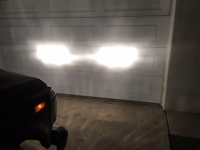

I did install the 4x Xprite's according to the diagram here: Instructions for LED Headlight upgrade so that I've got 4 low beams, and 4 high beams. While the Xprite LEDs are an improvement over the old halogen headlights, I'm not super impressed with them. They are bright, but have a very short throw and the high beams don't really light up much more than the low beams. The hard part was building the harness though, so maybe someone else will come out with some nicer 4x6 Hi/Lo LEDs that don't break the bank. Swapping out headlights (now that I drilled out all the old rusty screws in the headlight buckets) is the easy part.
Anything is an improvement over the halogens, did you have a hard time putting the xprite lenses into the existing headlight cage?
I kinda had to "stuff" them in there, but they fit without having to cut anything. I had to hold the headlights in just the right position while tightening the cage down. Also, two of the headlights are already foggy on the inside. But like you said, anything is an improvement over the halogens. For the moment, I'm happy.
