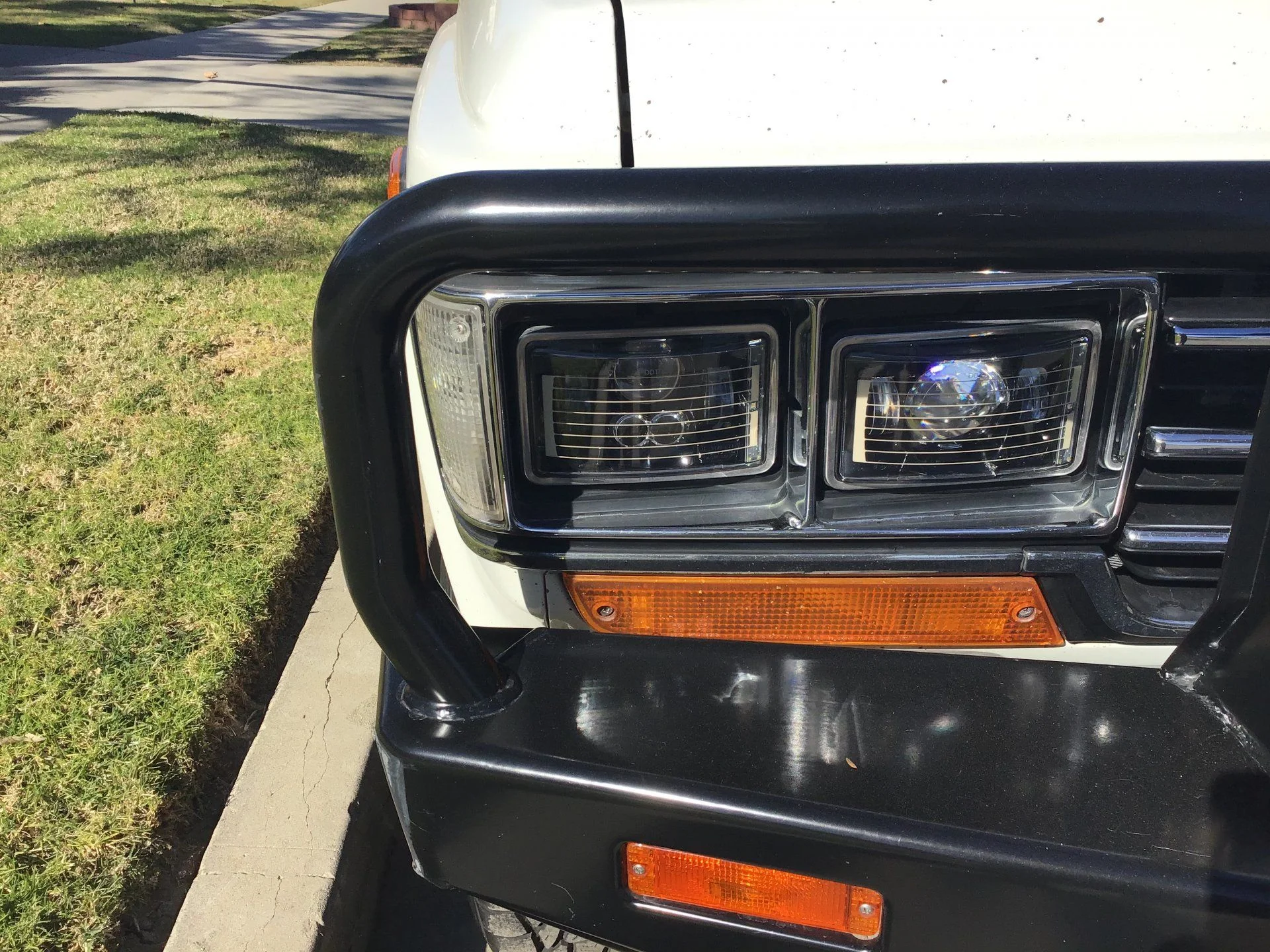

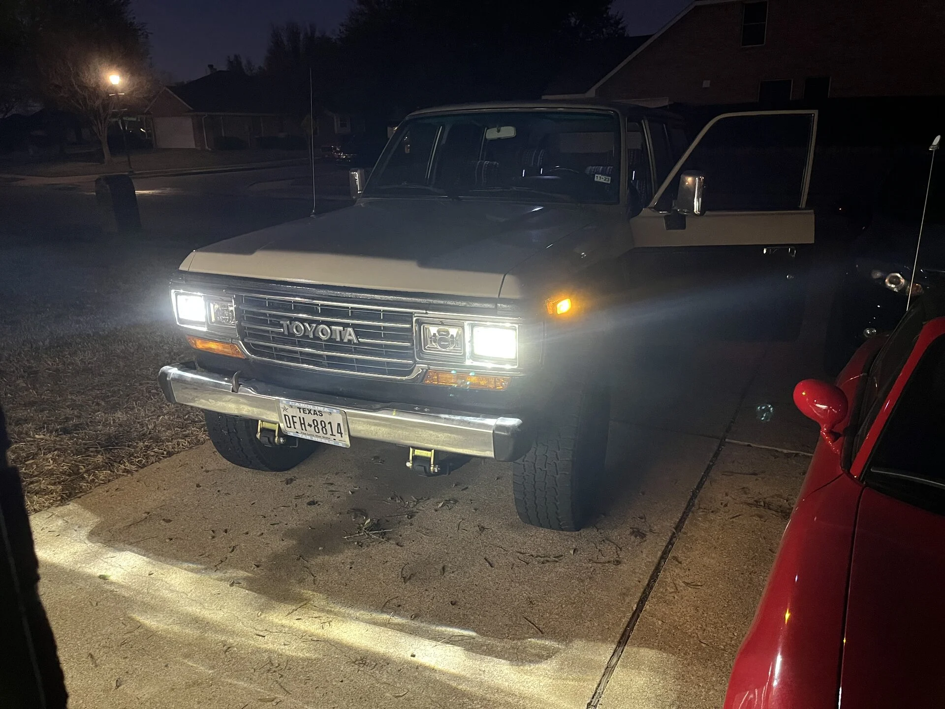

I installed LED from JW Speaker and upgraded the wiring harness from Daniel Stern lighting. Huge difference !!

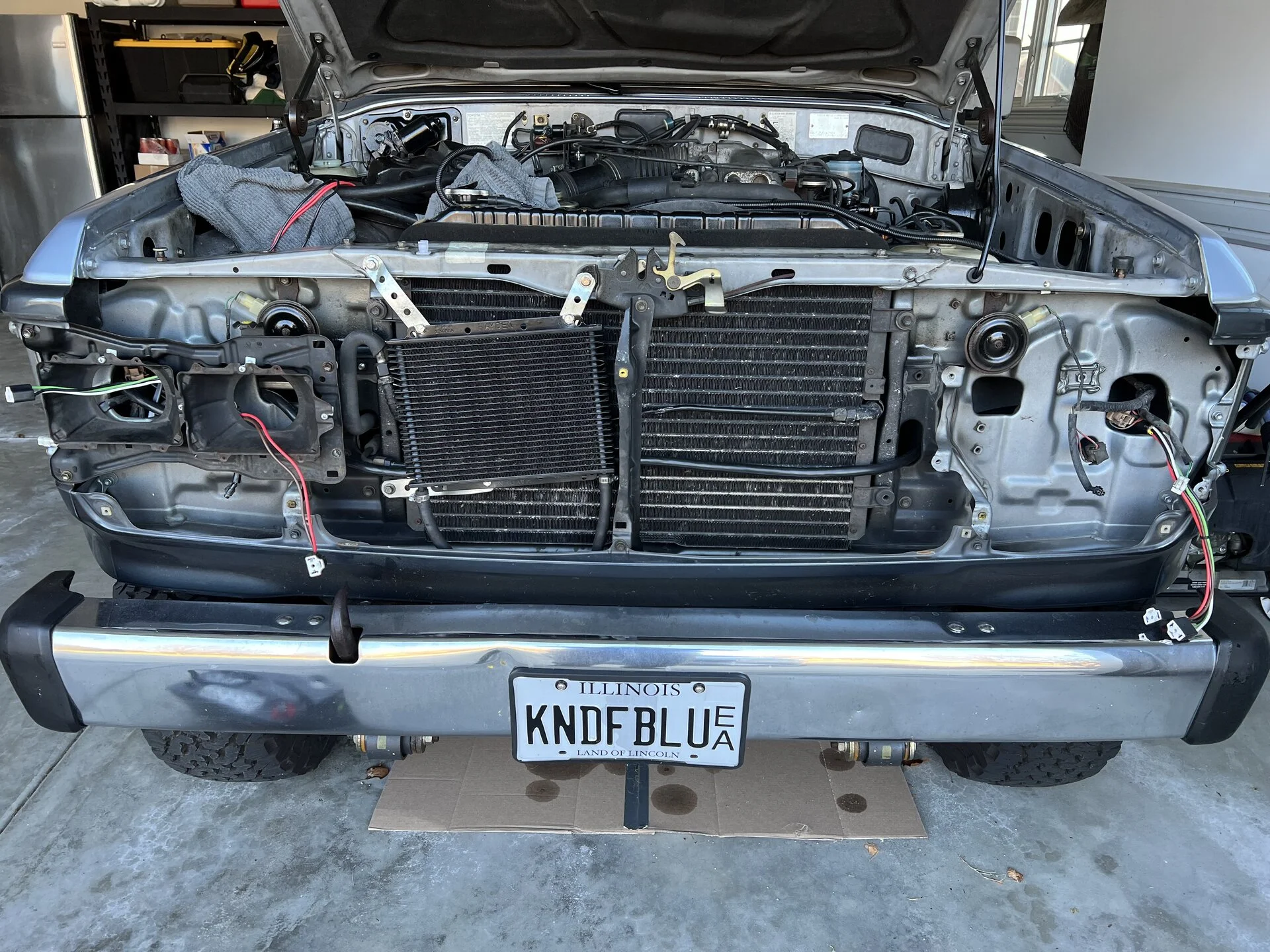

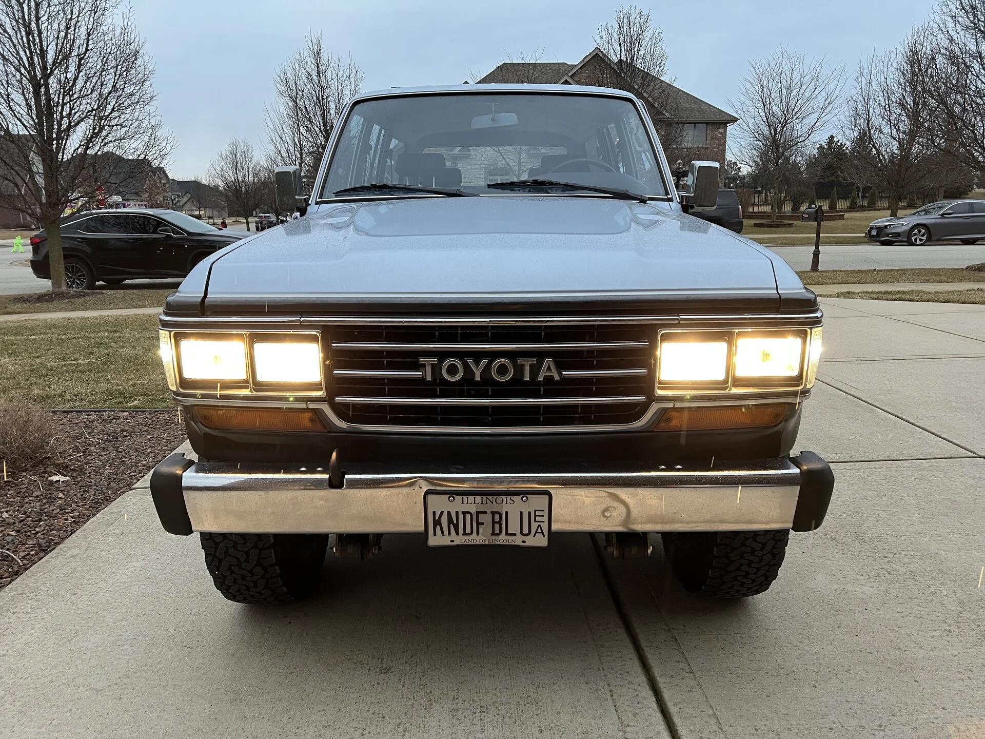

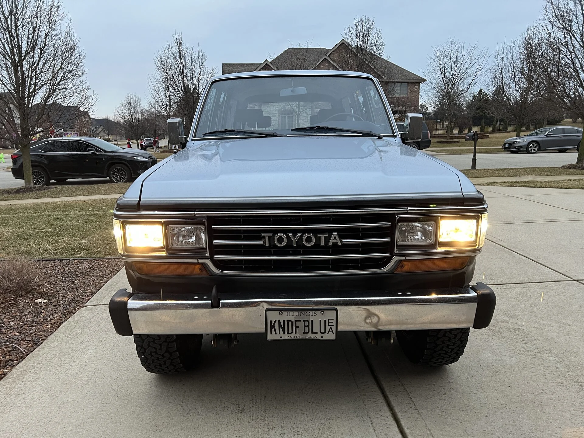

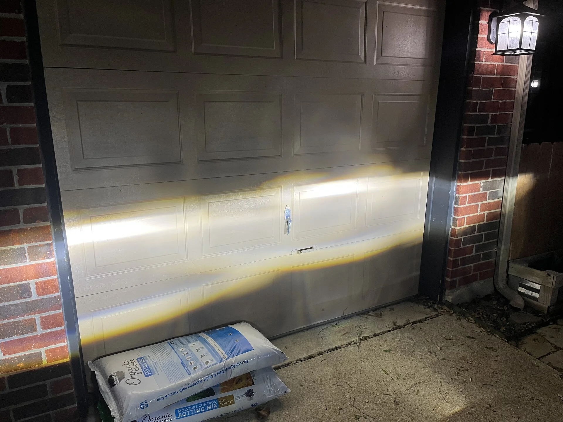

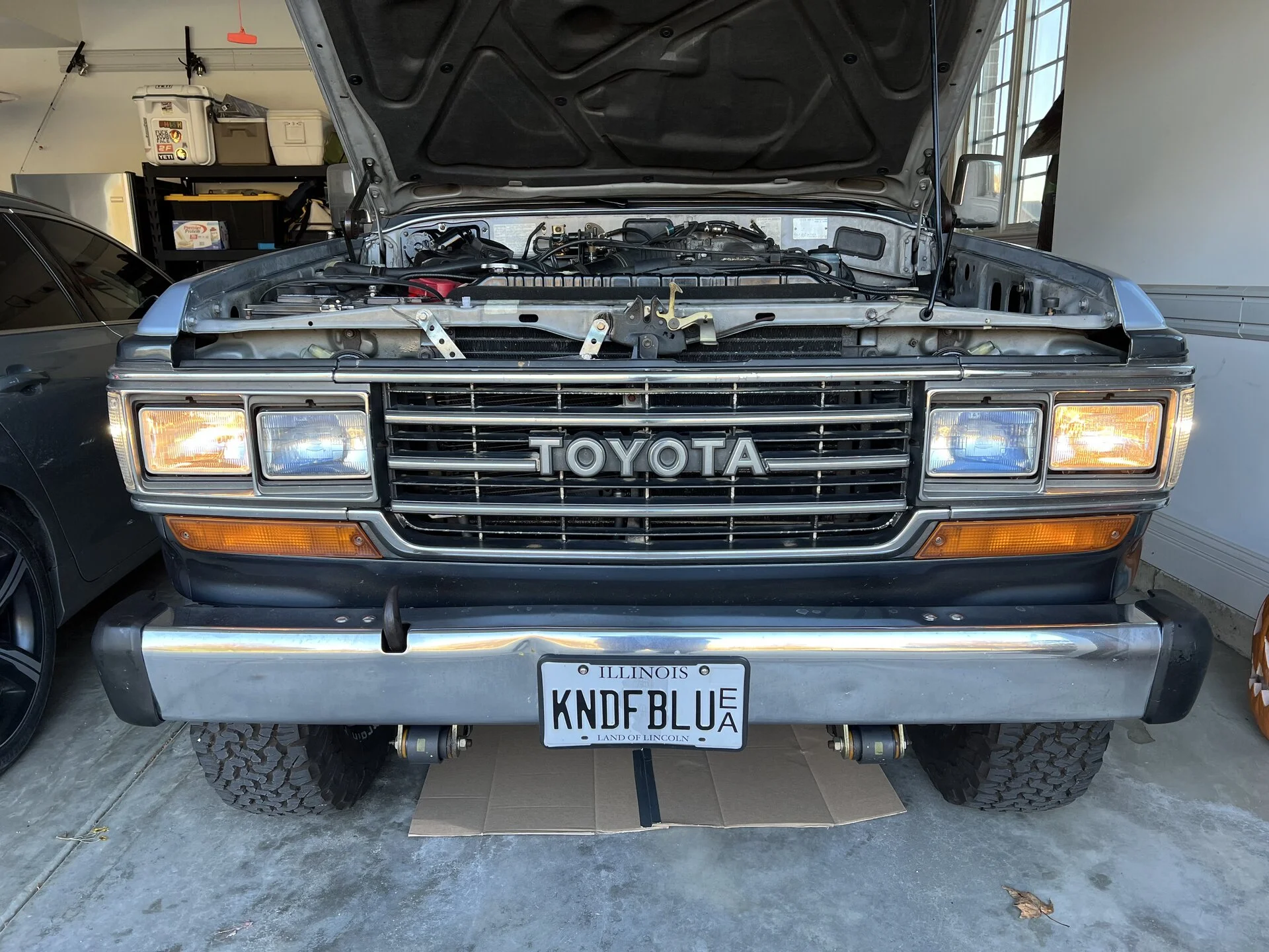

Just finished the install on my 62. I went with SMS harness and Hella H1/H4 housings with Hella +50% halogen bulbs for each. Came in at $450 delivered all in. Went this route as it was important to me to keep the "sealed beam" look to the lenses which these Hellas do.
Worth a note, before you start I'd suggest ordering new retainer screws at a minimum. I also got new adjustment screws and springs but could have probably reused those. Retainers were all toast.
Prior to my install my hi beams didn't really work so my before is just low beam.
Here is new:

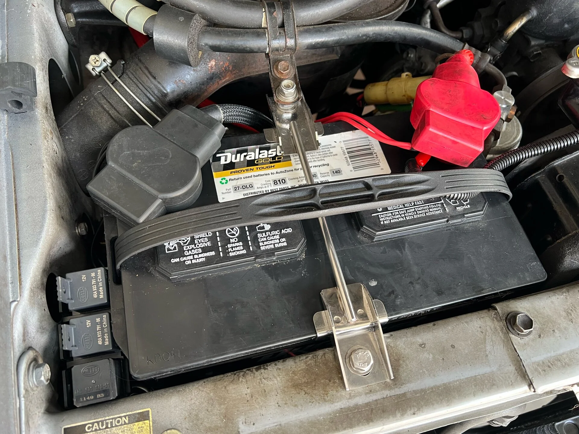

I ran my relays next to my battery. Not a ton of room as I have a Group 27 battery but they seem secure enough just from the wiring below them to hold in place. So no mounting plate or anything.
Ran my wiring across front of condenser (and under my trans cooler) to driver side. Zip-tied a few spots where possible.
