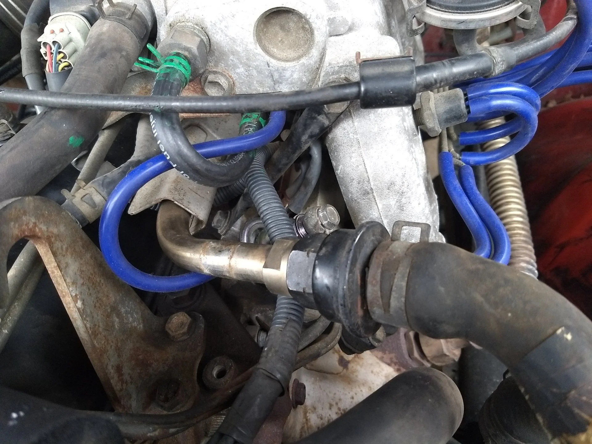

Just got in the W0133-1743784 Kyosan fuel pressure regulator. It bolted right up! I had to replace the vacuum line with a piece approx 4" longer to dodge the smog pump pipe as that the angle of the vacuum inlet is positioned 45 deg away from oem location. Ran her up the interstate and back home. Killed it, waited about 20 minutes and she fired right up so YEAY!!!! The 2nd pict below is the original on the left that started this whole thing the one on the right is the POS that cruiserparts.net sent me for 50$ plus shipping. I think it was sitting in the bottom of a muddy bin somewhere and they hosed it off and sent it! THANK YOU @c2dfj45 and red66toy for passing this on. I'll let you know if it goes awry, but I think it's probly gold!!!

Just got in the W0133-1743784 Kyosan fuel pressure regulator. It bolted right up! I had to replace the vacuum line with a piece approx 4" longer to dodge the smog pump pipe as that the angle of the vacuum inlet is positioned 45 deg away from oem location. Ran her up the interstate and back home. Killed it, waited about 20 minutes and she fired right up so YEAY!!!! The 2nd pict below is the original on the left that started this whole thing the one on the right is the POS that cruiserparts.net sent me for 50$ plus shipping. I think it was sitting in the bottom of a muddy bin somewhere and they hosed it off and sent it! THANK YOU @c2dfj45 and red66toy for passing this on. I'll let you know if it goes awry, but I think it's probly gold!!!View attachment 1600238 View attachment 1600236

Just to further confirm these FPRs work as a replacement. Fuel pressure readings are well within spec for the FJ62 per the FSM. Just wanted to close this out with an actual check with pressure readings.
