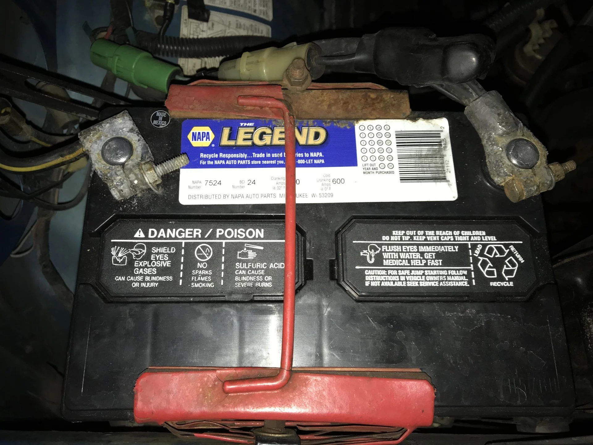

Cleaned the battery terminals. They were cleaner than I thought. I think the problem is a bit deeper.

Cleaned battery terminals last night. No improvement this morning. Moving to next solution; starter???
