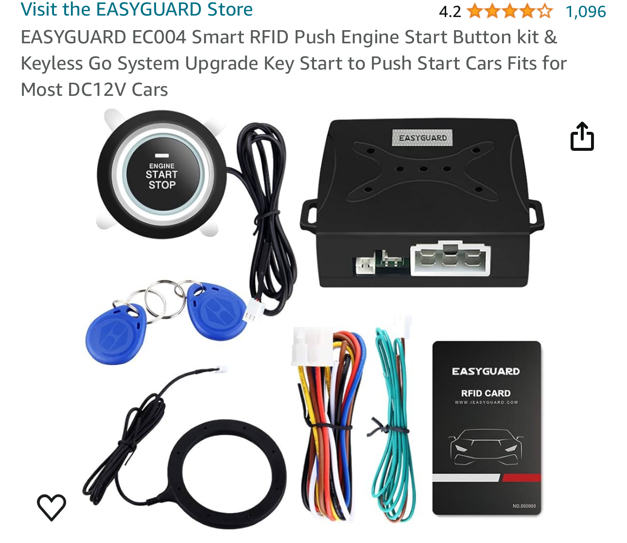

Additional layers of security could involve rfid switches to switch your kill switch or have it set-up to switch a fuel cut off valve.
EASYGUARD EC004 Smart RFID Push Engine Start Button kit & Keyless Go System Upgrade Key Start to Push Start Cars Fits for Most DC12V Cars
https://www.amazon.com/dp/B00HCAYQ0G?tag=ihco-20
I’d love to layer this in my own rig for the convenience factor alone.
Would prevent the screwdriver starting the ignition. If they bypass the starter kill switch they are only going to get so far with the fuel cut off.
Prices to add these two things would be about $200 in material costs approximately.

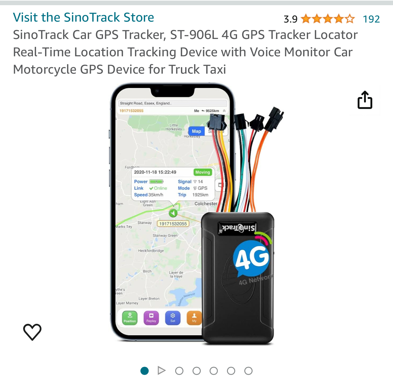

Lastly would be to add a gps tracker (monthly fees) with geofencing (get a notification that the vehicle is moved outside of an area). Some of these include sim and activation type so that you can deactivate the efi circuit or fuel line switch and starve/immobilize the vehicle (gamble if it is driving or stopped). Wire in a hidden secondary battery or make sure that it has one internally in case someone disconnects the main battery. Hide the antenna and make sure it still works for a signal in case someone rips out extraneous wiring trying to hide gps signals.
SinoTrack Car GPS Tracker,... https://www.amazon.com/dp/B07Q6JFQWK?tag=ihco-20
With a pro car thief. If they want the vehicle they can get it with a rollback truck and drag it to where they can lift it.
I’d still like to be able to know where they take it so I can contact the PD and send them to recover it.
