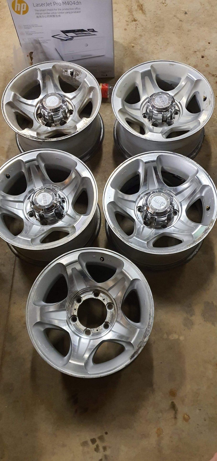

I was able to find some 16" Wheels I had on my 80 series. However covid is restricting me currently to pick them up.

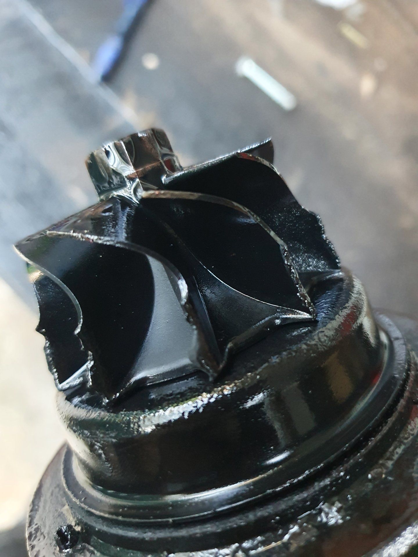

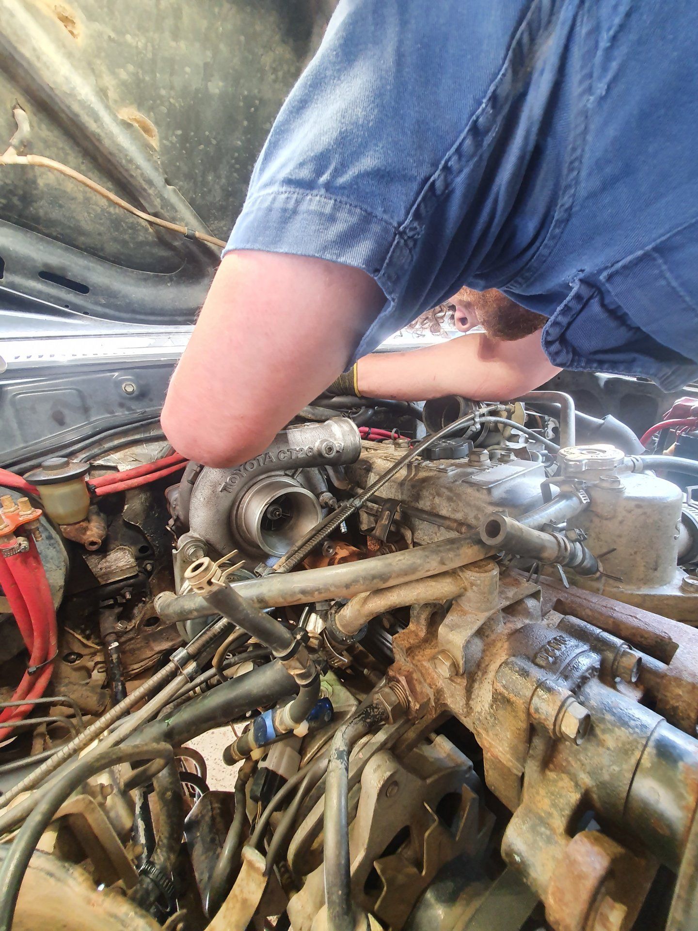

In my travels my mate's 13BT had been making a horrible squeeling noise. Now this motor has 400,000km. So after a few sanity checks of Belts/Pulleys we noted that the Turbo Impella was on the way out.
So out goes the old CT26 and in goes the new one. Quick days work. Fired it up, only for the squeal to return.
Few more checks and determined the Water Pump was the culprit.

Thankfully the effort we put in wasn't wasted. Rear impella and bearings were shot. The noise we were chasing was the Water Pump and Idller pulley.

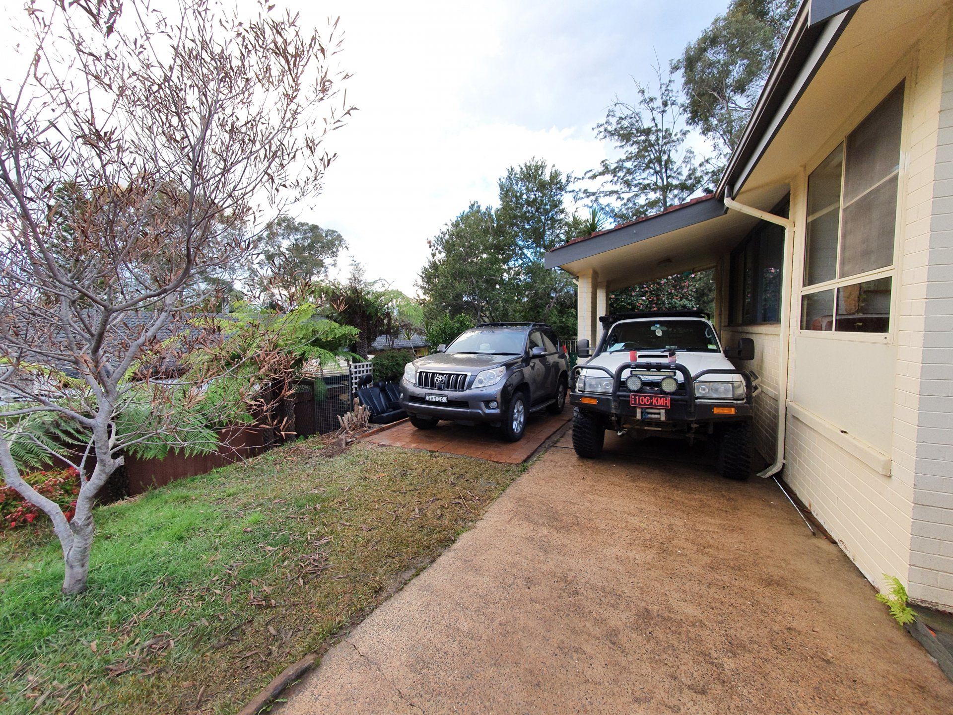

Took a day out yesterday to celebrate my upcoming 30th birthday. The Prado handled the tracks without any issue.
Having never wheeled an Automatic Vehicle was strange, let alone with Centre/Rear diff locks, Traction control and Crawl Control.
