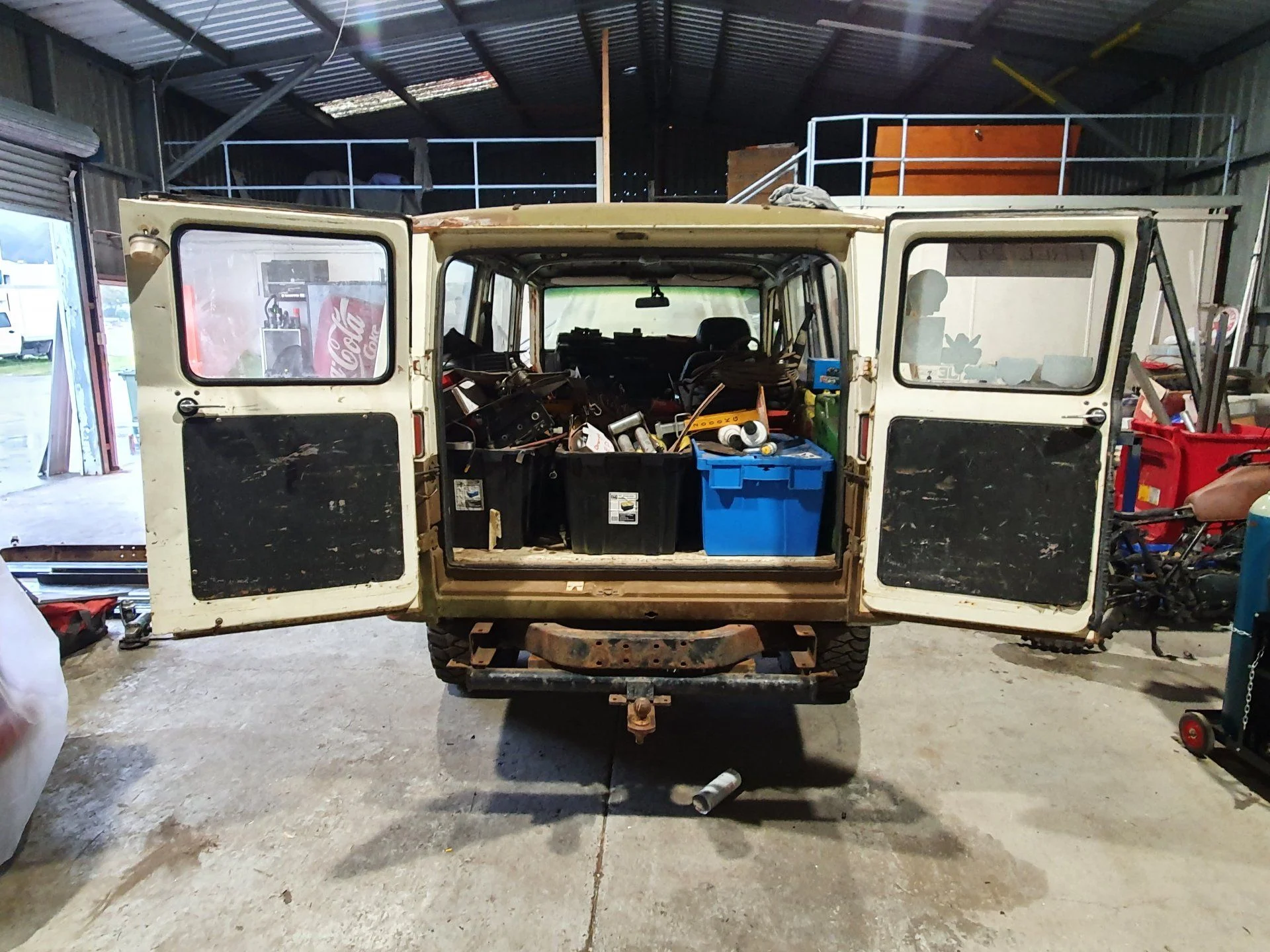

Next on the list I will be attempting to bend up some pipe for a rear quater slider. This is the style Ill be after. Welded right to the Tow Bar. Thoughts?
Looks pretty sweet, but I’ll be interested to hear how much of a pain the install is, getting the frame end of the slider mounts around the rivets and rear tub mounts while sliding the receiver in at the same time. My old bumper/receiver was kinda similar and used to like to fight going in and coming out.

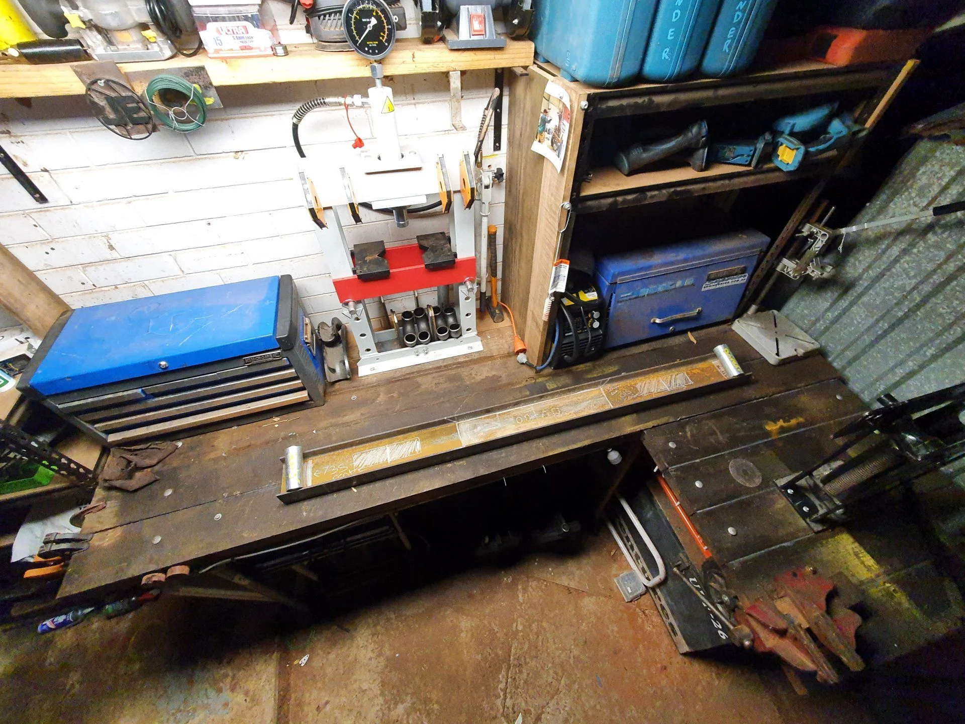

Got some time today to hit the metal suppliers.

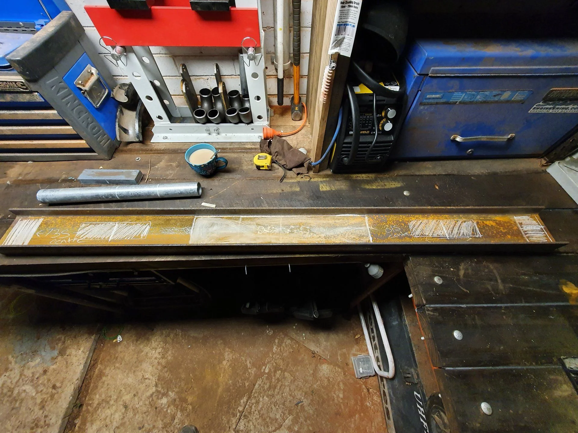

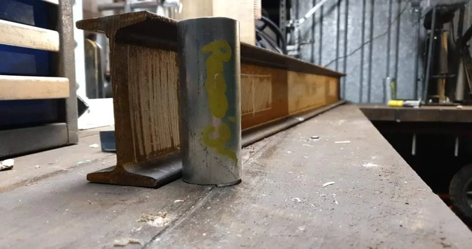

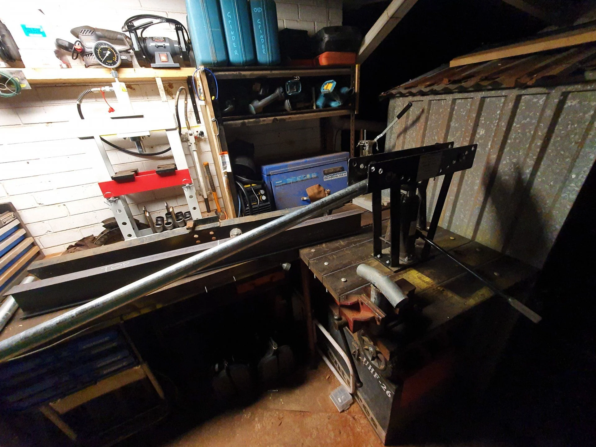

Ill be giving welding a shot with a Rear Bar and Sliders. 6mm I Beam, 40x40 SHS and 40nb Tube (3.2mm Wall Thickness)
Cut down to 2000mm lengths.

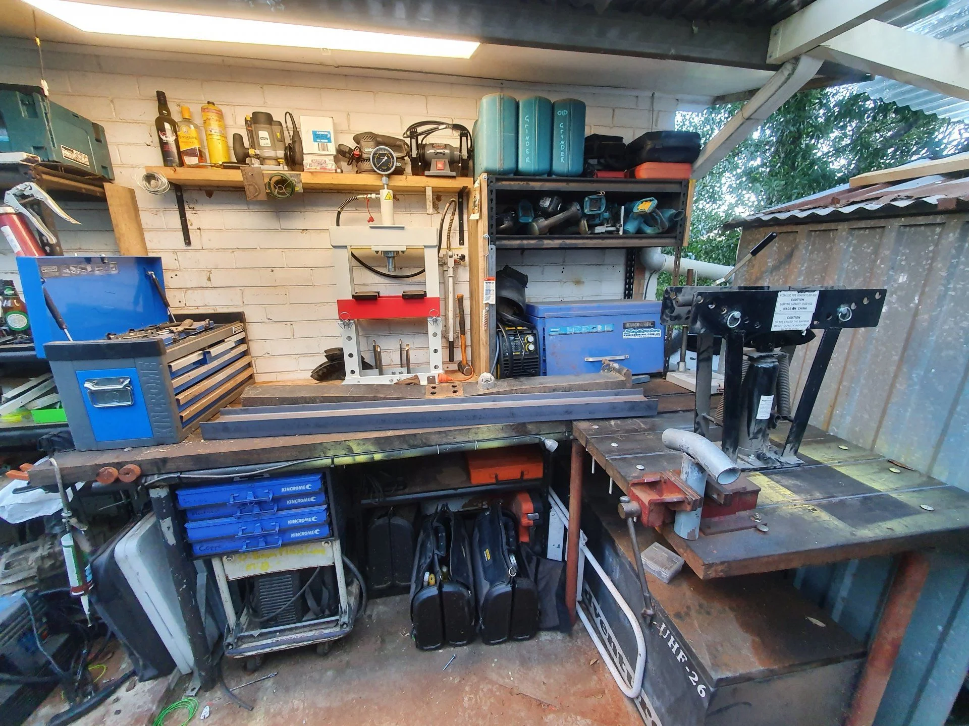

Also borrowed a tube bender from my dad. Hidden deep in the shed behind the boomerang and woomeras.

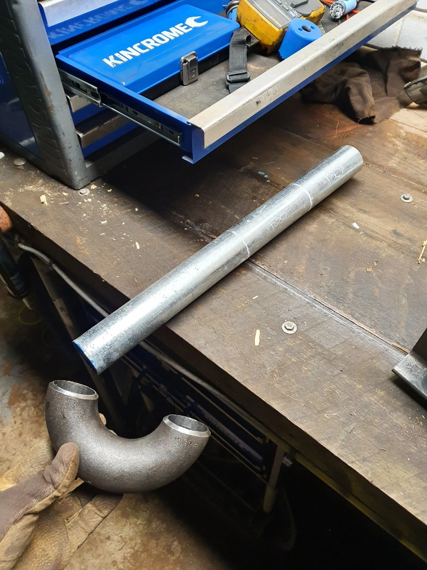

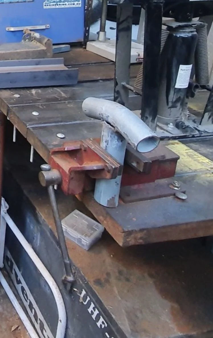

And found these 40nb 180* bends ready to be welded.
Making a start on the bar design.
1600mm x 125mm
Twin tyre holders made from 40nb steel tube.

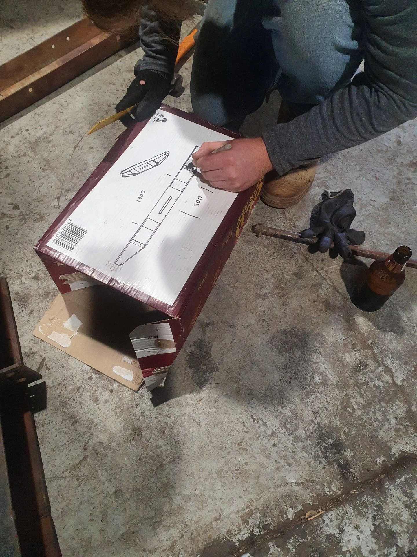

Works started on the rear bar using an Old version of CAD (Cardboard Assisted Design). However I didn't like what I had and will leave it for another day.
'Rolling on the river.
Ambulance doors are so versitile.
Beercartondesigns pty ltd.

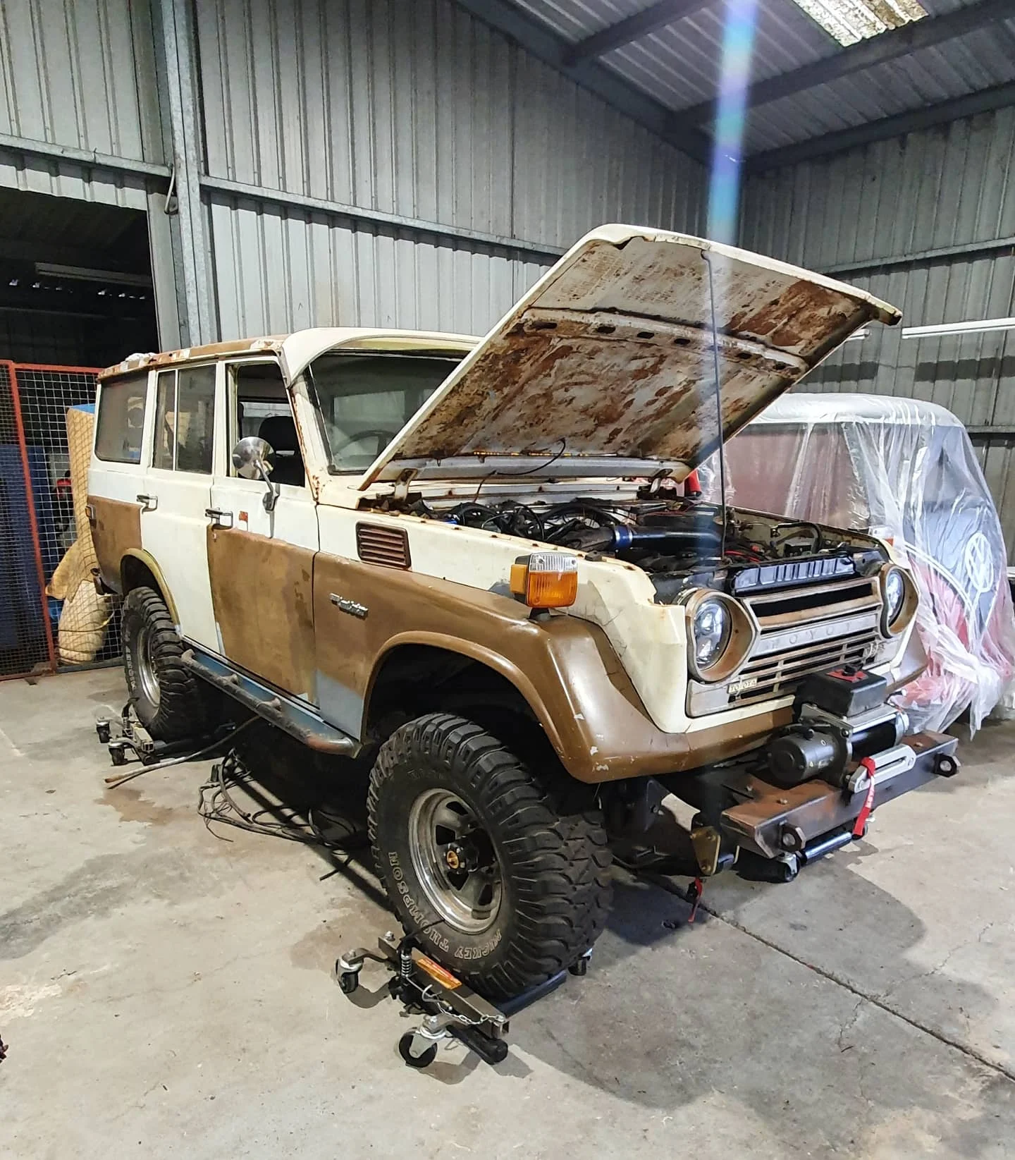

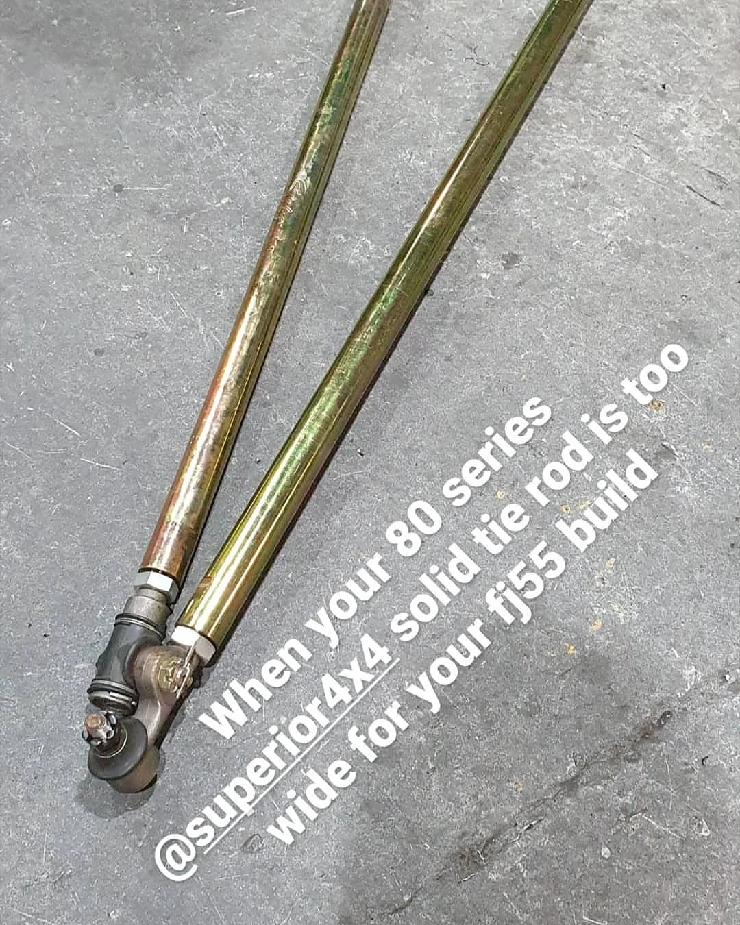

Steering arms installed and steering dampner.
Found the rear heater pipework leaking. Easy solution - now I don't have a rear heater.
Here's me practising my well trained form of Bikepig Yoga.

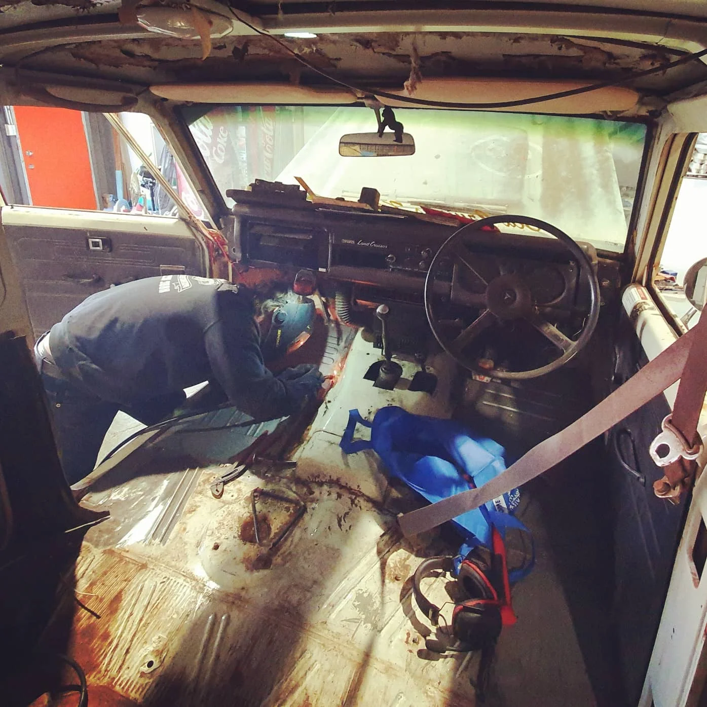

Also made good progress on the floor pans however found more rust.
And like a long mullet haircut, buisness at the front & party at the back.
