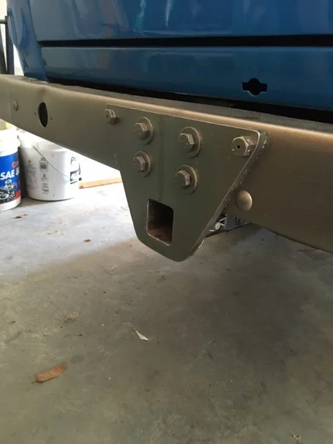

I've got a similar configuration with a 2" receiver through the center of my crossmember but not attached. It has kick outs to the frame rails at both ends, and angles down under my 55gal main tank. I'll shoot you some pics this weekend -

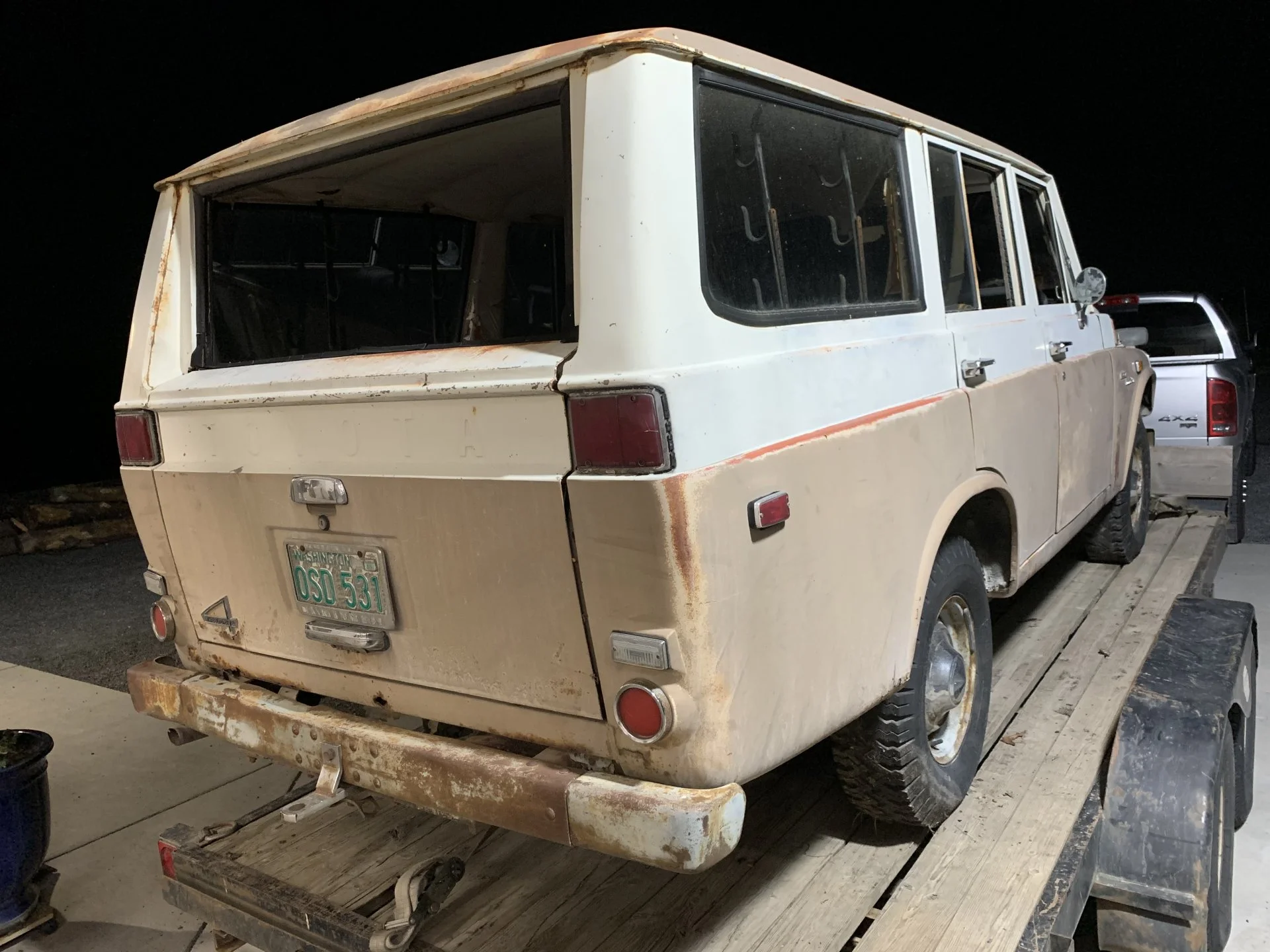

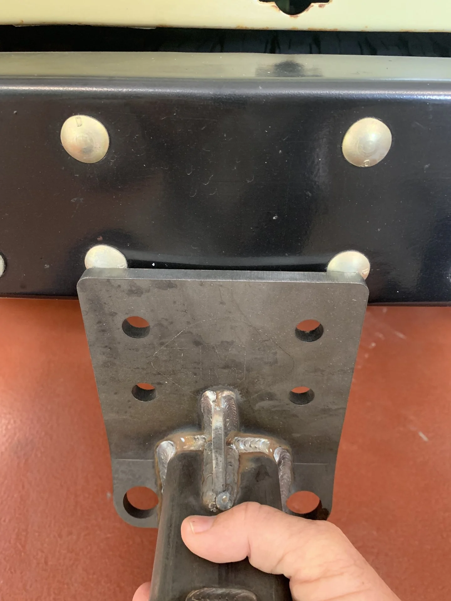

Bringing this old topic back up. I tried adding a standard rear bumper /frame loop 4 bolt receiver to my truck and found out that there is different bolt patterns. I’d like a class 3 but the bumper one would do. Any one have any other Curt brand or the like hitches on their trucks that fit with stock tank and spare?

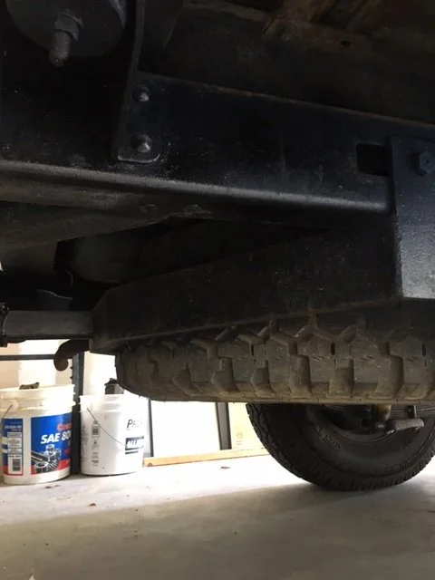

This is what someone built on mine. It doesn't look too difficult to build but is looks way heavy. The rear plate is 3/8" and is attached to a "Y" that goes forward but around back side of spare tire and bolted to outer frame rail. I wanted to fill the hole in the bumper where an old 6-pin recepticle was but I was afraid to weld on the bumper that close to the gas tank. The hitch looked like too much work to remove- a bang for the buck type of thing.
I'm OK leaving the hitch on even though the pig will never tow (not allowed in MS with antique plate) or rockcrawl. I figure I'll it'll come in handy someday at a stop light with a drunk driver behind me. Trail armor, not for this one, traffic armor, yes please.
The bolt pattern on the 55 bumper is the same as all other Land Cruisers up to and including the 300 series - standard NATO 3 3/8" x 1 3/4" bolt pattern. This looks like it would work nicely even without a pintle if you have to have a drop receiver:

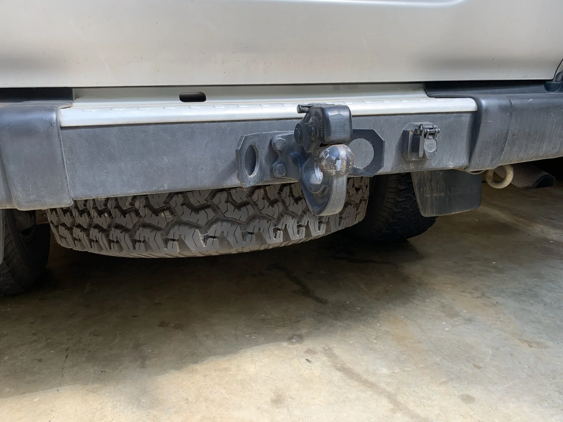

I put a ball pintle made by Holland on my 80 series. It has worked extremely well over the years.
http://products.safholland.us/sites...products/pintle-hooks-medium//bh-200rn41.aspx
I mounted it with a chain plate behind it.

That’s what one would assume but apparently a South American 55 had different opinions of a “std hitch bolt pattern”. You can see on my post the @65swb45 supplied receiver sitting up against my bumper and another anomaly shows up. Really wanted to bolt on and be done. Apparently I’m making one from scratch.
Very odd. They must have made quite a bit of that 55 in SA.

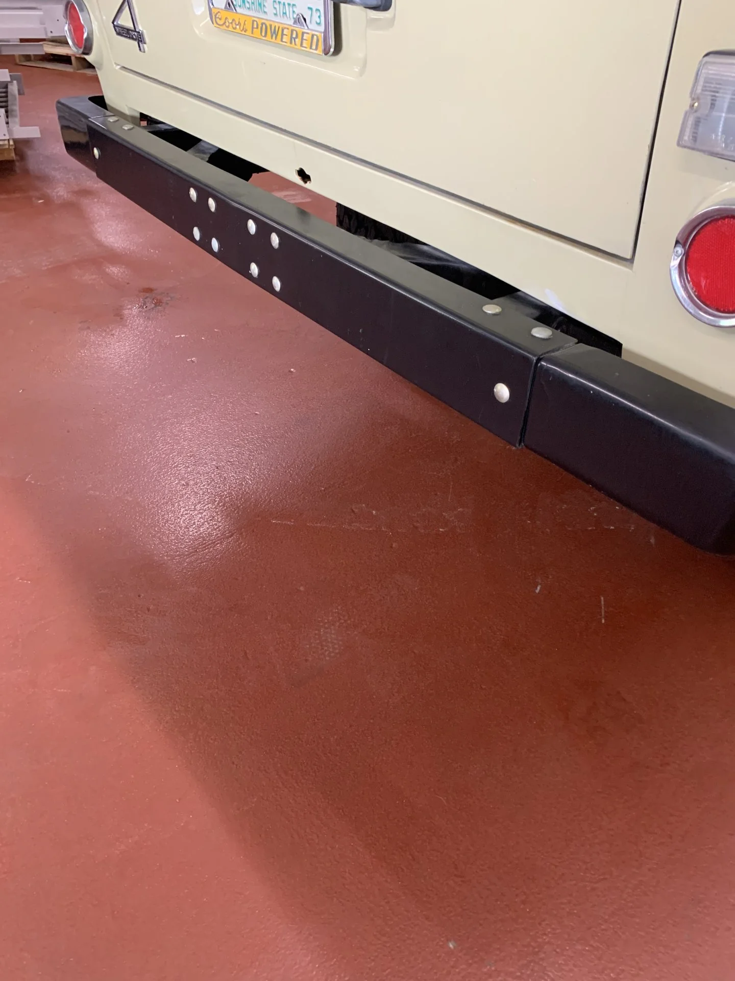

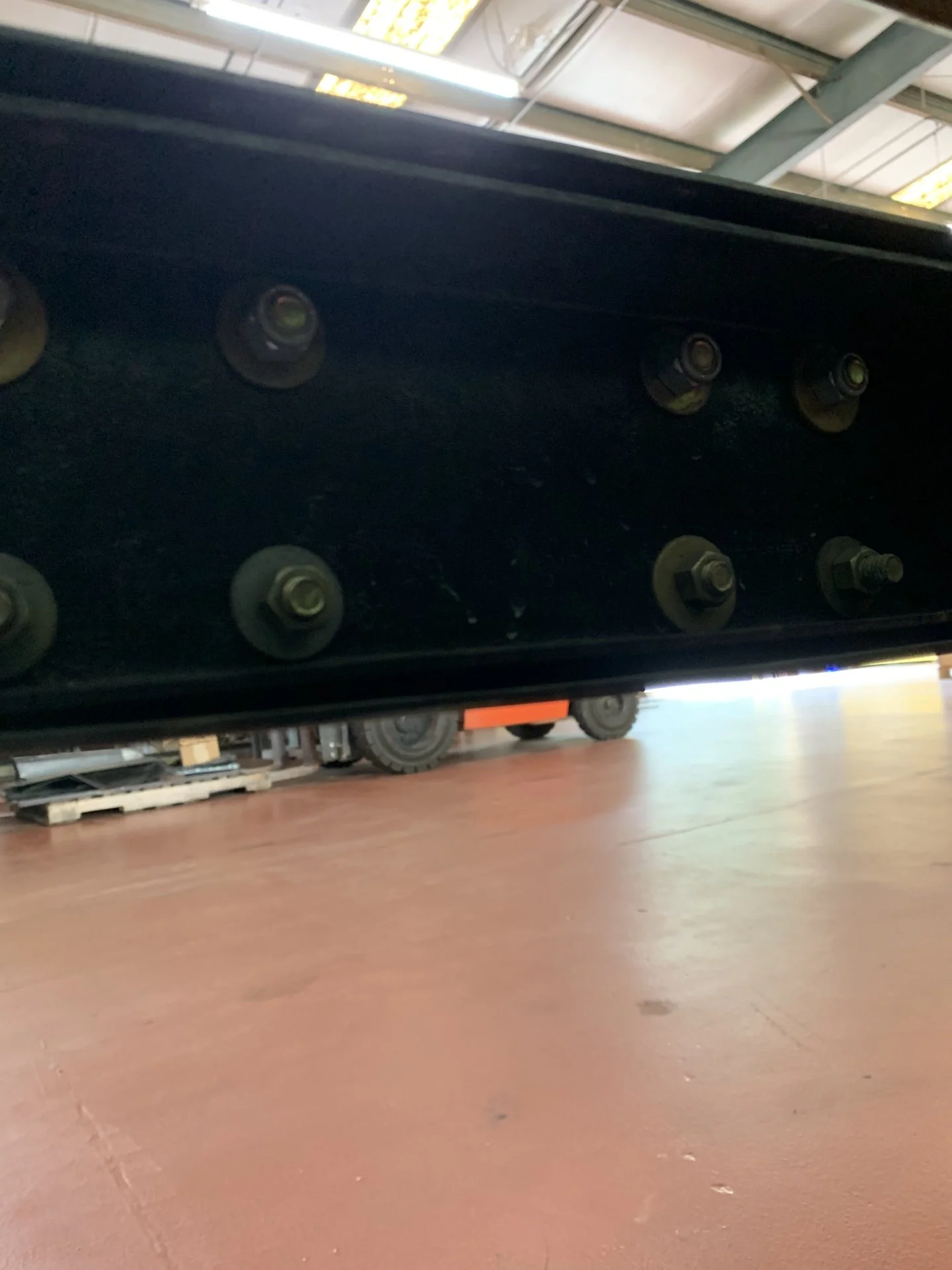

I fitted a rear bumper off a 69 FJ55 to my 79, two different patterns on the 4 center bolts…..I drilled the crossmember to match the 69 bumper.
Was one a South American 55? I ask because the parts diagrams show the same pintle hitch for all years.

I have no idea on country of origin…..the donor truck is long gone…..my 79 is here…..I could measure the pattern…..
