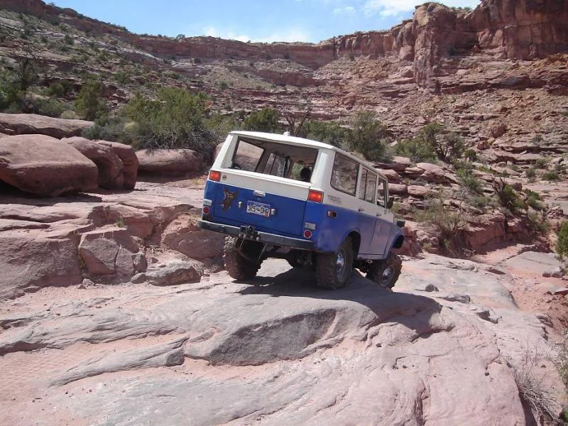

here's the popup i took to moab in 08, where i found the frame would twist. i had a receiver bolted to the frame. the camper was rated just under 2000 pounds. you can see the receiver in the pic of me wheeling. i had it mounted upside down for better clearance.
here's the popup i took to moab in 08, where i found the frame would twist. i had a receiver bolted to the frame. the camper was rated just under 1800 pounds. you can see the receiver in the pic of me wheeling. i had it mounted upside down for better clearance. the pig did great pulling it on the flat, but as soon as i hit any hill, it sucked. i was going over the passes and out of georgetown in 2low
