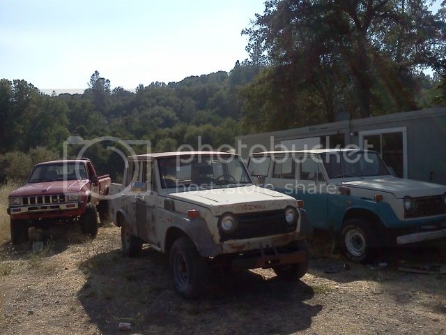

I have a feeling I'm going to dump a lot of money into a REALLY ugly truck. :)

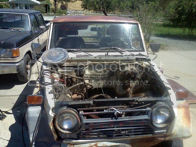

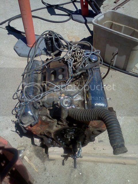

Picked up the motor today. So purdy all freshly rebuilt. I almost feel bad putting such a nice new pretty motor into such a beat up rusting truck... it should go into a nice old car but too bad for it I'm more into 4x4s then classic cars. Also picked up two new mufflers today. The old exhaust is gone... totally rusted away. Sounds like our plans for tomorrow might not happen and I'm actually kinda OK with spending the day putting the motor together and getting it all ready to go back in.

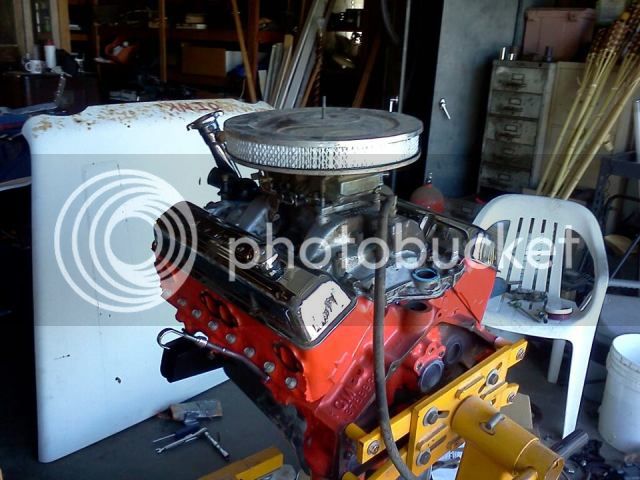

Got the new 283 almost ready to go in. My dad was laughing at me for not cleaning up the intake better but it's going in a 4x4 not a show car.. it's just going to get dirty again if I make it look nice. ha ha. Going to pick up a new water pump and starter today, clean up the headers, get the distributer in and then hopfully tomorrow get it in the truck and get everything back together.

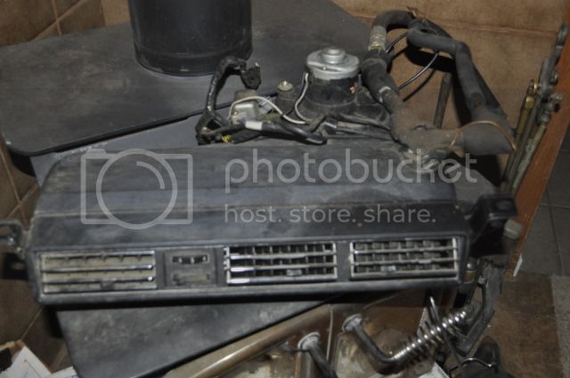

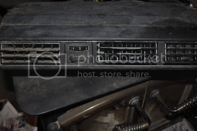

Got this from a friend for the Blue cruiser. He got it out of a Hilux at a junkyard for his Hilux and then got rid of the truck and kept the AC for a few years. He brought it over to be a few days ago and I'm stoked. This will look really nice in the blue pig and although I wanted to keep it 100% stock... this fits the look of the dash enough I don't think it's going to ruin the stockness for me too much. Plus it was like 107 yesterday and today...

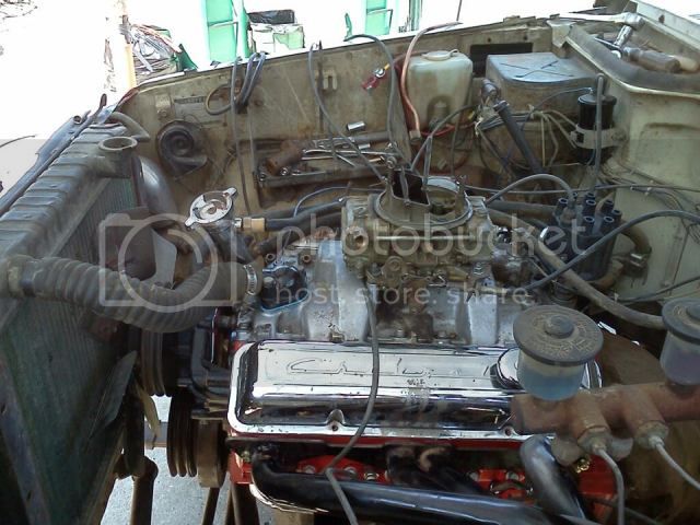

Well, I've been busy and distracted and just finally got back to working on the Bucket last weekend. Got everything in, hooked up, ready to go. Wouldn't fire. Had fuel and spark and wouldn't fire. Then I got sick and finally got over today to mess with it. Pulled a spark plug and found the pistons were hitting them! Smashed them so they couldn't spark.. thank God none of them broke, just bent. The plugs in the old motor were like a month old so I just used them... but this motor had differant heads.. opps. Replaced them with the correct ones and it started shooting flames out the carb but still not starting.. I rechecked the distubutor and it was 180 as I thought it might be... flipped it around and it started up almost right away. Sounded awesome with the open headers! Ha ha.
Wierd thing happened though... the Automatic transmission started POURING fluid out the dipstick when I reved it up a little... I have NO idea what that was about. It's a TH400... I disconected the vacaum line to the trans and it stopped doing it... but I don't really know why or what happened... any ideas? The vac lines tell the trans when to shift right? Sooo... I can't just leave it off... I'm retarded about auto transmissions. Nothing changed.. the trans work perfect when I parked it and swapped the motor.. and it's the same motor that came out, chevy 283.
looking good, the a/c is cool.. :grinpimp:.. if you have a freind in the a/c business they can help you redo it since its going to be a r12 system you are going to need to find some r12 replacement, as the 134 lowers the system efficency about 20%, all the 134 systems run larger condensors and evaporators.. 134 in a r12 system sucks ... especially in a pig, alot to cool off...
good luck
Ray
Sweeet! Finally got it all together today. What ever was going on with the trans puking yesterday didn't happen today... so I don't know and don't really care as long it it doesn't happen again.
Stupid headers are leaking, so I've got to pull them off and retighten them again and see if I can't get them better. I forgot to bring zip ties to get the plug wires off the headers... they are tied up with weedeater line right now. Need adjust the valves, and just clean up the engine bay a little but I'm pretty much there. I was going to drive it home today, but figured I have to finish welding and cutting the back so it's just going to go back to my parents house Monday anyway, might as well leave it.
The motor was a bit weak. It was just flat.. stumbled off idle and just didn't make the power I expected... not even close. I have a few ideas... the only fuel I had there was avgas I had left over from Sand Mt in June... I noticed while putting it in it didnt's smell like avgas anymore. I'm kinda hoping it was just stale and that's a big chunk of the problem. Also, when I was messing with the timing, the coil wire shocked the hell out of me... so I need to replace that.. those two things could be a lot of the problems.
However, it does run and drive and is perfectly drivable again. The motor sounds awesome and once warmed up idled and sounded awesome. After the off idle stumble it picks up and moves pretty nice. Best part... after a 10 minute drive and returned home and parked it... NO LEAKS!!! I think that's a first for me to have an engine swap have nothing at all leak after the first test drive.

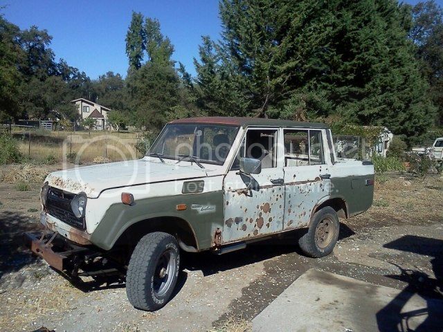

Also, did a test painting to see if I liked the OD green. I love it. Tomorrow and monday I think I'm going to go ahead and sand and paint it. OD green where the grey is/was and flat black where it's white. Should look pretty sweet. Going to make vinal stickers in red for the raised TOYOTA on the back. Funny how the ugly POS truck actually made me love it and want to keep it alive. :)

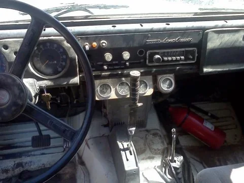

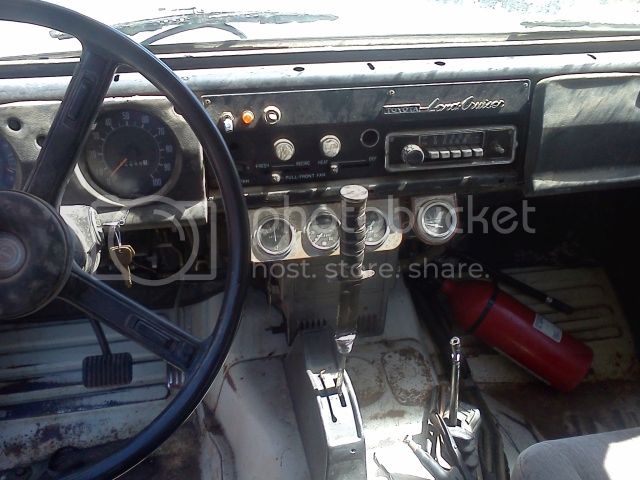

I also made this for fun. I had a old bent 1980's army fighting knife (army Kbar) and it was pretty messed up as a knife so I made it into a shift knob. And yeah, I took a grinder to the edge so it's nice and dull and I'm going going to slice myself open trying to shift gears. :)It works great and it's tall so I don't have to lean down to shift gears anymore.
Love it!!!
-Daniel
You need an old Swiss army knife for the T/case shifter...
