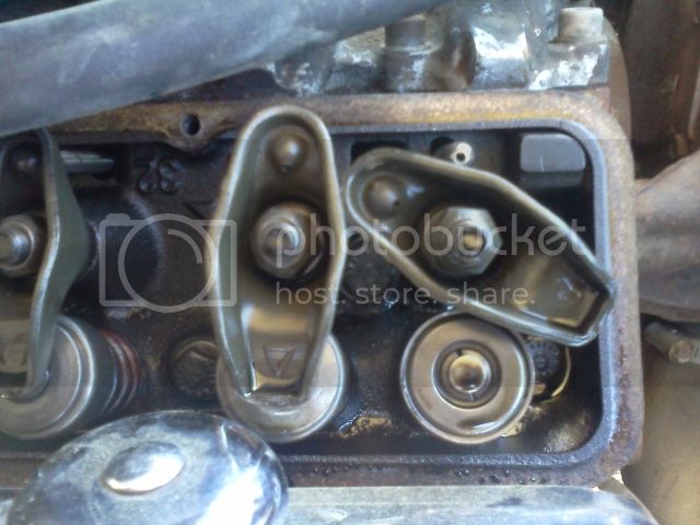

I pulled off the valve covers thinking maybe I had a stuck intake valve (it had been sitting for a LONG time before I got it). No stuck valves, but this:
The nut is adjusted all the way down to the bottom of the threads. The cam/pushrods are just worn out I guess. :( Wierd though... the motor WAS running better then it is now and I don't see this being a all a sudden kinda thing. THis almost has to be the cause of the backfire though. I had it running and was watching it and the exhaust valve isn't opening as nearly as much as it's brothers. :/ Bummer.

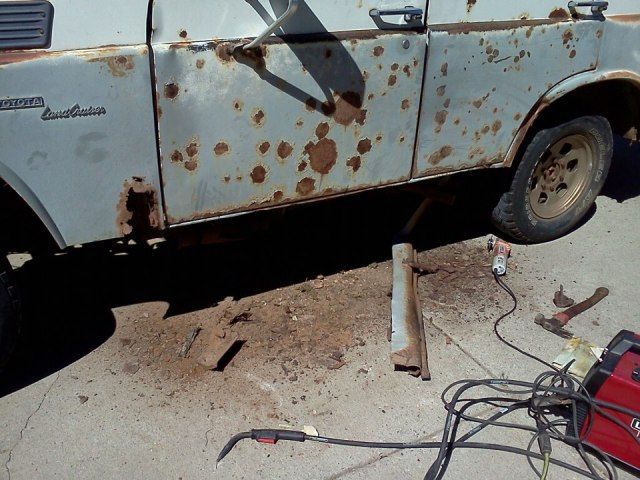

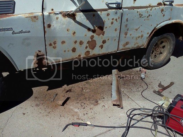

Cut off the rocker panels today. This was the "good" side. The other side I'm not sure I even needed the cutoff wheel... I probally could have kicked it off. The floors are actually solid though which is wierd.
What do the body mounts look like, under there. I am always amased at how much " stuff " comes out of the rockers.

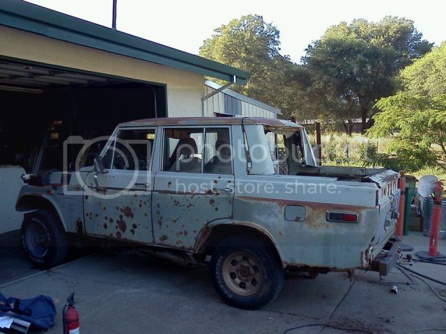

:) I love it. The plan is to actually put the window back in working again if I can make it happen. If not, I'll use the thickness of the back section there and make a little gun rack or tool box behind the back seat.

Yeah, I've seen some neat ones here too which inspired me to start cutting. I wouldn't have done it if I didn't have a nice one too. This one is so ugly I didn't feel bad about chopping up a semi rare truck.

Check to see if the valve rocker stud has pulled up from the cyl head. I've had a few of the press in studs pull up when adjusting valve lash. Tell tale sign is having the nut adjusted all the way down. If thats the case, you can fix it by installing a screw in stud.
Good call , you can also take the push rod and try pushing down it should have a spring action to it to rule out a collapsed lifter. I sure you have pulled out the push rod to see if it is bent already . I have seen a few bent ones before do to a over rev.
Yeah, pushrod wans't bent. I will check to see if it pulled up tomorrow once I get back to the truck. I left it at my parent's house this weekend. The timing chain replacement did not go so well... I can't the the crank gear removed to save my life.

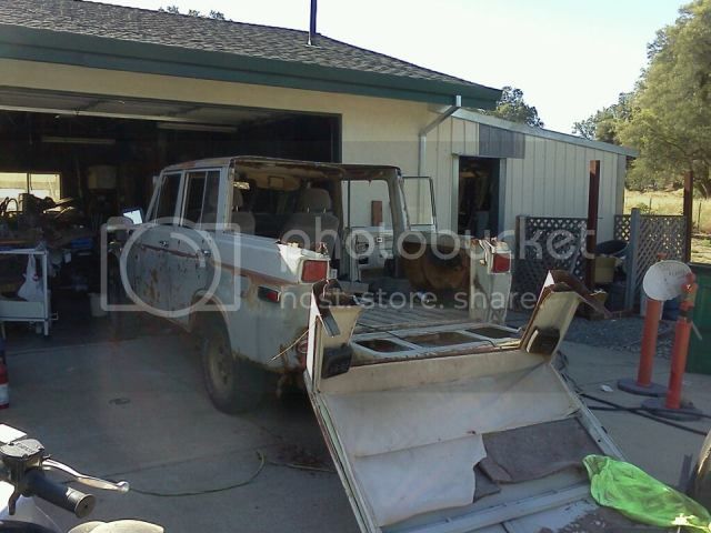

Started pulling taking apart the motor in the blue cruiser today. Got it almost ready to pull out. Took off all the parts I'll be using for the new motor going in it. Intake, carb, exhuast, alt brackets, fuel pump, ect. Wierd thing is.. the guy I bought it from said that motor had put a rod through the block.. I saw an oil covered spot on the side of the moter under the intake and exhaust and that's where said the hole was.. when I got the intake and headers off there was no hole. No damage at all that I can see. I almost am wondering if the motor isn't bad after all. The guy I got it from never ran it, he was told it was blown up by who he bought it from. Who knows... but I will be tearing into this motor a little more once I get the new one in. Maybe I have an OK motor here after all.
Started working up some brackets to make this happen... :) It's going to be neat. Also got about HALF the body work down to reattach the back of the top. It's welded on, but not pretty yet. I don't expect it to be totally seamless, but look good enough.
