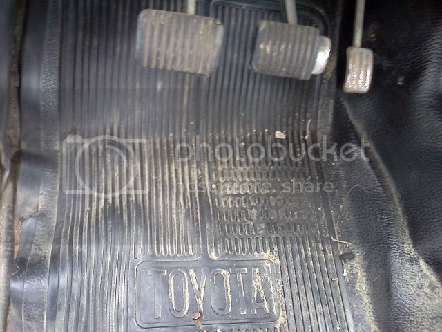

I got the carpet and foam crap out of the blue beast and found that there are original rubber mats down there for all of the truck. It is cut or ripped across the transmission hump but not that big a deal. Very excited about how much stuff isn't missing. I thought I was missing a ash tray from one of the doors but found it under the seat. :)

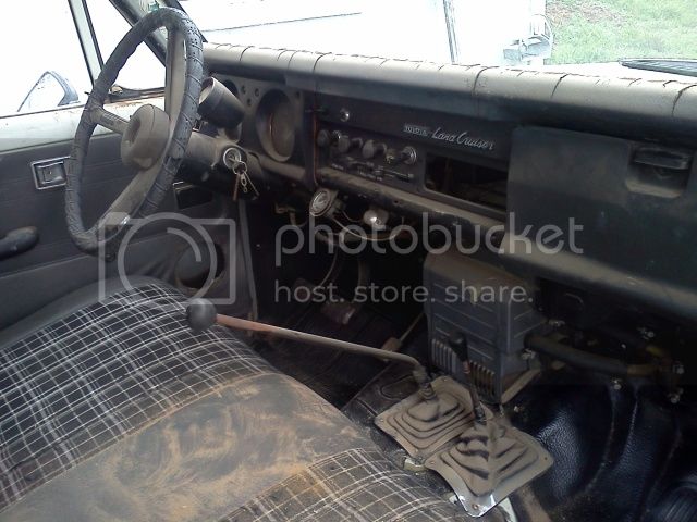

OK... couple of questions. I'm having a hard time finding any good pictures of the inside of pigs how they are original/restored. Trying to figure out what the things look like from the factory inside. Anyone have any good pictures they can share?
Also, the orange I keep seeing pictures of... factroy color? What years? My GJ and I both really liked it when we saw it and my FJ40 is orange so we were thinking it would be fun to have the 55 orange too.
And... did the 55's never come with colum shifters like the 40's did?

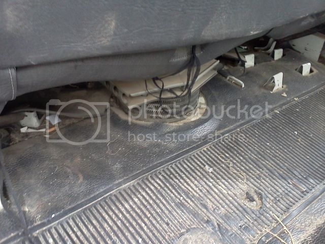

OK... couple of questions/requests. First... tools that go on the bottom of the rear seat. Can I get a picture of what goes there? Are any of them the same as the 40 tools? I have a lot of the tools that came with my 40.. don't have them in it anymore becuase I have the hilift and more tools then I have at home most of the time. I assume there one of those is the lug nut wrench, the spare tire crank?, jack handles? The jack looks like there was a spot on one of the inner fenders for that.... just trying to figure out what I need to have all the parts it came with.
And... what's up with what looks like 3 fuel lines? Two go into the engine bay, one is capped off and the other goes to the carb like I'd expect a fuel line to do. The third is on the driver side and seems to go into a fender? What the heck is going on? "Bucket" has a aftermarket fuel tank and a v8 so it wasn't any help.
Under the rear seat is where the big hand crank goes, the hand crank works for lowering the spare tire AND turning the engine over by hand. Also the jack handle extensions go under the rear seat. Traditionally, the bottle jack goes under the driver's seat.

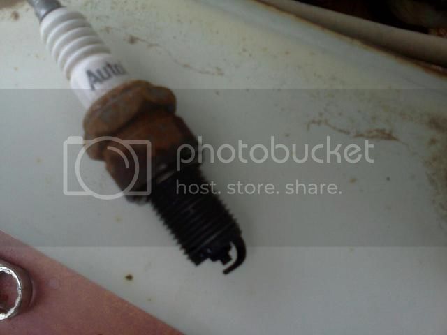

After we played with the rust bucket the other day I havne't been able to get it to start again. I kinda suspected fuel issues as it's been sitting for who knows how long and then we drove it around with only a gallon and a half in it I figured there was a very good chance I just got crap plugged up in the filter or fuel pump. Pulled off all the fuel lines today and everything seemed OK so put it together and tried to start it. I was for sure getting fuel to the carb. Still wouldn't start. Coughed and sputtered like it kinda wanted to, but won't start.
It started raining so I was about to give up and just for the heck of it I pulled a spark plug out... I'm amazed it started at all as fouled as the plugs were! Tomorrow I'll go get some new plugs and wires and I bet anything it starts right up.
Sorry for the bad cell phone picture.. but you get the idea. Pretty black and gunky.
Replaced the plus and wires today, beast started right up and ran nice. Took it for a little test drive... and ran out of fuel 400ft from my house. Nieghbor towed me home with is tractor just as my GF got home and got to have a good laugh. At least I know it starts and runs and seems to work pretty good overall. Engine bay and motor cleaned up pretty nice too.
