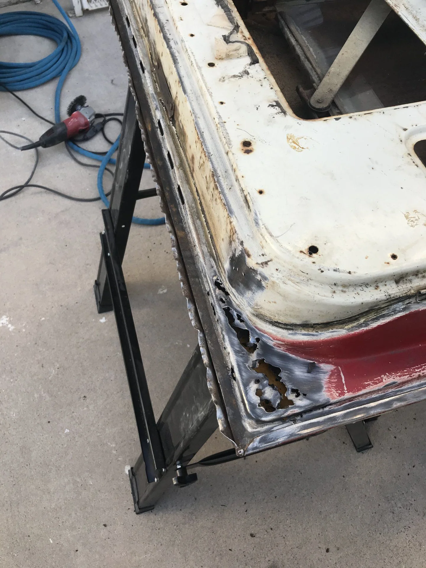

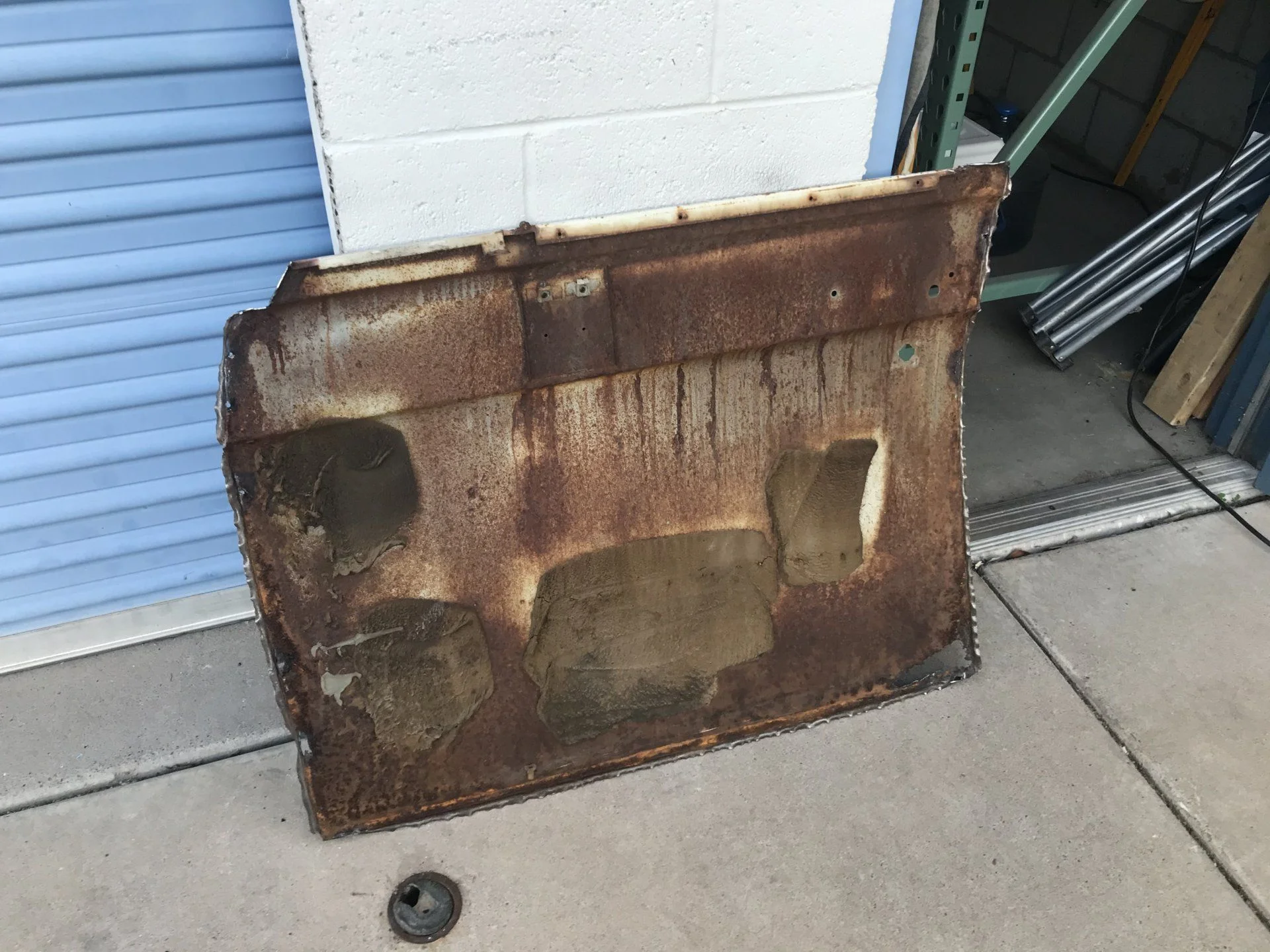

Has anyone re-skinned the doors on their FJ55?
Looking for tips or a thread that may discuss the best way to do it.
I am assuming I can just pickup some sheet steel, run it through a slip roll and weld it on. Looking for advise as to whether I should attempt to roll the edges, etc...

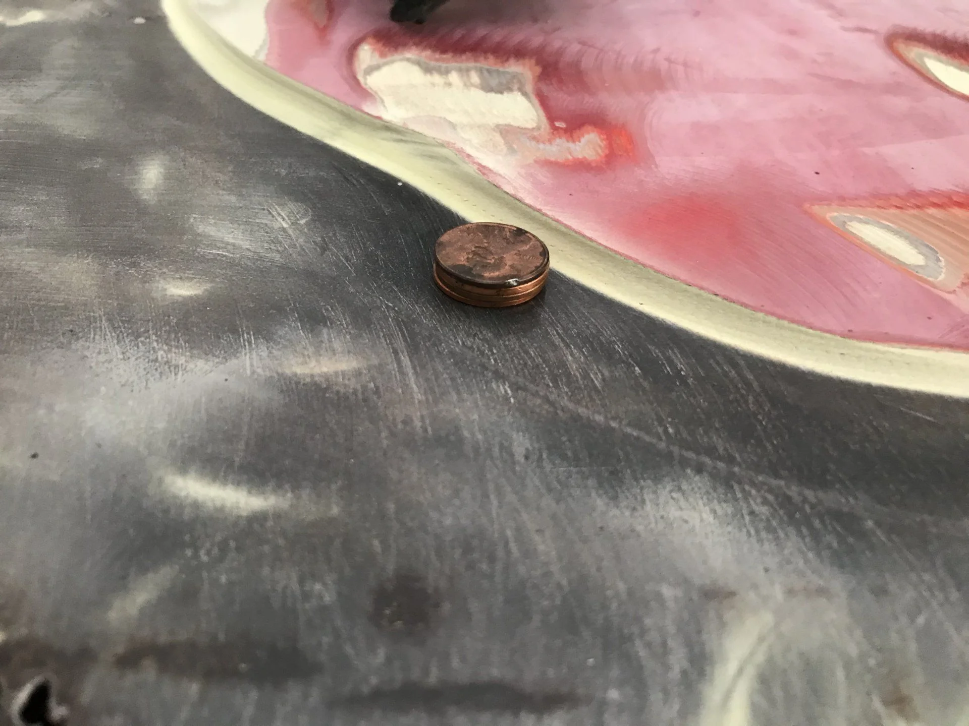

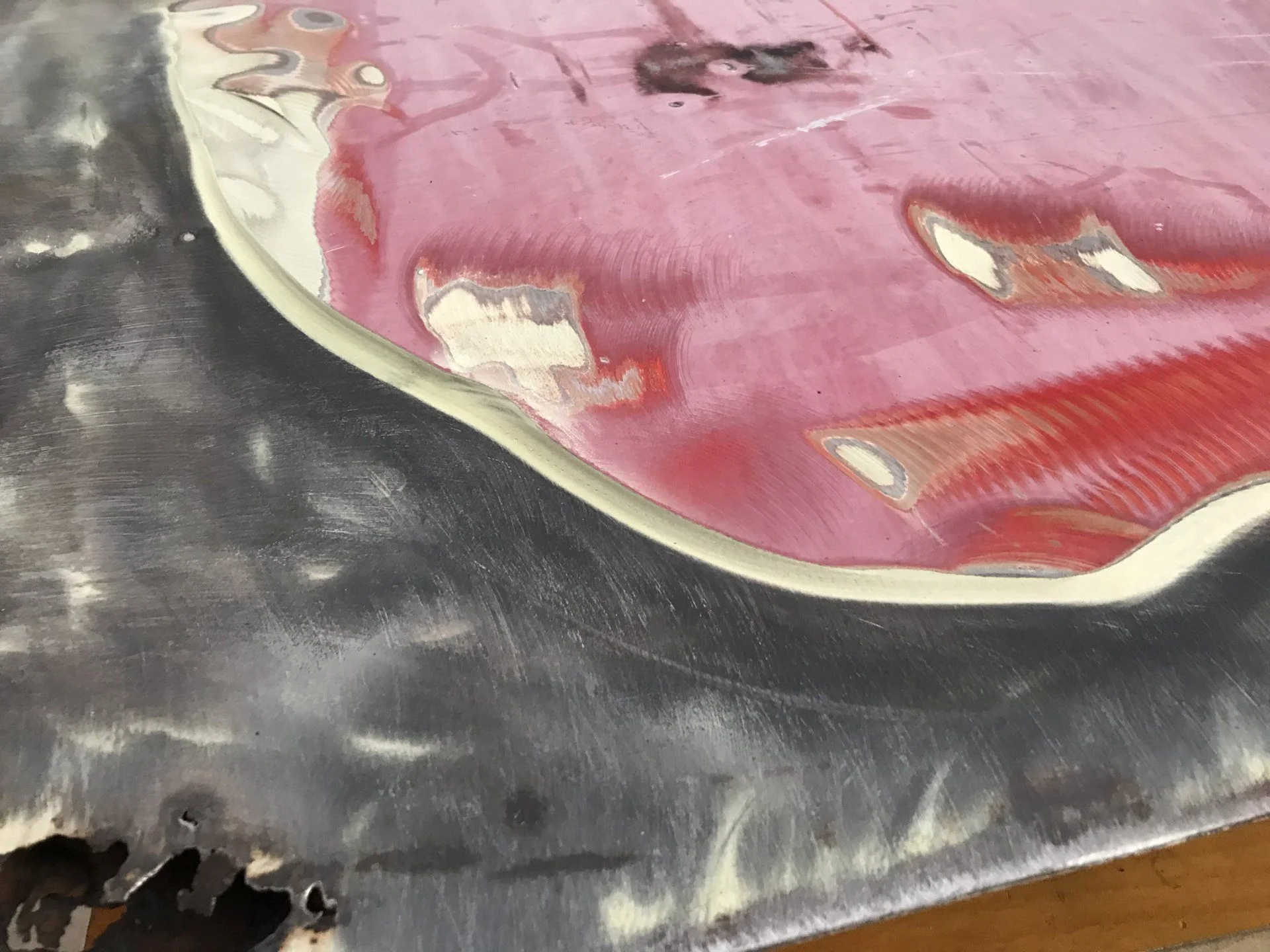

Looks like all 4 doors on my pig came with 1/2” of Bondo on them, covering a fair amount of accident damage, broken hinge limits, etc...

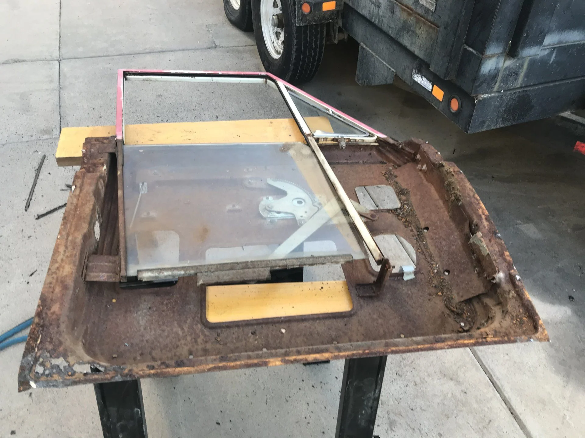

Wow! That is thick. I've seen guys replace the lower bottom of doors, but not the whole skin. I guess if a guy was willing to give it a go and had a roller, door is a goner anyway.

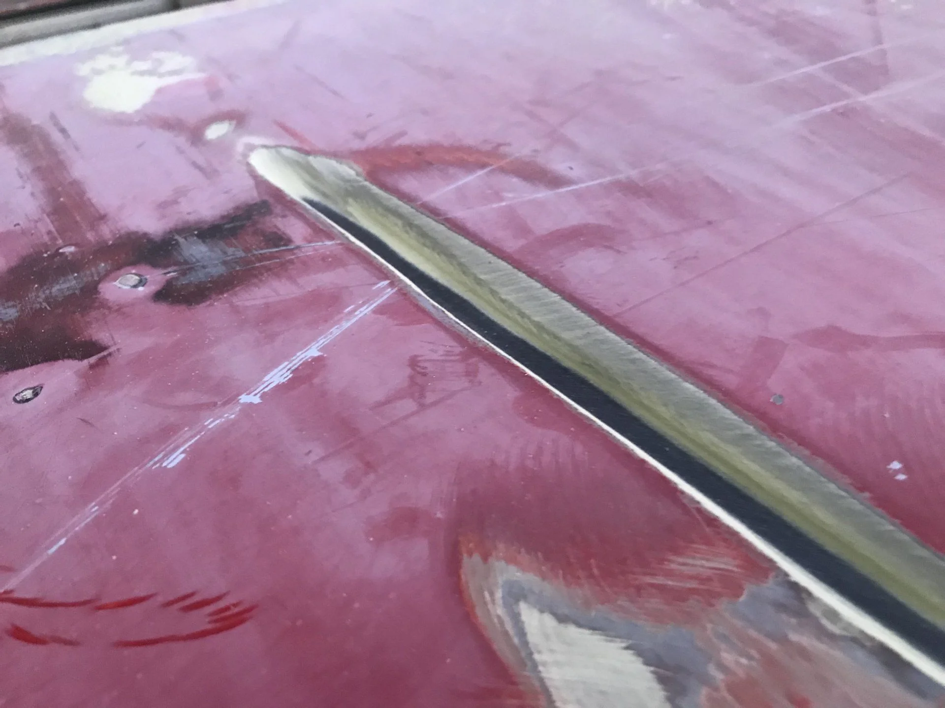

Others here may disagree, but the sheet metal on the doors are slightly concave. My opinion as to why there's so much bondo build up is that someone ran a straight edge from end to end on your doors, trying to make them as straight as possible. My doors were in pretty good shape when I took them down to bare metal with little to no filler from the factory. After running a straight edge on mine, I wasn't about to go through the hassle of building them up with filler.
Except for the rust in the corners, your doors might not be in that bad of shape. I'd experiment on that door and cut out the rust and weld in some patch panels where needed and lightly skim it with filler.

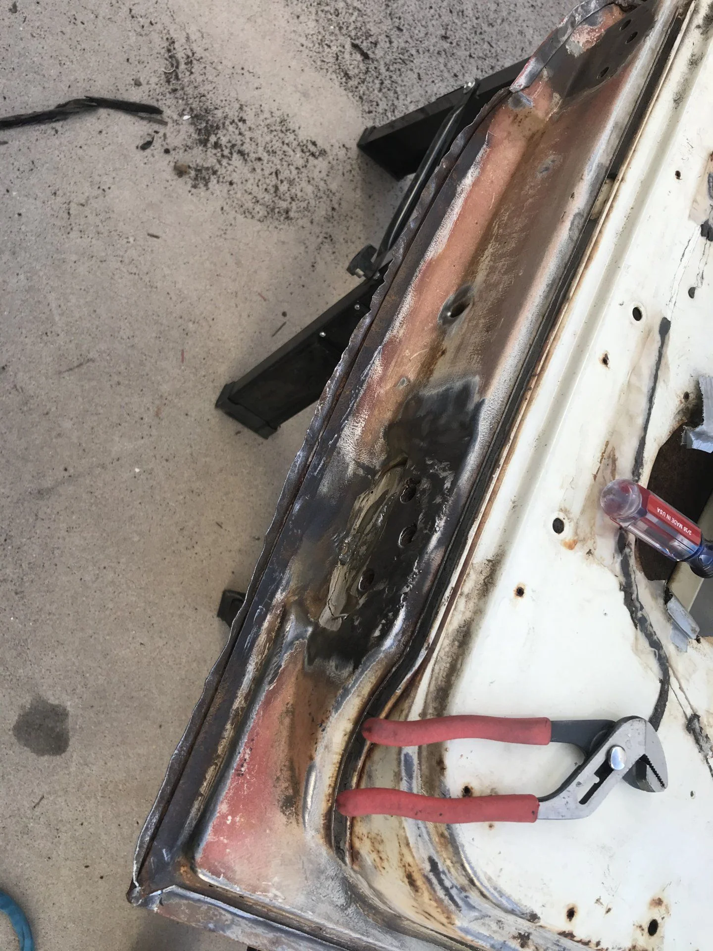

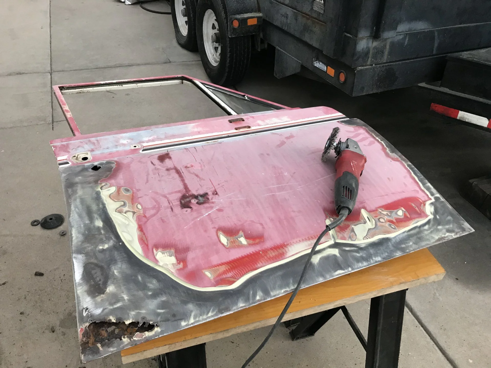

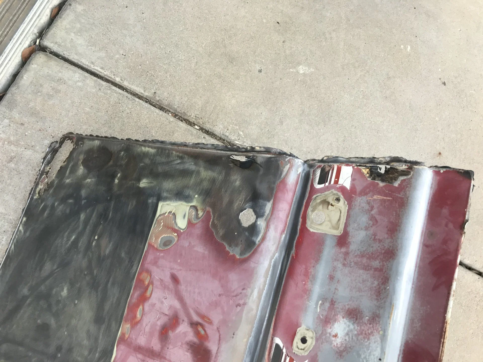

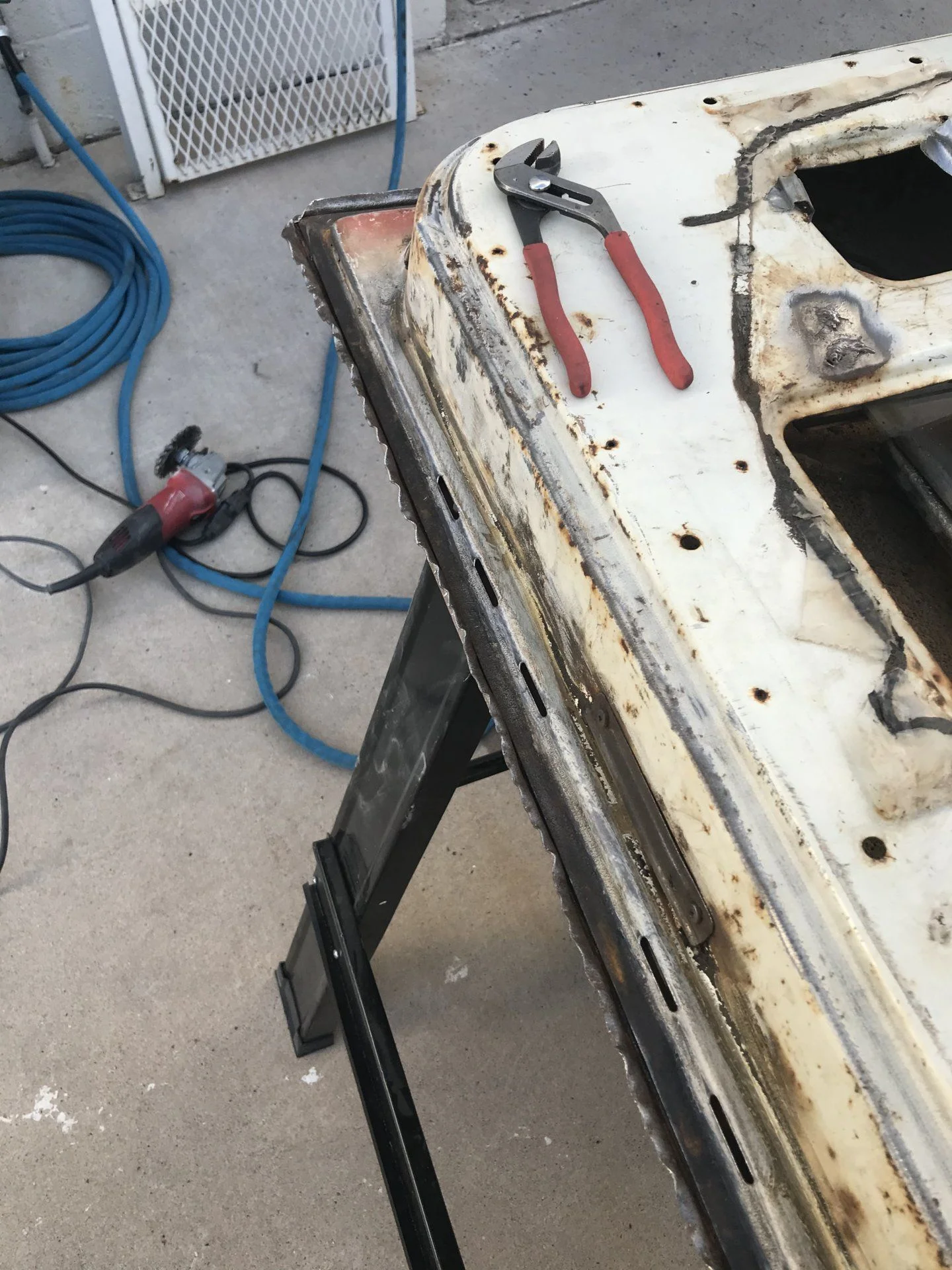

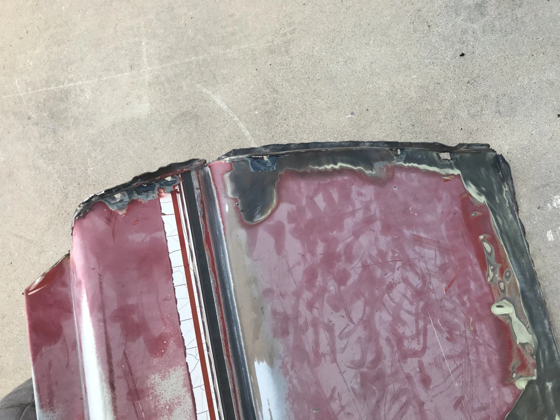

Thanks Bob. I had not noticed a hem on that edge so I will look for it tomorrow when I return to working on it. I noticed you cutting at the body line before and was curious why you chose to cut there. Now I know. Thanks for the advise. I was also able to get a slip roll on loan for a week or bouts so I am anxious to see what I am capable of. And I agree it doesn’t need to be :princess: just
Gawd dayum!! At that point you might as well try to build some skins if you have the means. Otherwise might be better to just track down another set of doors.
Either I enjoy the challenge of re-skinning or I have been watching too much of Bitchin Rides. Let’s find out...

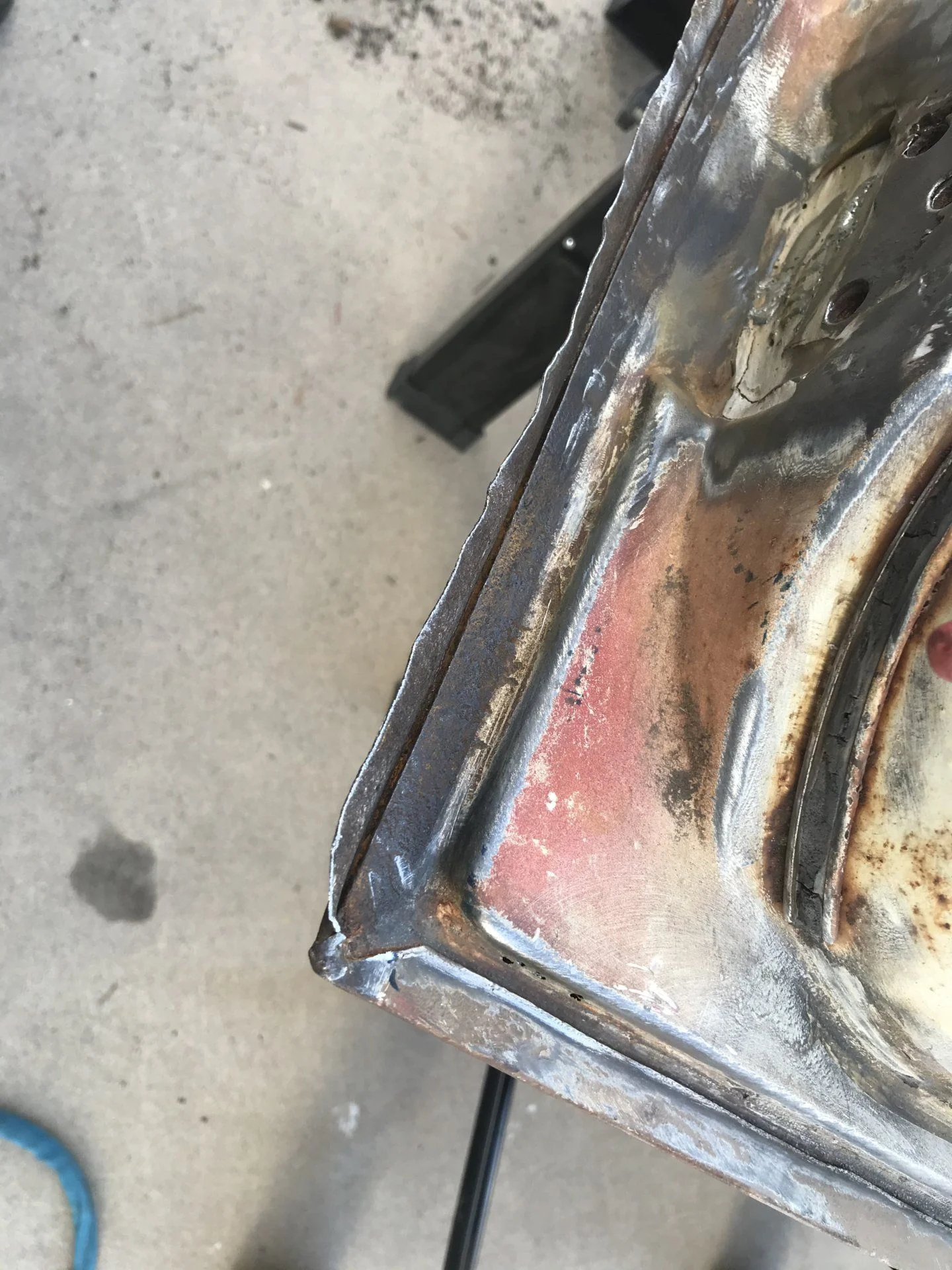

@bobm Would you add a flange and bend it around the edge (ie new door shell) or would you cut the old skin off 1/4” from the edge and butt weld it to the old flange?
