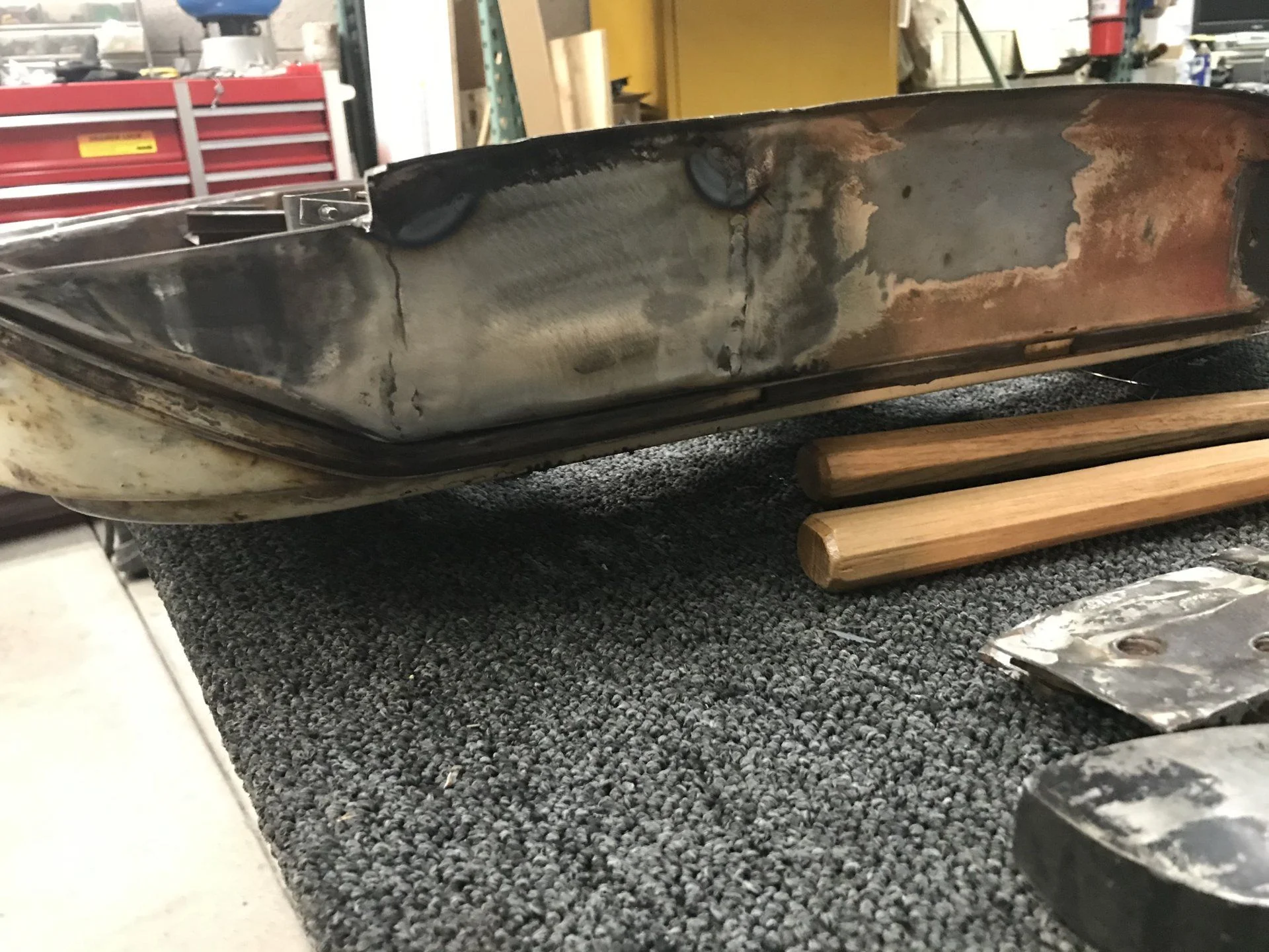

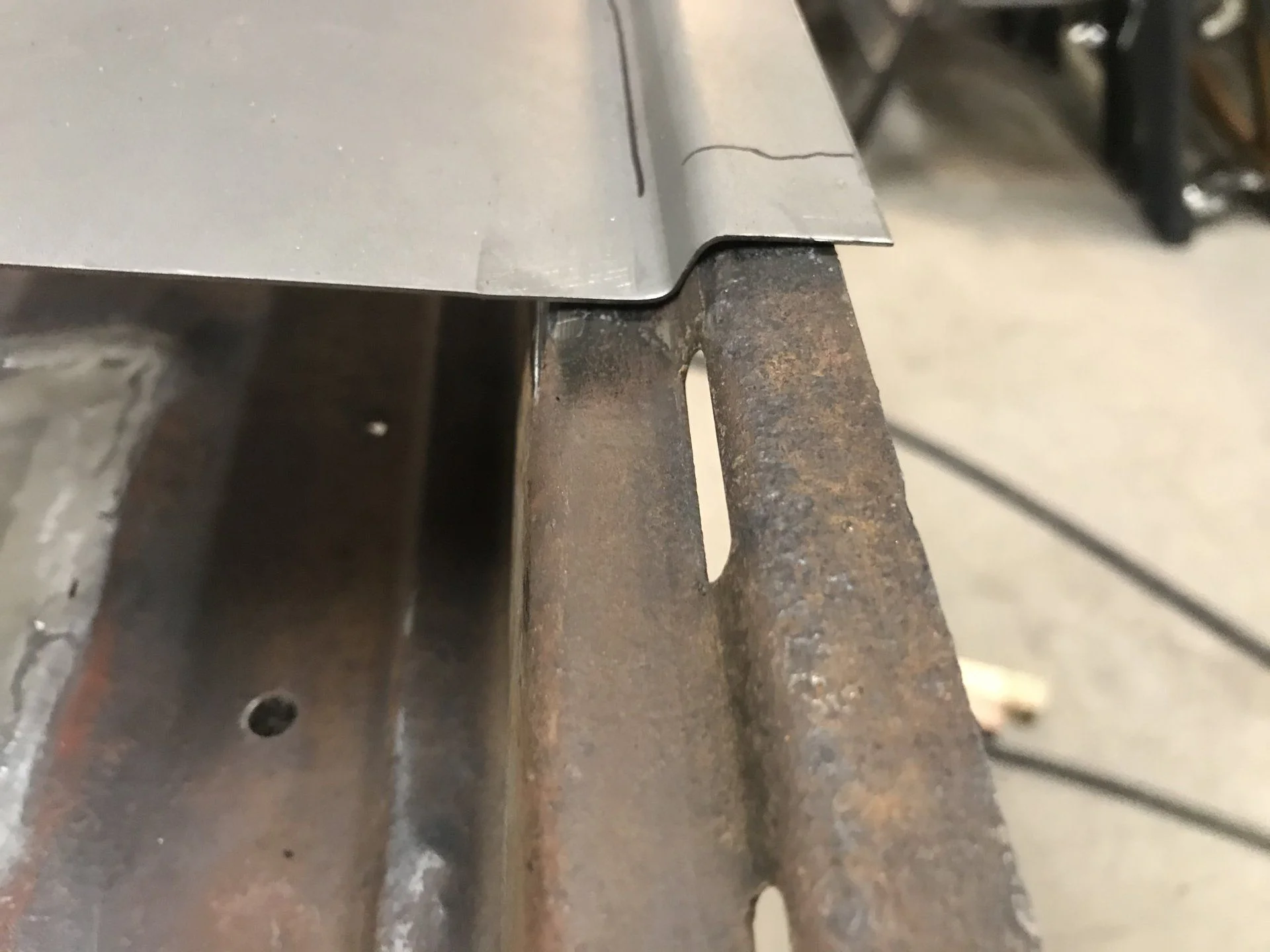

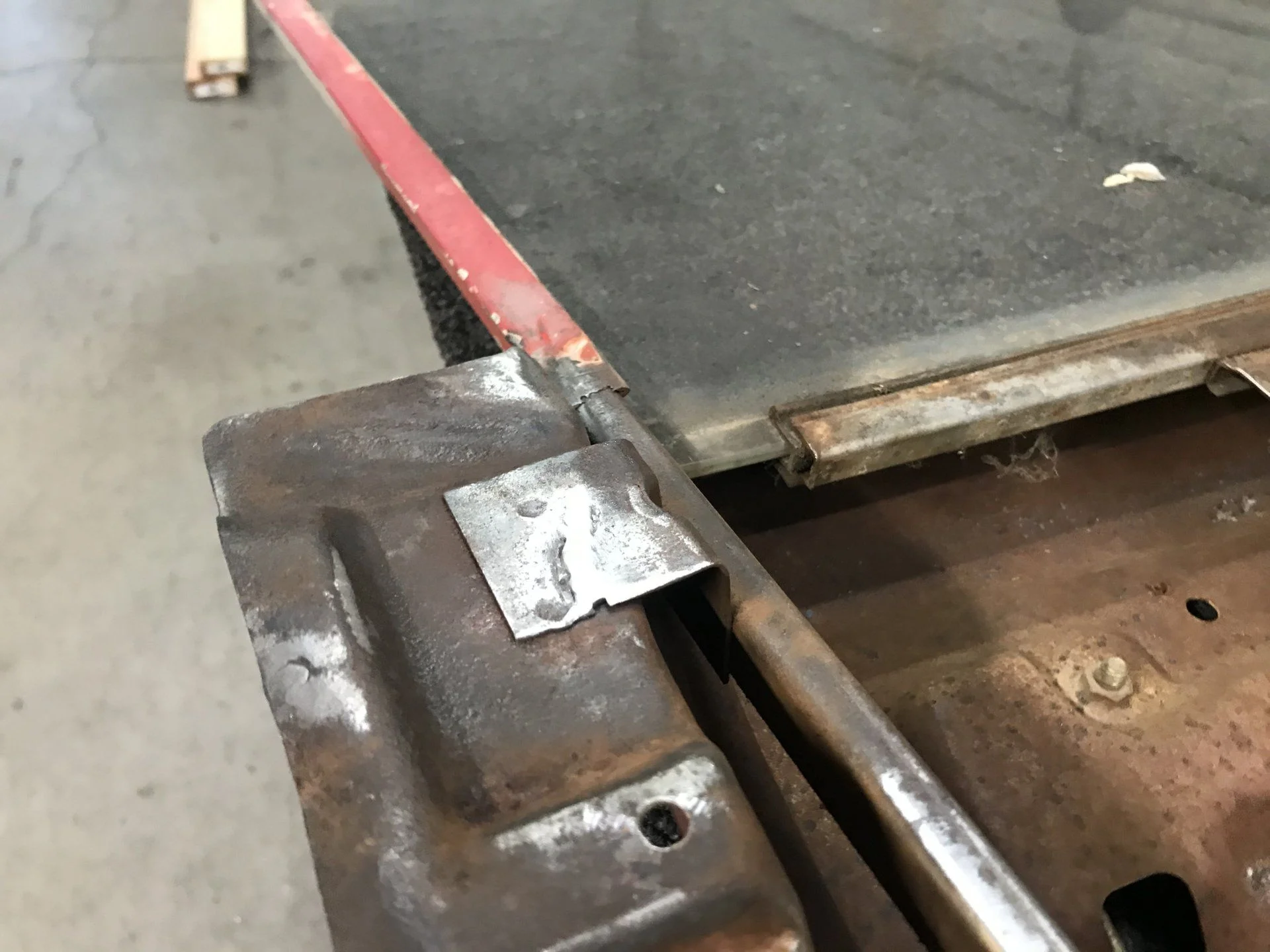

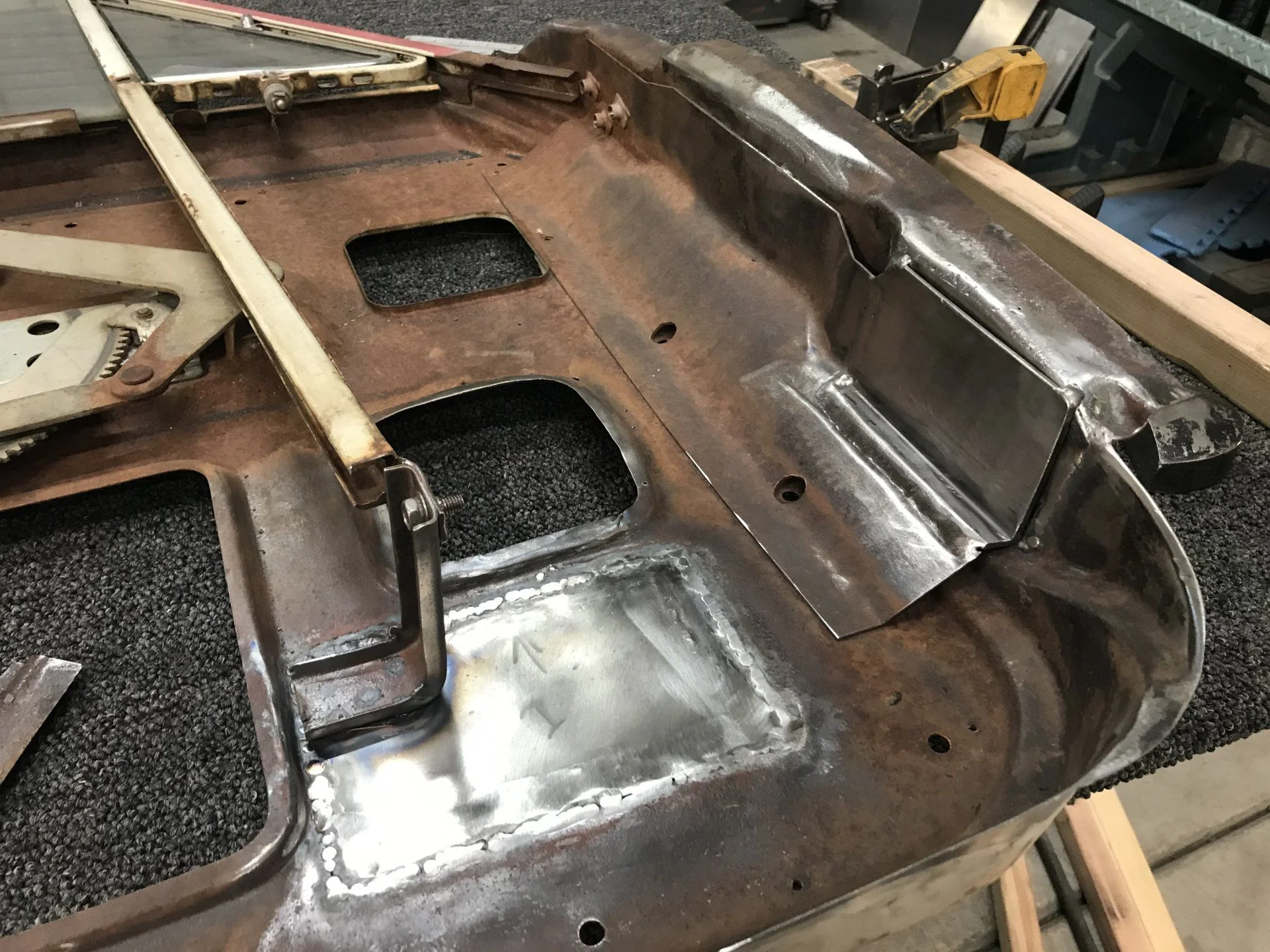

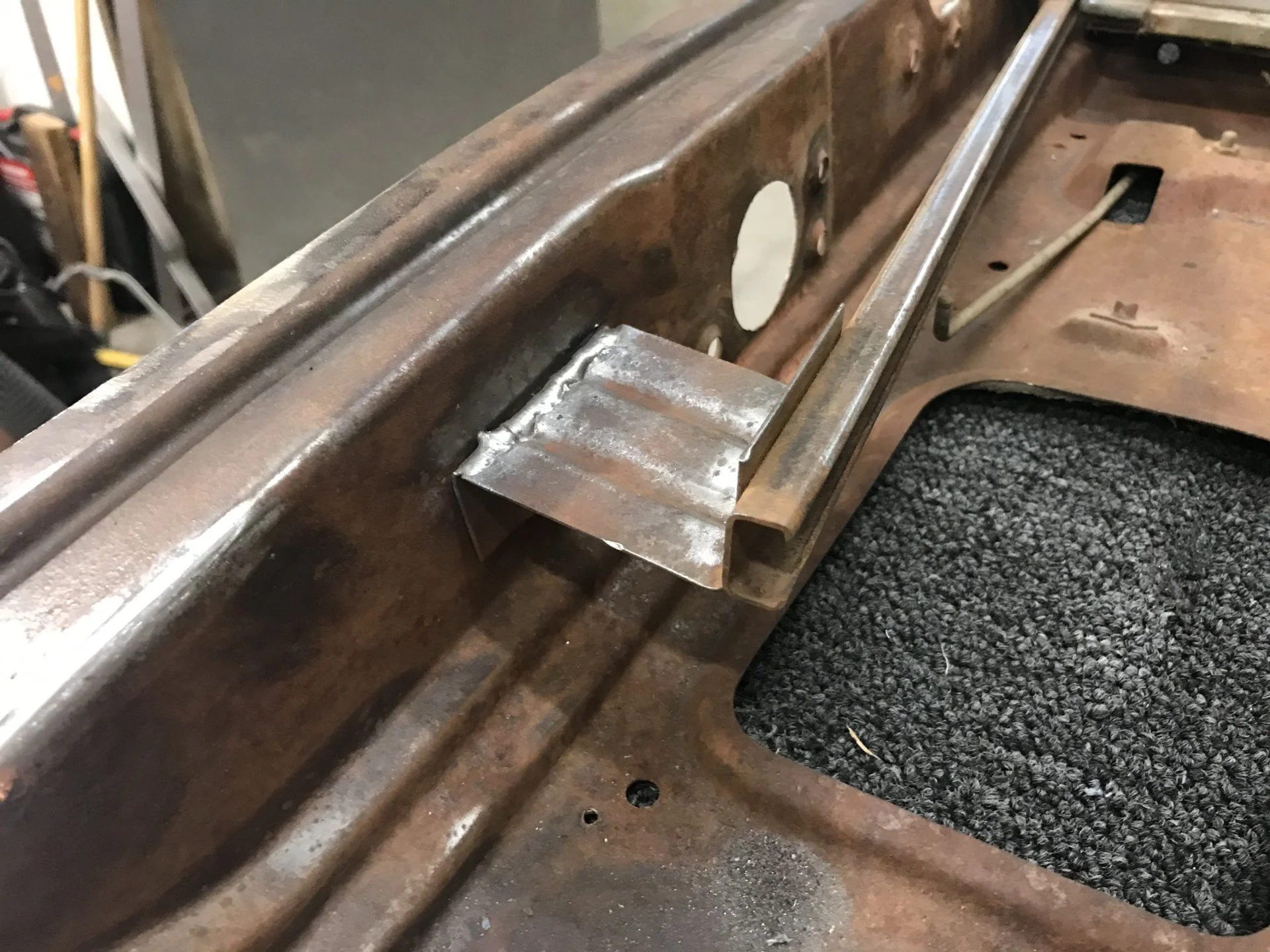

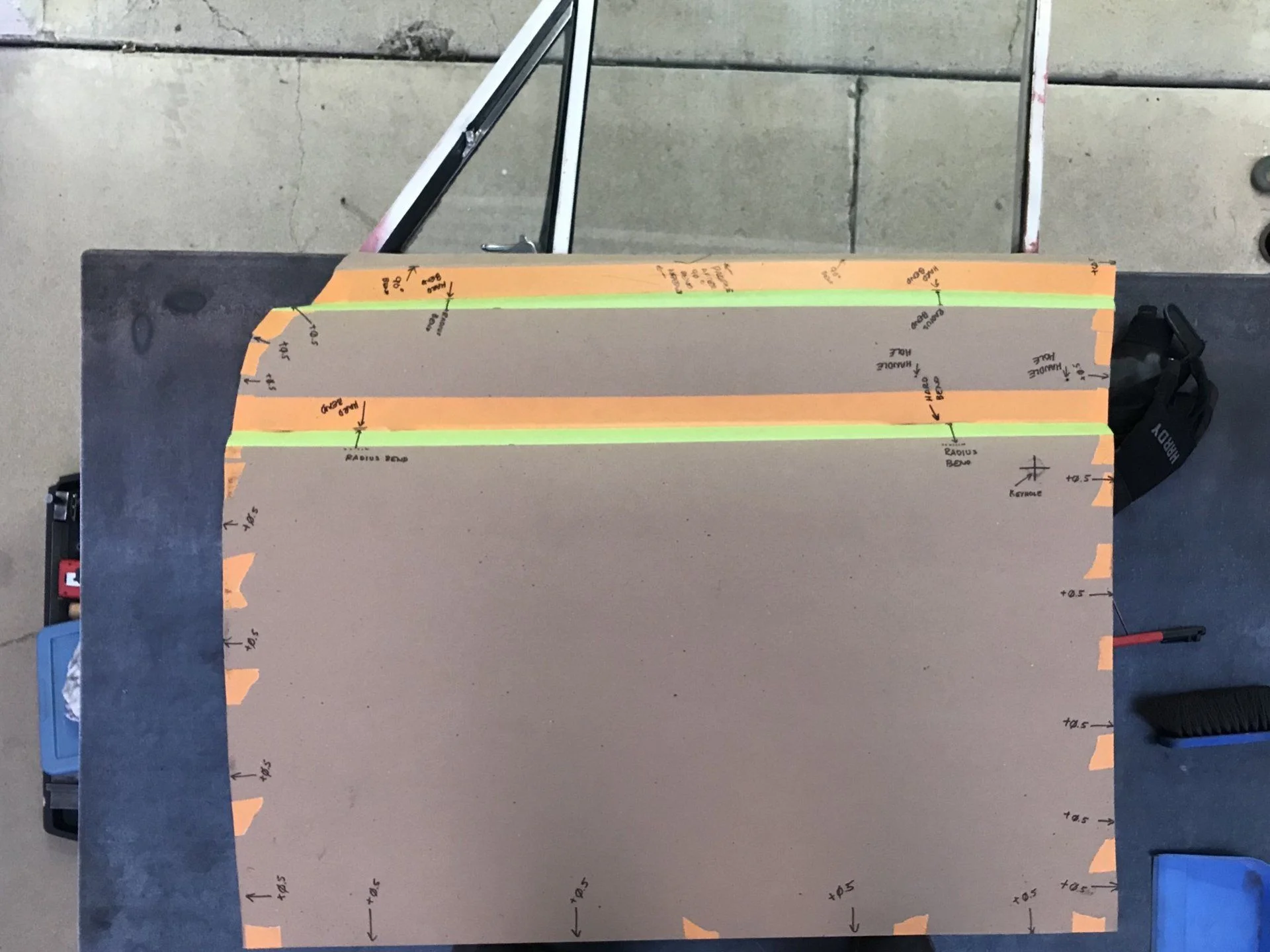

Mostly hinge and window track repair today. Also made a new 5/16” stamp instead of the 3/8”. Fits the profile better...
Lol. I’m hoping to just have two usable doors soon.
Will you blast and epoxy the interior of the doors BEFORE you weld on the exterior skin? What are your plans to coat it on the interior to prevent corrosion for the future?
The rust looks worse than it really is. I wire wheeled it and plan to put a rust neutralizer on it and some POR15.
