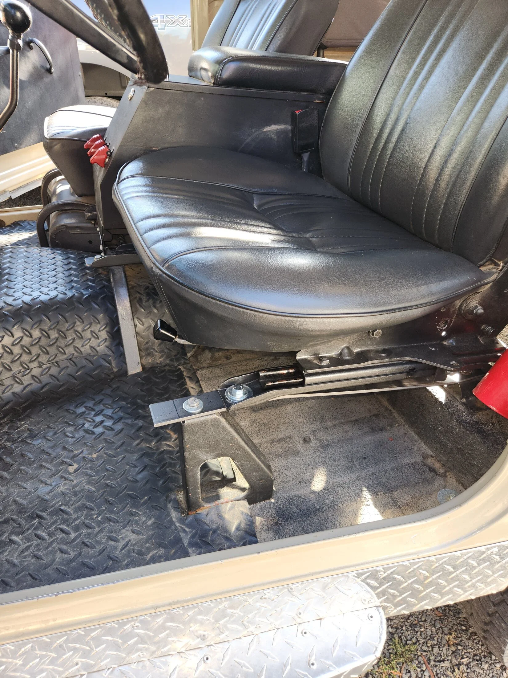

I'm the same height and ended up doing both modifications to get more legroom. It helped tremendously in my 76. Used some steel straps to extend both the driver's and passengers seats and gained about an inch and a half more room for each.
Doesn't sound like lot but it definitely helps. Not sure I still have any pictures of the installation, it was a few years ago. Really wasn't hard to do, just a few nuts/bolts and 4 straps I bought at Lowes for around
$30 then cutting to fit, precise drilling and bolting back together. Easy weekend project.
Went with a smaller steering wheel when I installed power steering and have had no issues. Definitely don't miss that giant OEM wheel. Used a steering wheel from a hilux truck and the splines matched perfectly, I believe most any non airbag Toyota wheel would work. Not the best picture but you can see the smaller steering wheel here on the 76 steering column. Very easy to swap.
Edit - found this Pic of the passenger side, the straps bolt on to the stock seat bracket then holes are drilled further back and the seat is bolted in as far back as possible. Good luck!!!

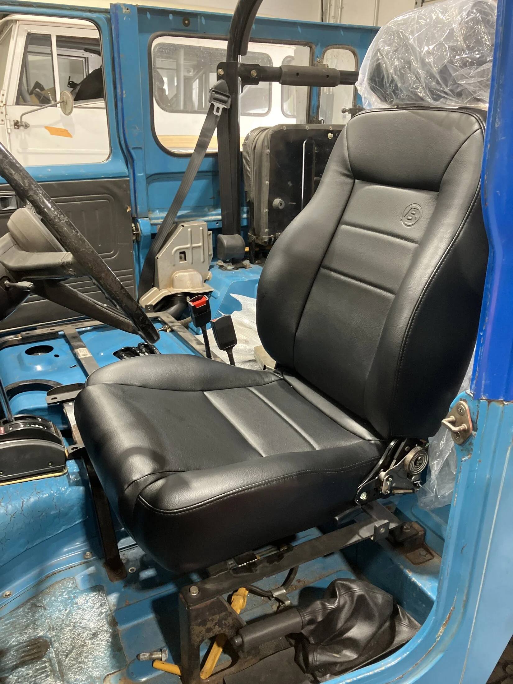

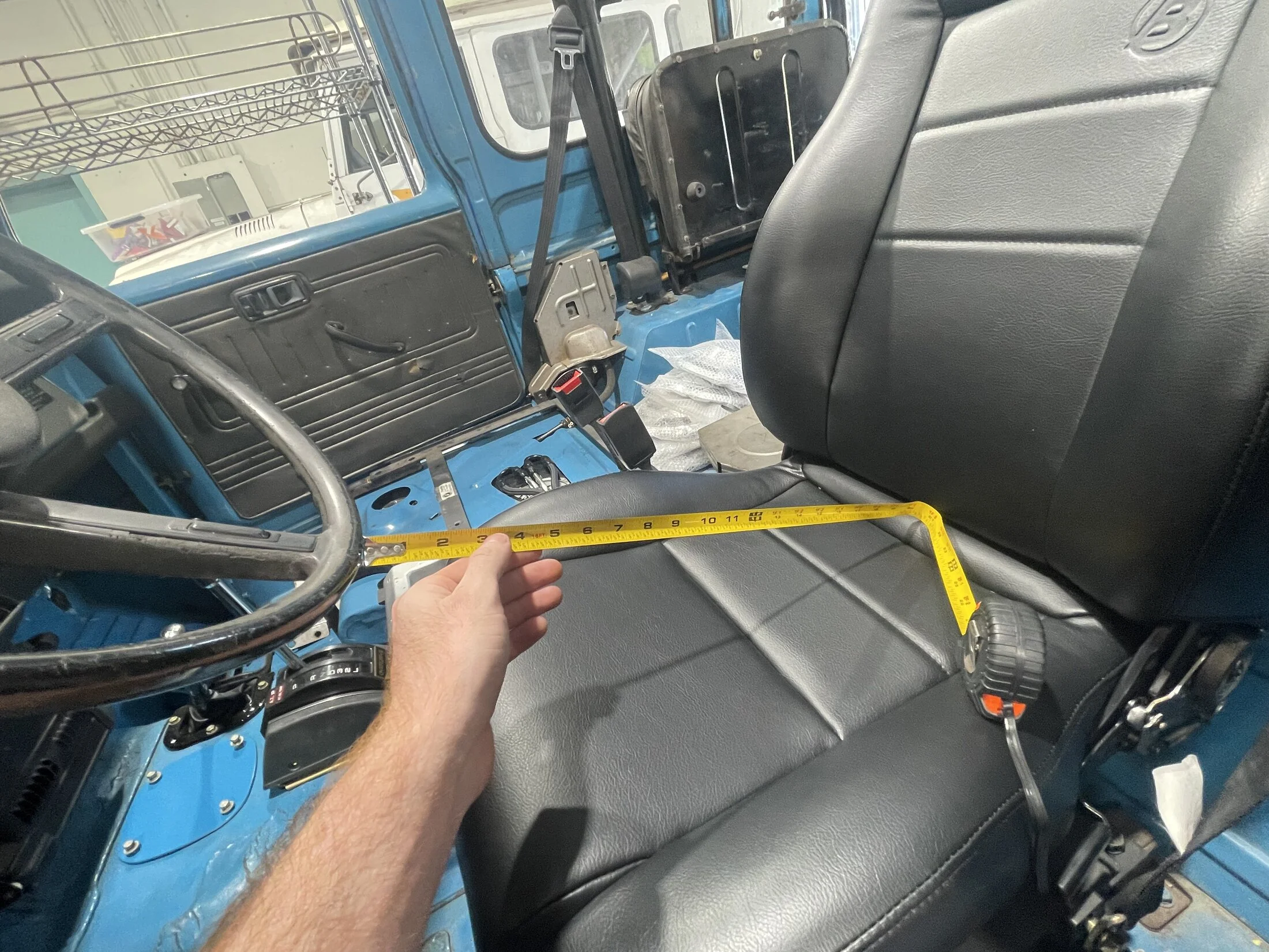

We make a seat bracket kit to fit Bestop Trail Max seats for 73-78 models. They are comfortable and the whole setup lets the seat move back about 5” (I think) further then stock.
20” from bottom of wheel to corner of seat at full extension.

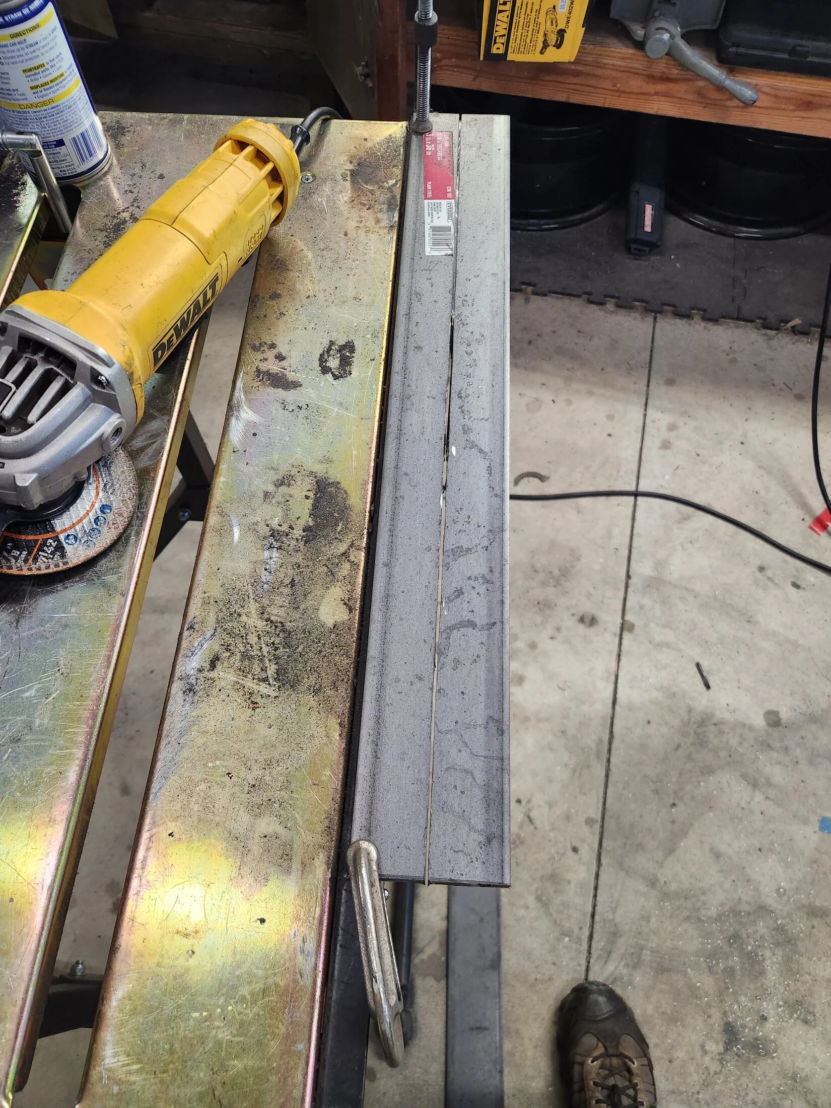

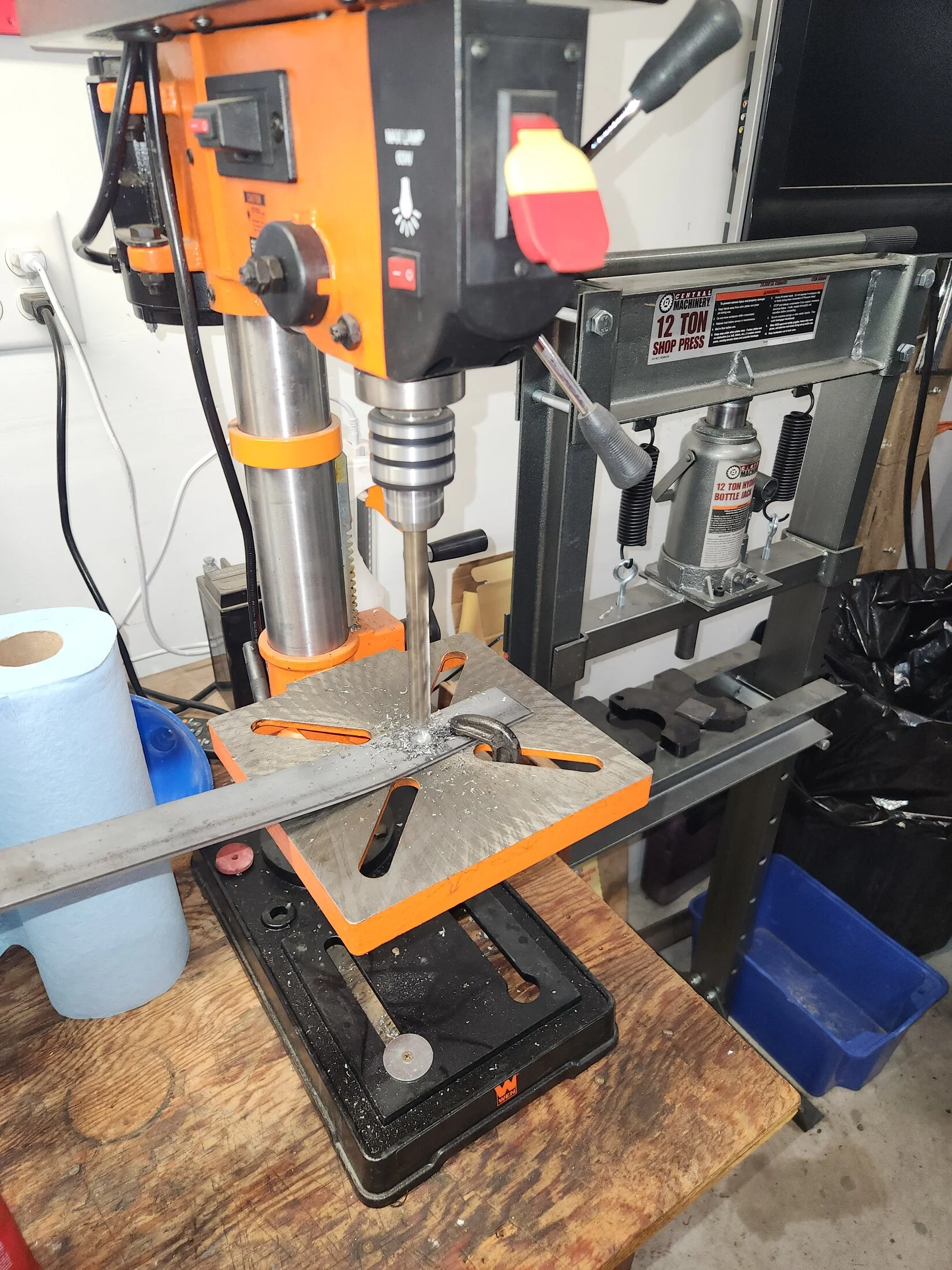

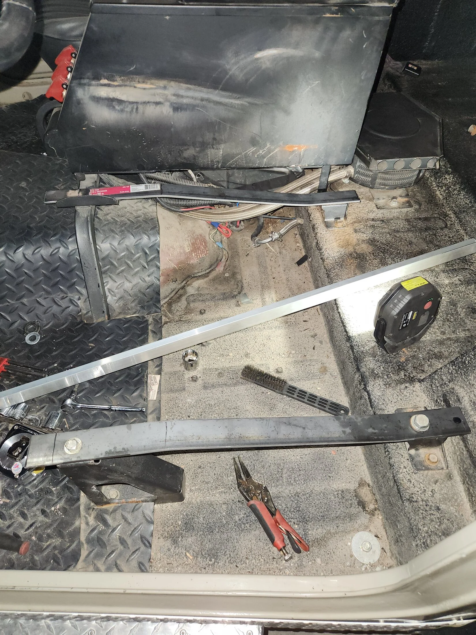

I am 6'1" with pretty tall legs. I moved my stock seats back by fabricating some pieces as others have suggested. It took a fair bit of back and forth, measuring, cutting, etc. Luckily I had some scrap steel and the right tools. I did trim a bit from the seat mount on the outside to get more room. Fiddly, but not complicated. I have since trimmed up the excess and raised the front with some washers creating a bit more front to back tilt. I'd still love 1 to 2 more inches, but this will work for now.

I am 6'1" with pretty tall legs. I moved my stock seats back by fabricating some pieces as others have suggested. It took a fair bit of back and forth, measuring, cutting, etc. Luckily I had some scrap steel and the right tools. I did trim a bit from the seat mount on the outside to get more room. Fiddly, but not complicated. I have since trimmed up the excess and raised the front with some washers creating a bit more front to back tilt. I'd still love 1 to 2 more inches, but this will work for now.View attachment 3825083View attachment 3825084View attachment 3825085View attachment 3825092
The sticking out part of your seat frame near the bottom of you fire extinguisher is on the insides of my seat frame. When I raise up the seat, I also have to raise the back end of my Tuffy, causing me to slam my elbow into the lid edge. Did you switch around your seat frame sides?
I had to raise the rear of the tuffy.
As did I, but as I mentioned, this raising lifted the tuffy enough to cause painful interference with my elbow. The question was did you reverse the seat frame part that sticks out so that it's on the outside edge? That seem like it should permit the tuffyback end to not have to be raised, I would think with the extra clearance.
I would recommend using steel for seat brackets, aluminum may bend and the bolts will rip right thru in a sudden unexpected stopping situation:eek:
I agree. I believe I used 3/16 x 2" steel straps that just needed a couple small bends to line up with the seat mounting brackets. Aluminum is not a good choice for this application. I think it would fail eventually as well.
