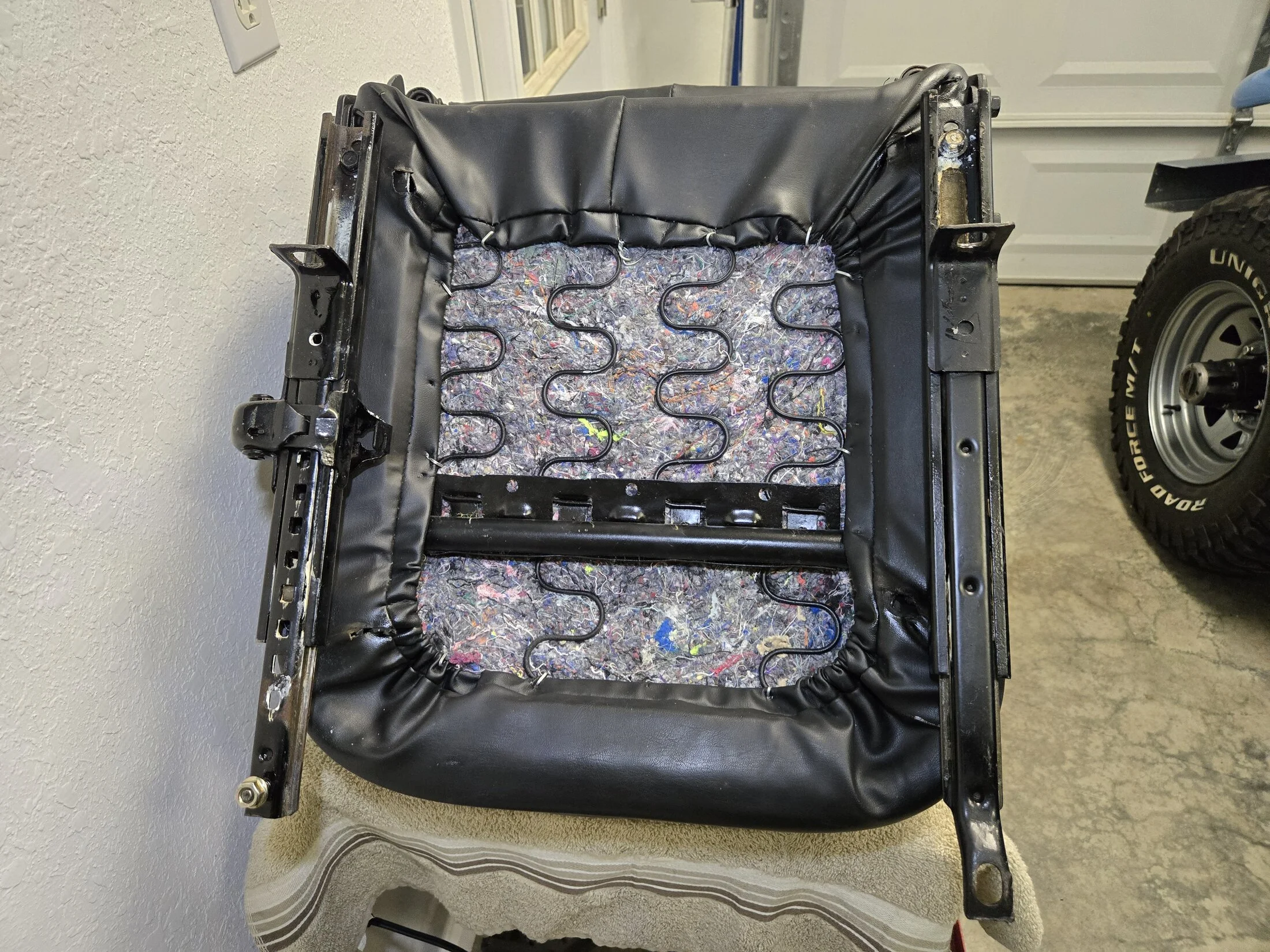

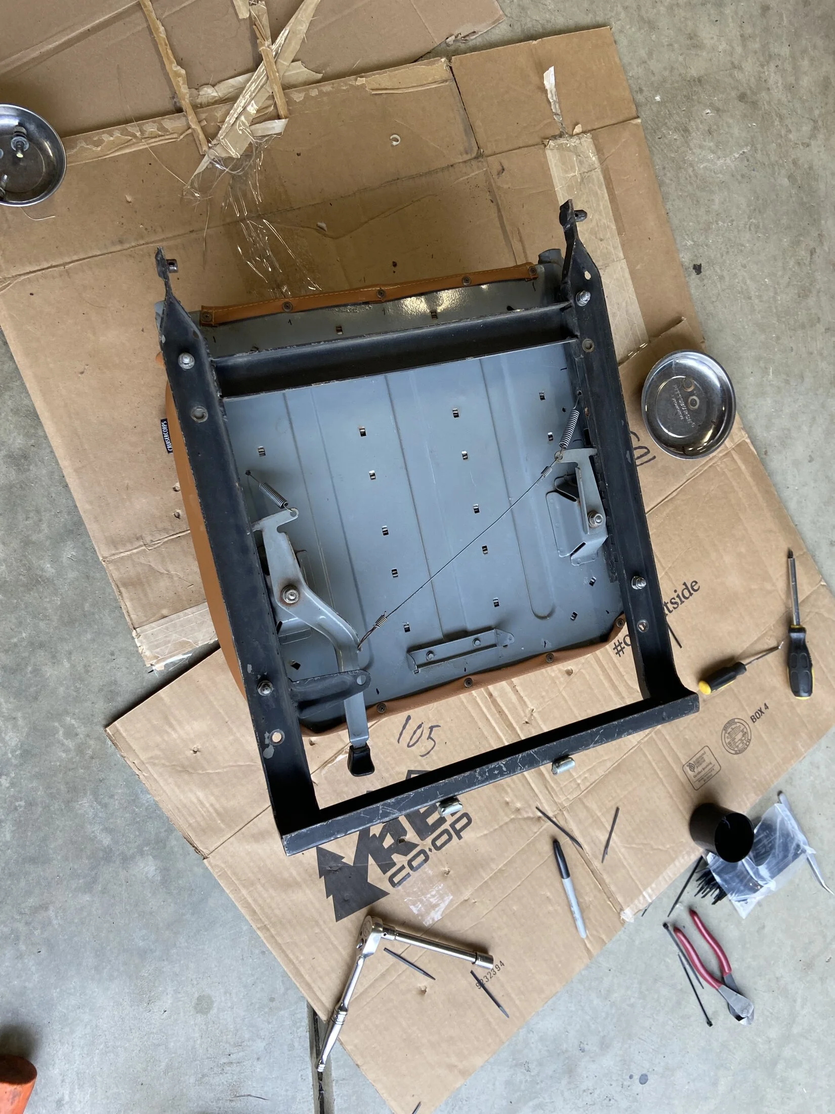

My seat is different in that it catches on only one side, the other side is free-wheeling. I am sending a picture. A question: With the driver seat positioned that far back, which is what I would need, do you find it cumbersome for your right arm with the bench seat offset so much from the single seat?
Not at all. It actually gives me a place to put my right arm. I honestly don’t think about it.

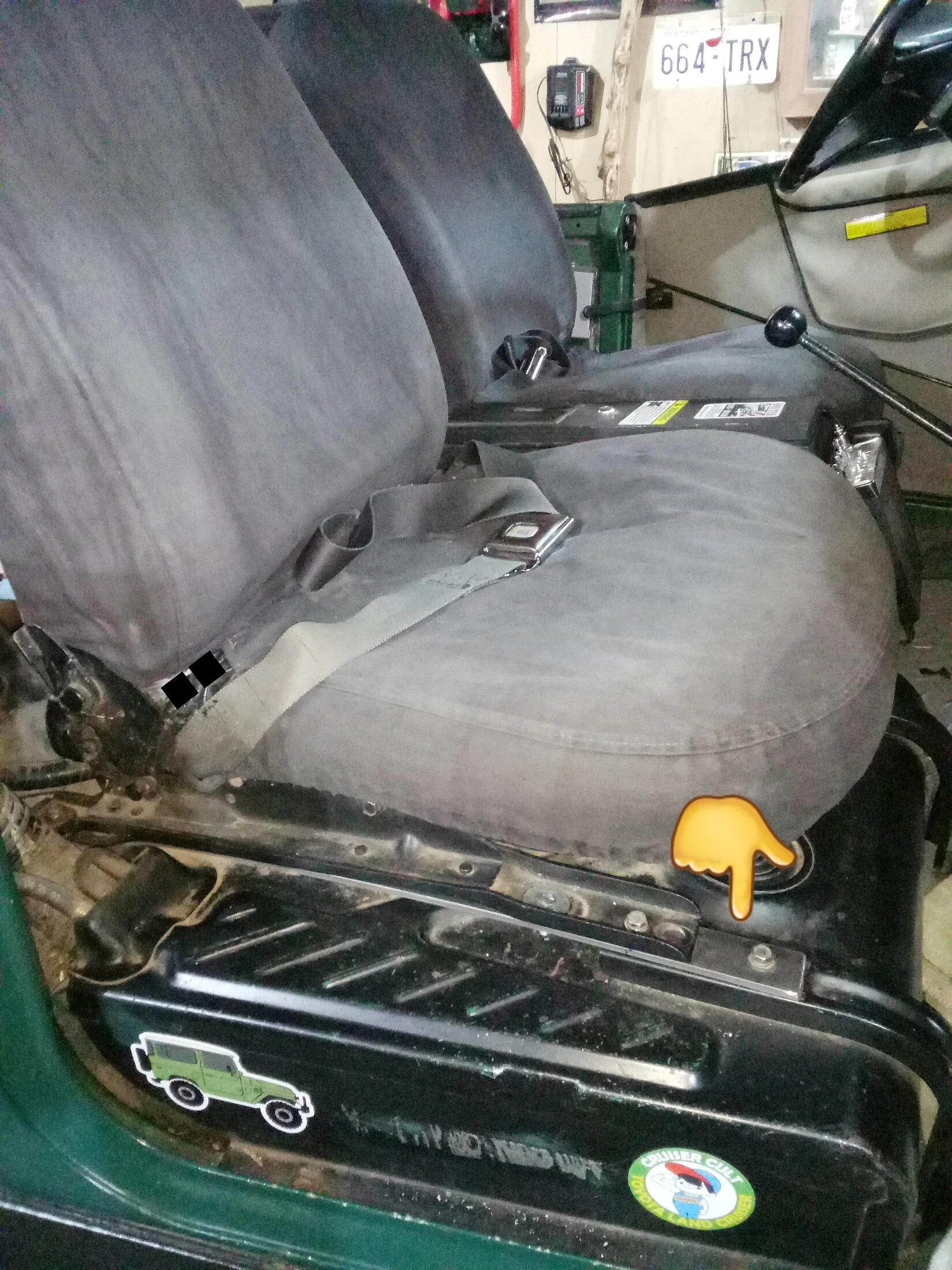

I'm the same height and ended up doing both modifications to get more legroom. It helped tremendously in my 76. Used some steel straps to extend both the driver's and passengers seats and gained about an inch and a half more room for each.
Doesn't sound like lot but it definitely helps. Not sure I still have any pictures of the installation, it was a few years ago. Really wasn't hard to do, just a few nuts/bolts and 4 straps I bought at Lowes for around
$30 then cutting to fit, precise drilling and bolting back together. Easy weekend project.

Edit - found this Pic of the passenger side, the straps bolt on to the stock seat bracket then holes are drilled further back and the seat is bolted in as far back as possible. Good luck!!!

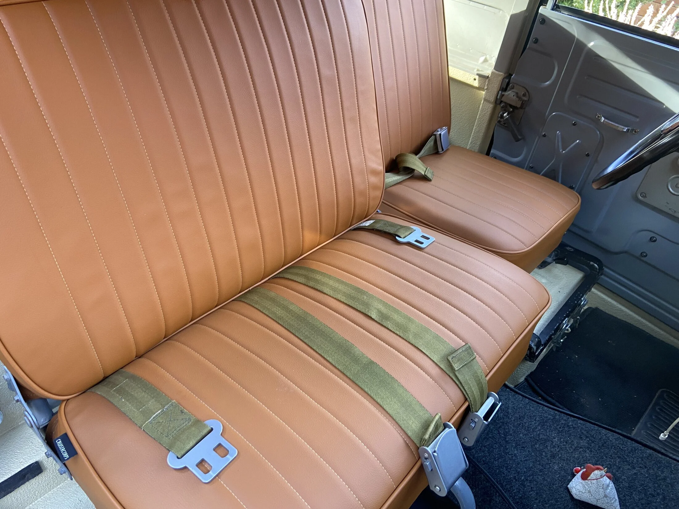

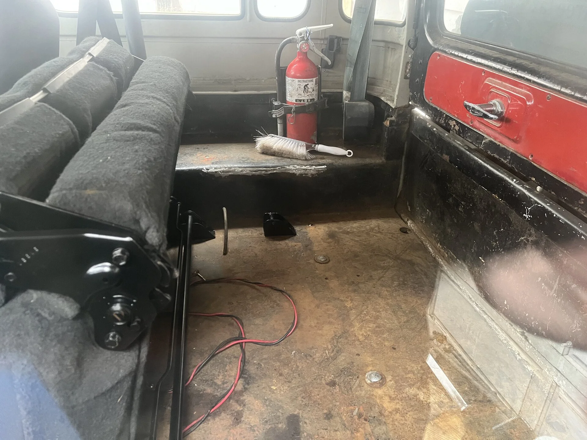

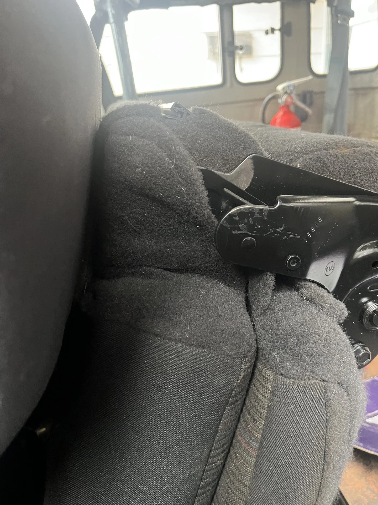

I'm 6'4" and haven't had any issues with the drivers seat of my '74 with stock bucket seats. However, on the passenger side there is very limited space between the front roll bar hoop and the front of the passenger seat. I don't have any great photos to show the difference in the offset, but these pictures of the rear bench folded forward should give you a general idea.
The passenger seat is probably 3.5-4" further forward than the drivers seat. My concern would be that it would get harder to get in the back with it moved forward. Although, moving it back an inch or so would allow the passenger seat to fold flatter. Whatever I do would be a compromise. I suppose the best option would be to make it adjustable... but then it might be too high. I'll have to look at how much it would raise the passenger seat to use OEM hardware from a drivers seat.

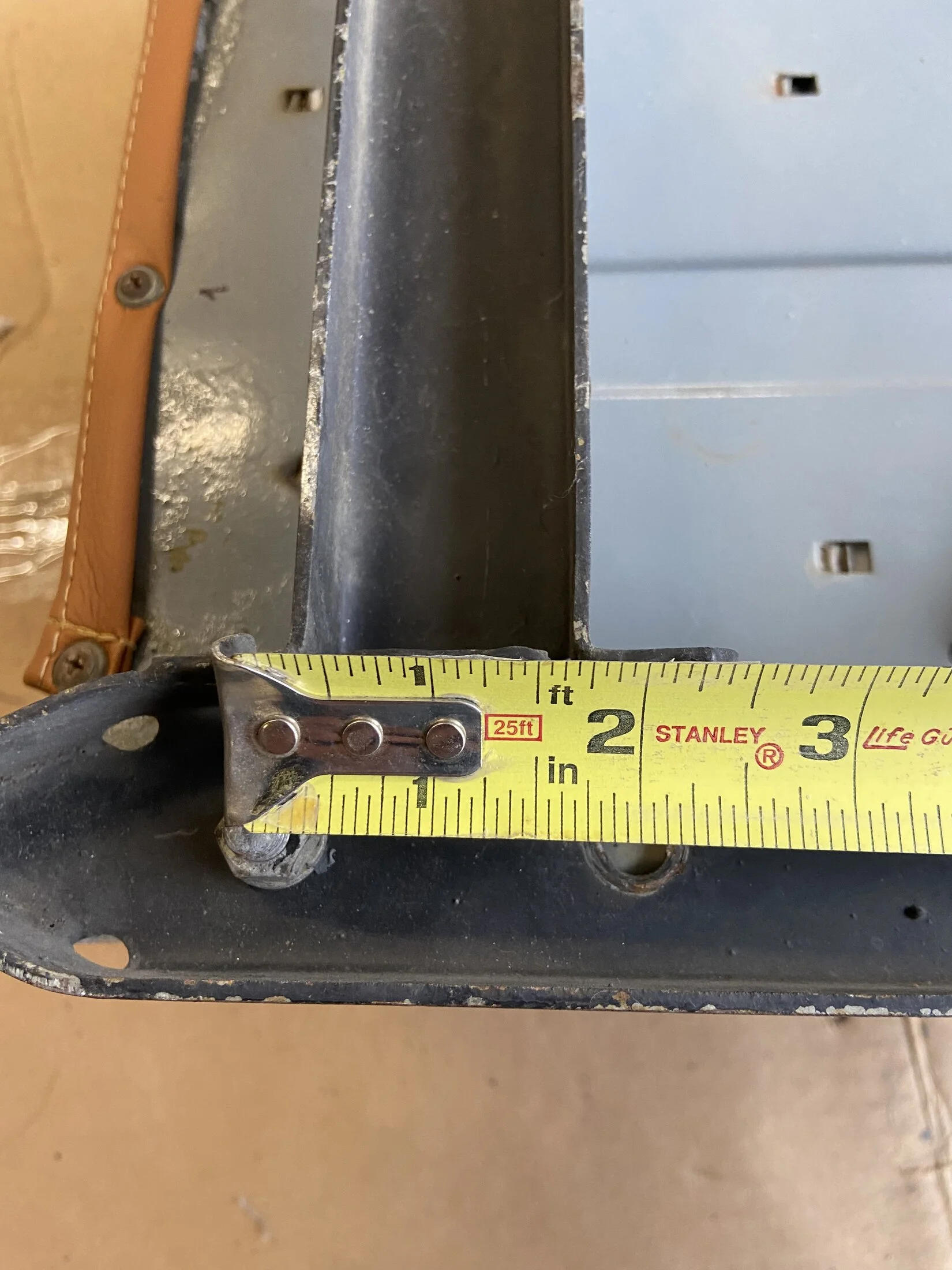

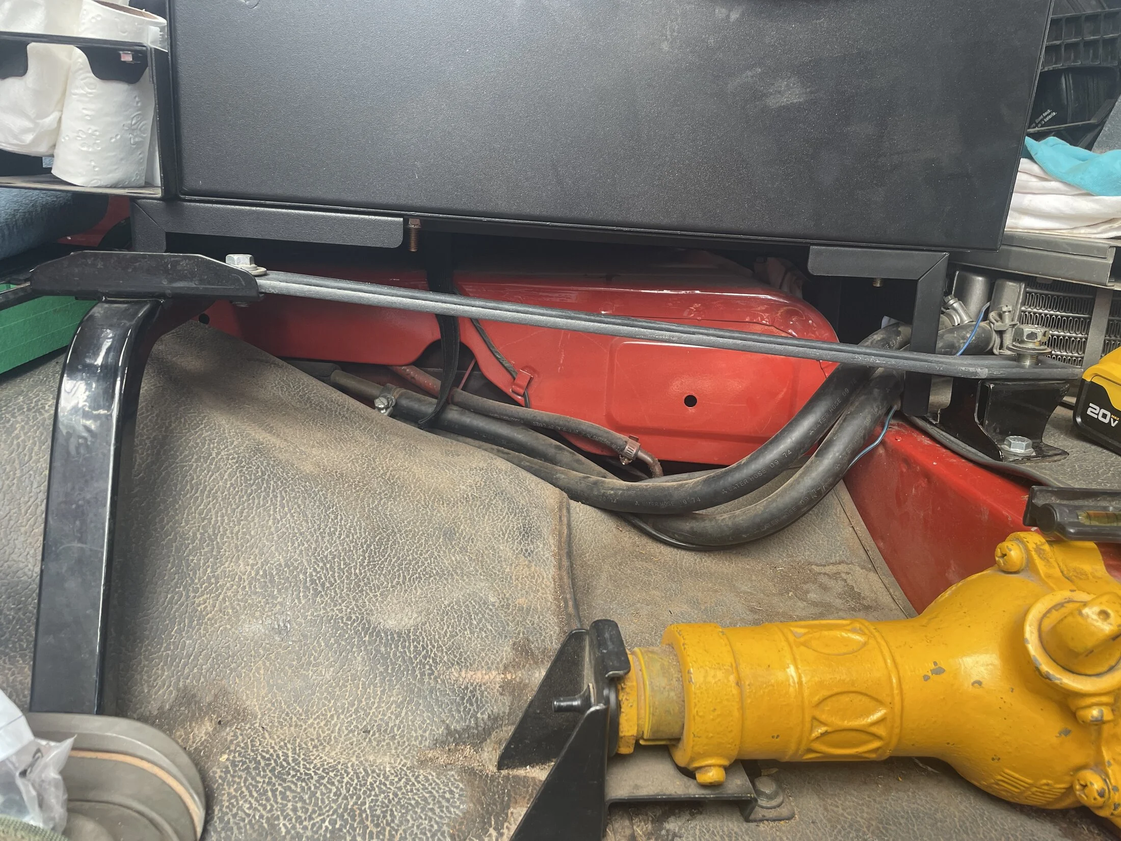

The sticking out part of your seat frame near the bottom of you fire extinguisher is on the insides of my seat frame. When I raise up the seat, I also have to raise the back end of my Tuffy, causing me to slam my elbow into the lid edge. Did you switch around your seat frame sides?
FWIW, I trimmed the bottom bracket for the tuffy so my seat "tab" could fit underneath it. Pic is pretrim, but that tab by the heater hoses just needed an inch cut and turned in so that the "tab" on the side would fit under.
