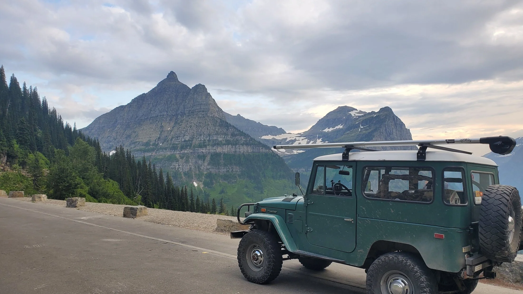

I’m running this Yakima setup and it works pretty well.
1. The 1A towers will barely clear the roof, but you won’t be able to fit anything under the bar. If you only want to load things on top (wood, canoe, etc) and tie down on the sides it’ll work. Any sort of accessory that needs to clamp under the bars won’t work without the ‘high rise’ tower extensions.
2. I had to buy the 66” bars, if I recall correctly the actual min distance is 60-62” so Yakima’s 58” bar won’t work.
This picture is pre-high rise extension. The back tower is the problem.
I like mine for sure but for what its worth to other people I think the early fj40s with the corrugated sides had different fiber glass roof caps that are taller. my same setup would not even attach without the high rise extensions on the yakima towers. With the high rise I still have to place it just right so it does not rub on the back one.
I have the same bars and towers and switch them between my 40 and my 60. I have them a bit farther rear (rear bar) and forward (front bar) and it’s still really tight.

Thanks!
Thanks for this, mine is precisely a corrugated top.

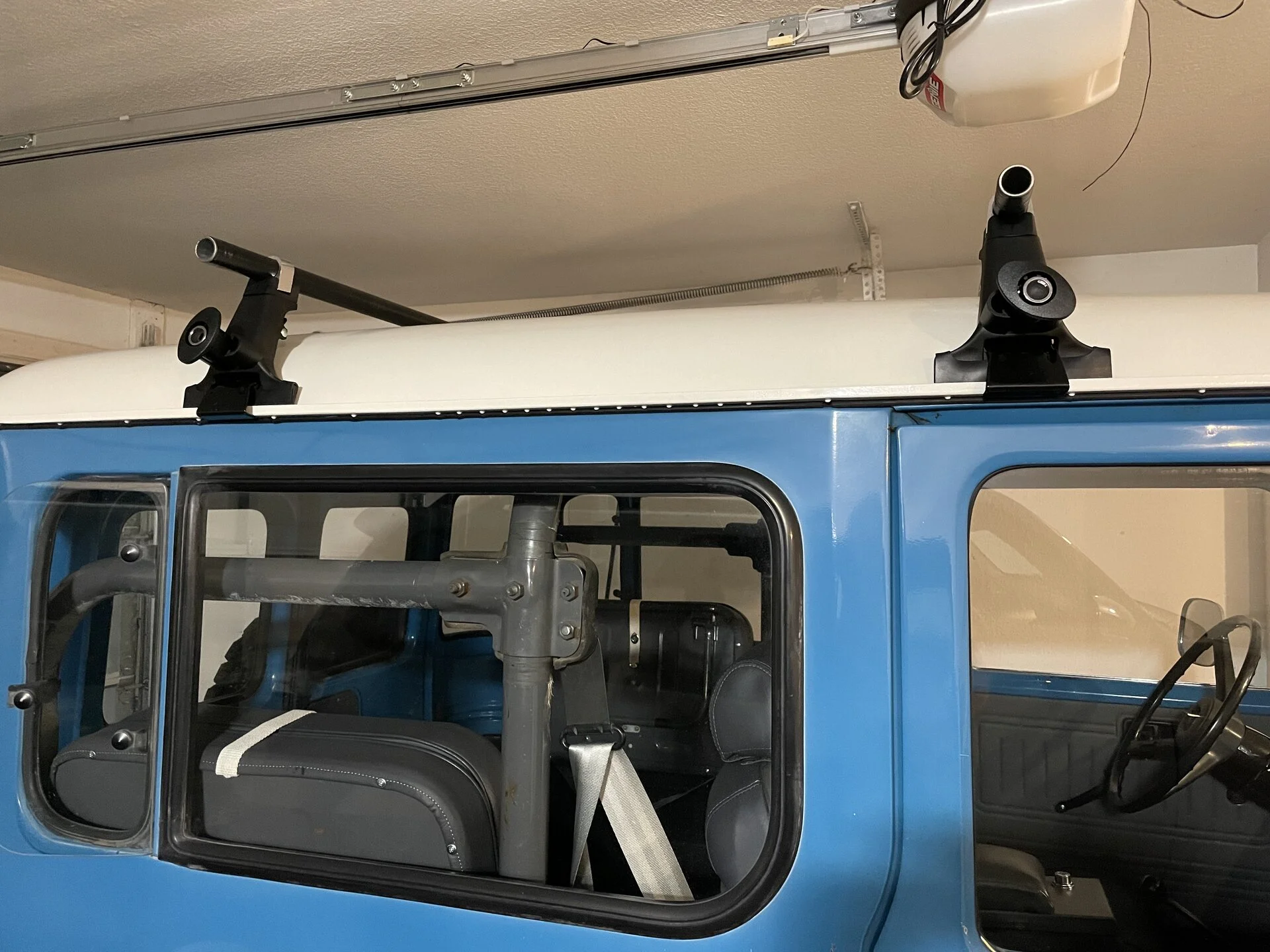

Do you have any pics of the hirisers installed on your corrugated top? Likely what I will have to go with. Thanks!
