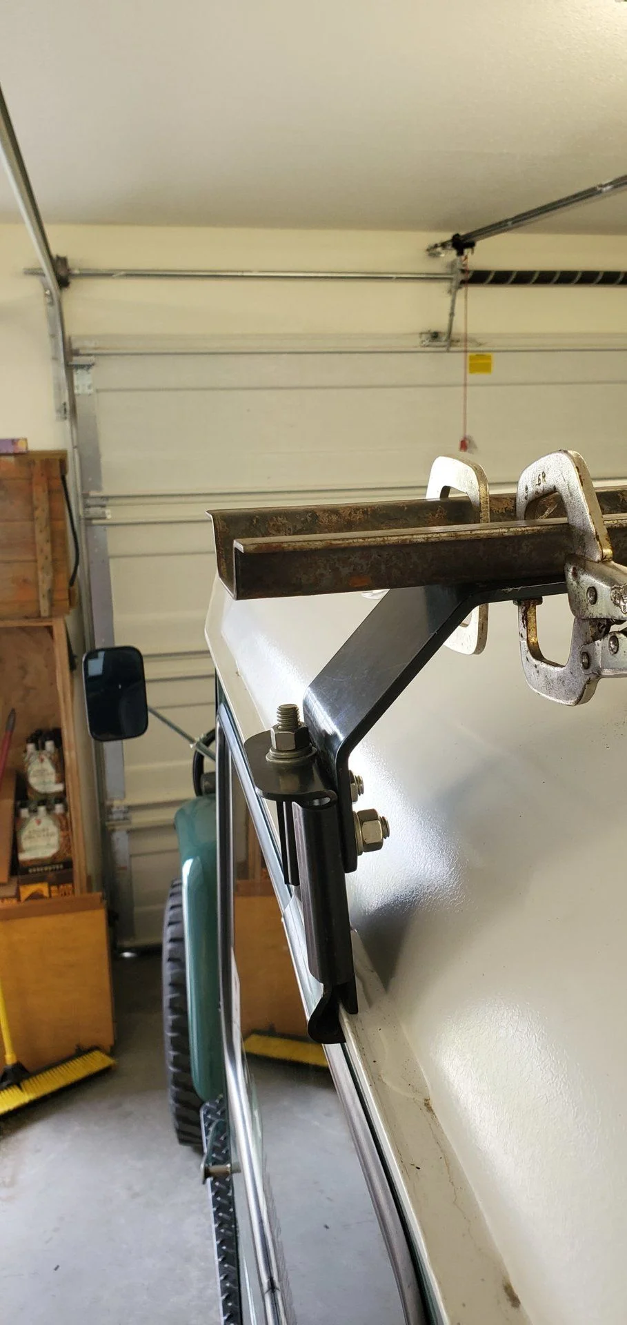

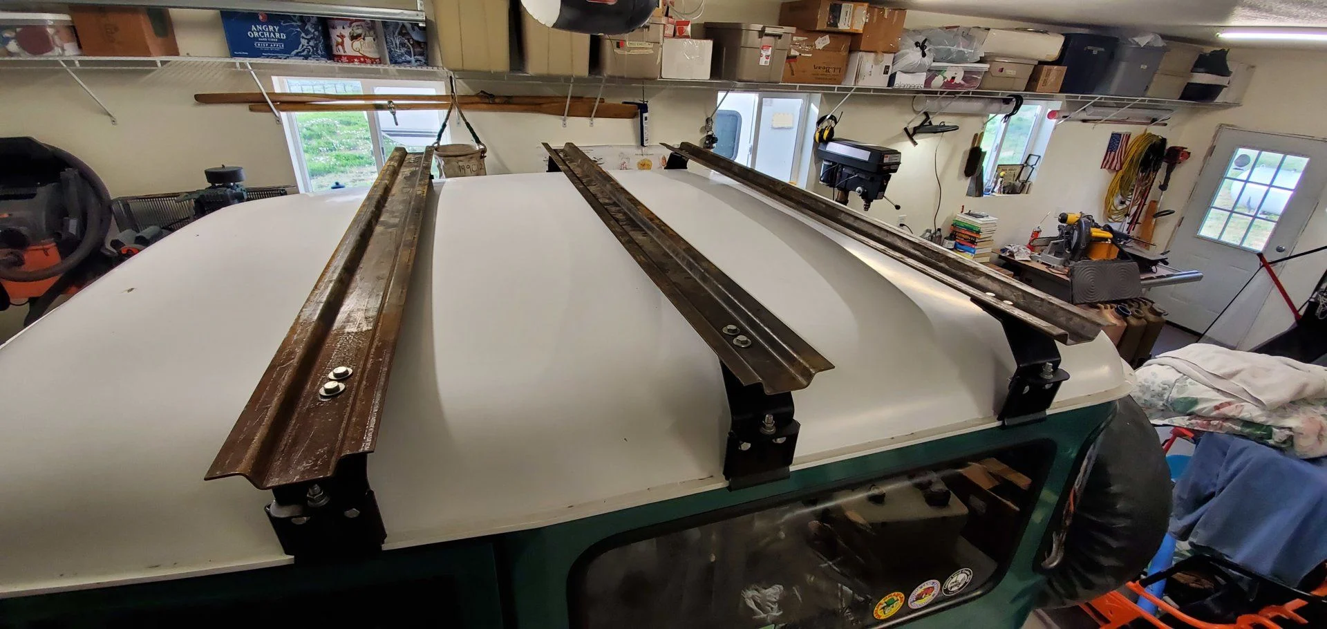

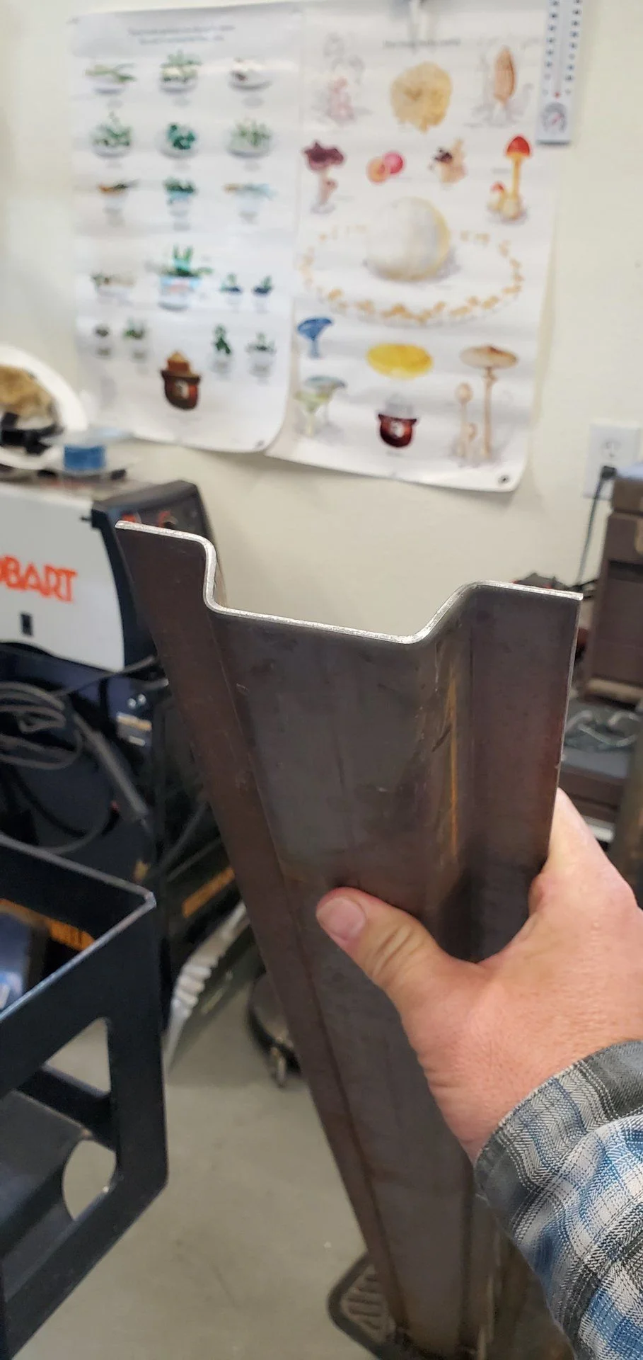

I had some stuff fabbed up to use with gutter clamps, I can mount my roof rack on it or leave it with the beams by themselves.
Might be the only shot I have without the rack on top.
Sorry for the crappy scenery.

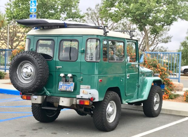

I’m running this Yakima setup and it works pretty well.
1. The 1A towers will barely clear the roof, but you won’t be able to fit anything under the bar. If you only want to load things on top (wood, canoe, etc) and tie down on the sides it’ll work. Any sort of accessory that needs to clamp under the bars won’t work without the ‘high rise’ tower extensions.
2. I had to buy the 66” bars, if I recall correctly the actual min distance is 60-62” so Yakima’s 58” bar won’t work.
This picture is pre-high rise extension. The back tower is the problem.
