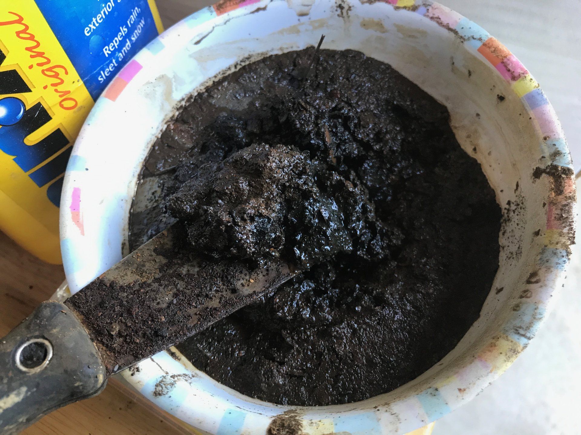

Here is a portion of what I flushed out of the block. I'm pretty much ready to re-assemble everything and button up the cooling system. I'm wondering if I should put the old radiator back in for a flush before installing the new OEM radiator I have sitting in the garage. I think I got most of the big chunks of whatever stop-leak garbage the PO put in there, but you never know what will break free once I put coolant in there and heat things up.
I also don't want to introduce old radiator funk into my flushed block, heater cores, new water pump and hoses. Hmmm... Need to mull on that one for a while.
Thats pretty nasty, I wouldnt be surprised if your new radiator get clogged as stuff dislodges in the future. I would remove the trans tunnel and repair the floor, it doesn't look too bad. Rust converter will fix a lot of that and a wire brush on a drill. You can buy cruiser paint in a aerosol can from a paint supply store.
