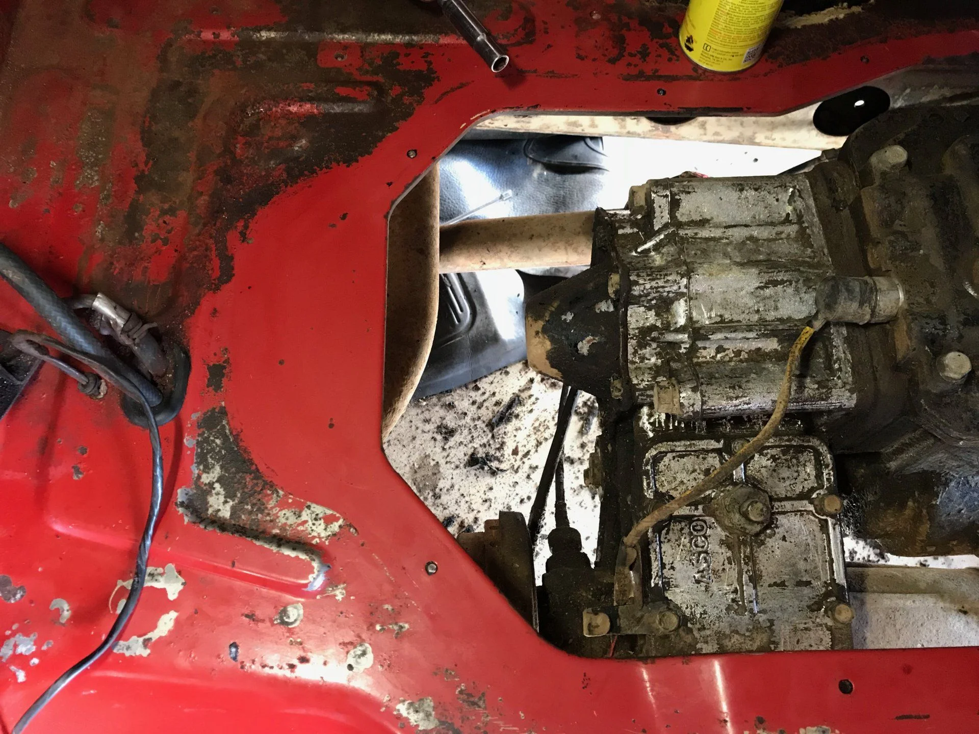

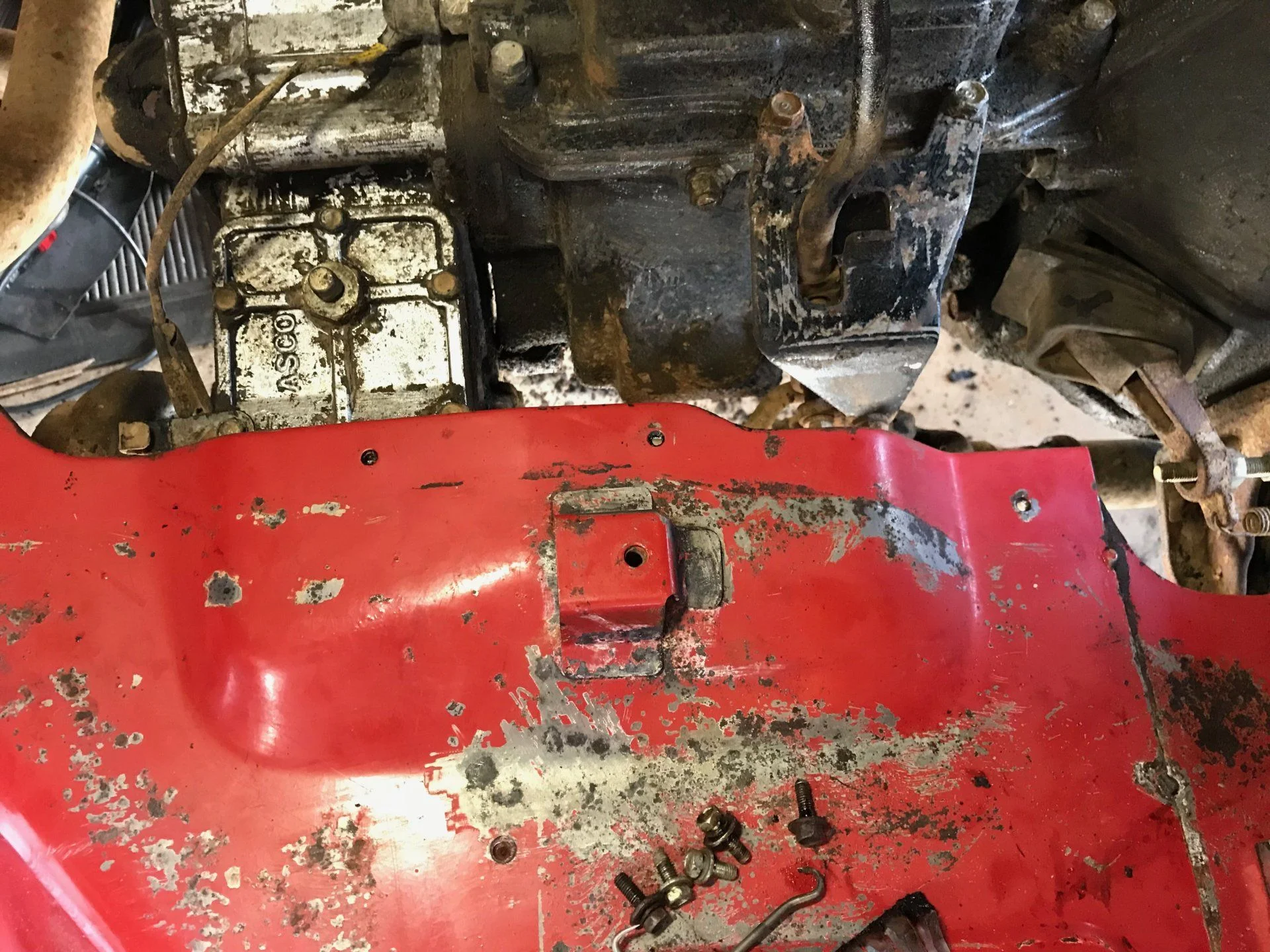

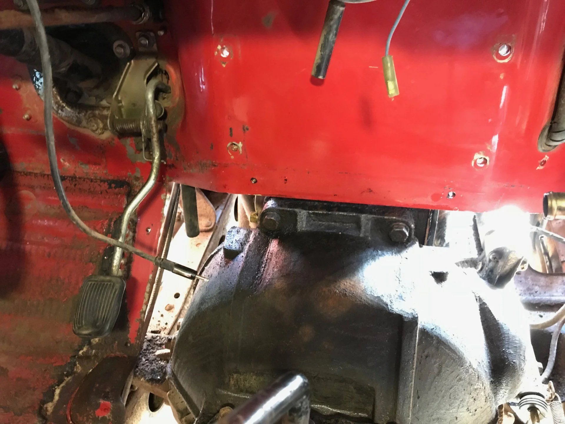

I pulled the transmission hump today to see how the rust looked underneath. I was pleasantly relieved to find nearly none. The oily tar sealant and the used-to-be-foam gasket kept things pretty well sealed up. No surprises, except the happy kind. I'm going to keep wire brushing off the loose rust and bubbling paint I have in spots, then treat with some rust converter. I'll grind down a bit on the pitted spots to see if any of the go through, but I think I'm in pretty good shape.
I also took the opportunity to scrape 40+ years of crud off the top of the tranny and TC. No surprises there, either. Everything is looking good. Just really dirty.

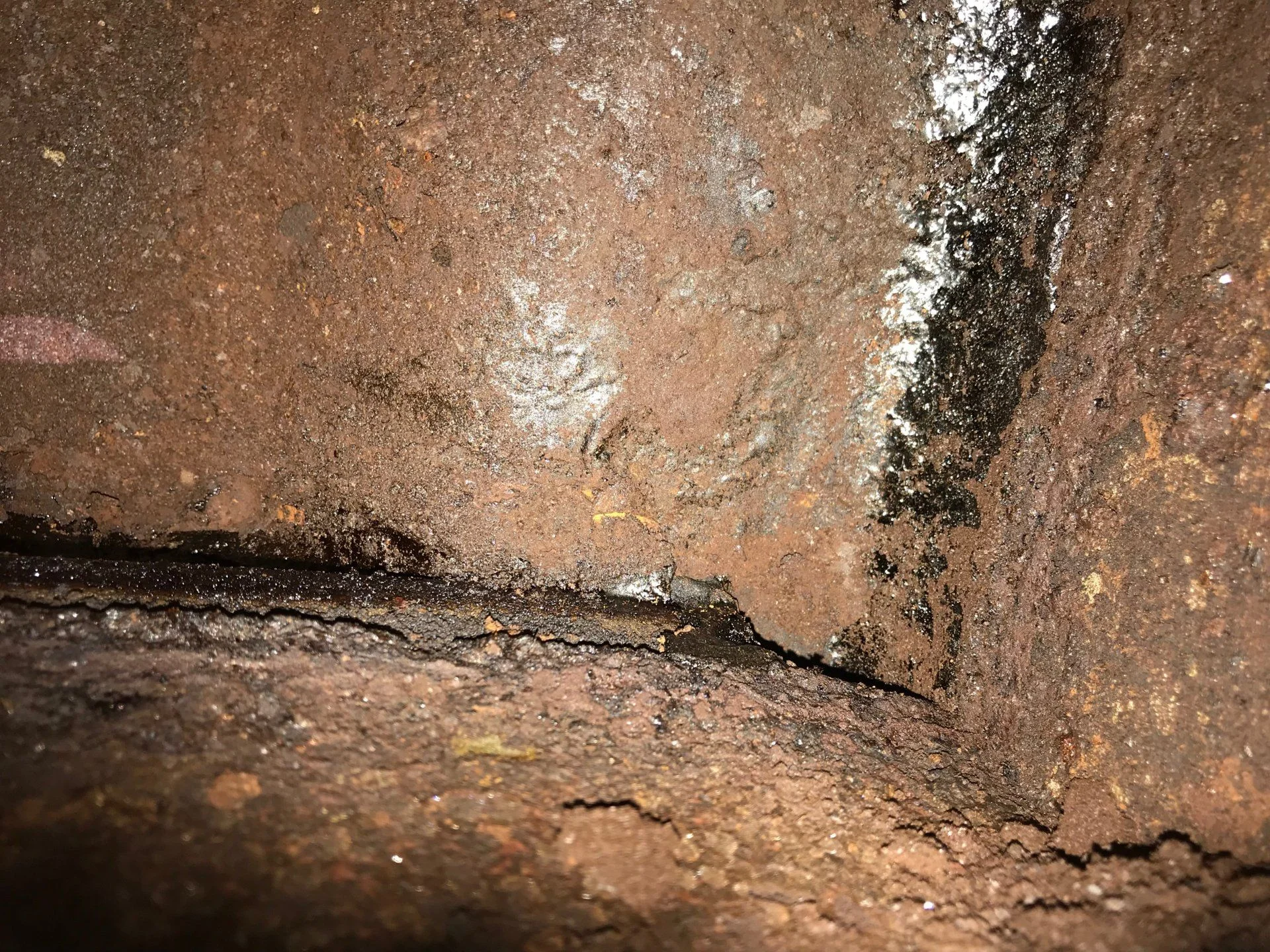

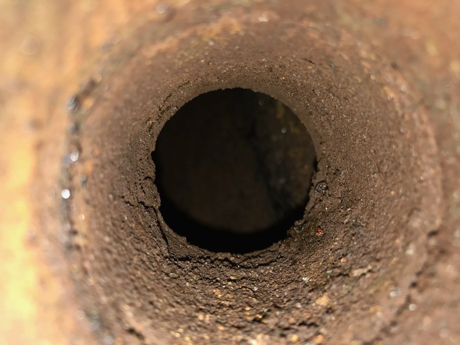

The gas tank is another story. Looking like a total loss to me. I was hoping I could clean it up or have it boiled and sealed up again, but I think this is beyond saving.
First shot is down the filler neck. It doesn't get any better the farther down you go.

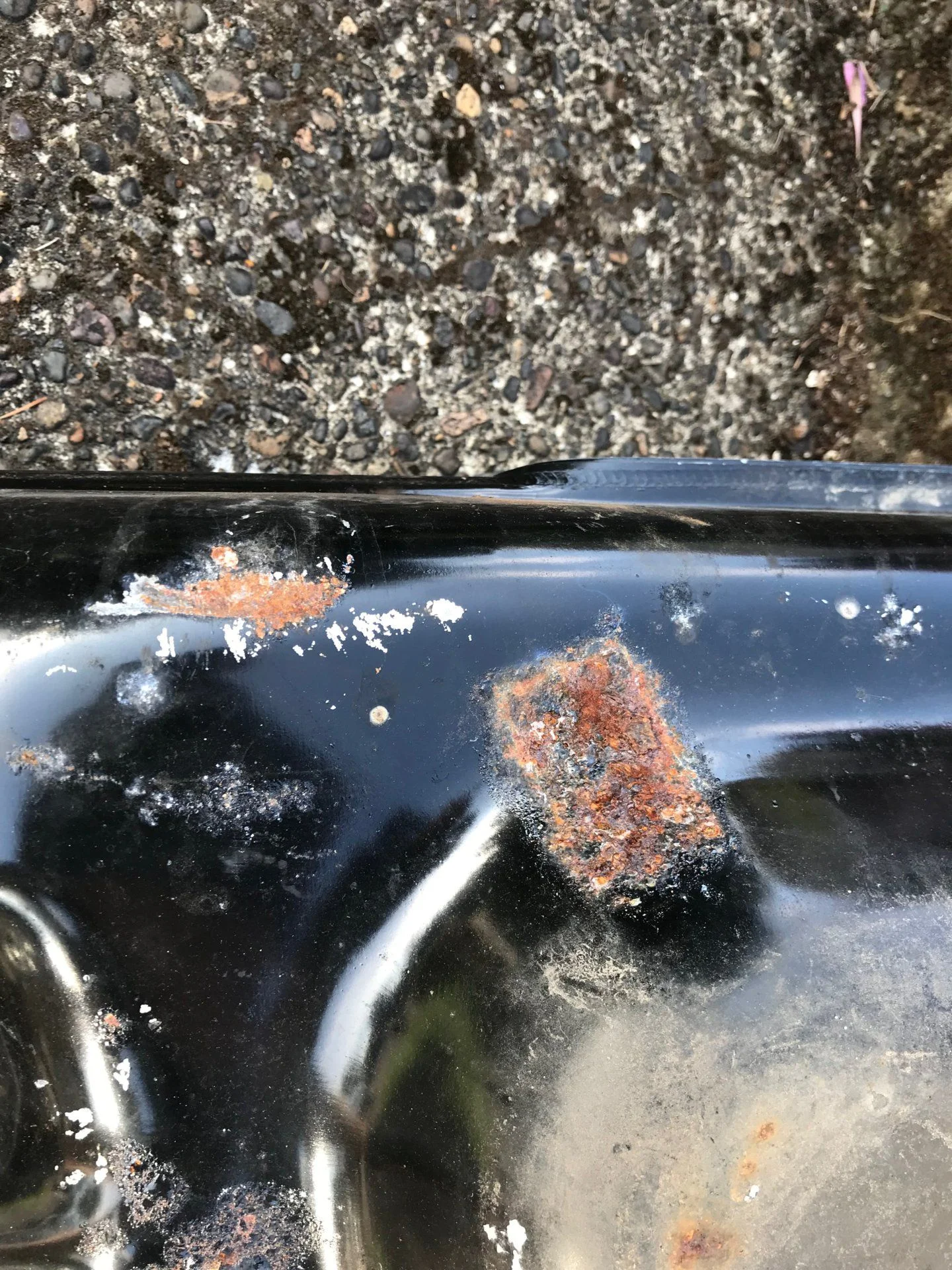

Exterior seams are rusty and appear to have been leaking.
The PO might have replaced the tank at some point, but it has at least been removed and reinstalled poorly. He used strips of outdoor carpet for the insulator pads. They look to have held a bunch of water against the tank, as there were rusty rectangles on the tank and the floor pan in each spot. The carpet pads were filthy, greasy, and stunk of old gas. Gross.
Inside looks like this or worse everywhere I could see. There is easily 1/2"+ of rust sediment in the bottom of the tank. Seams look bad from the inside, too.

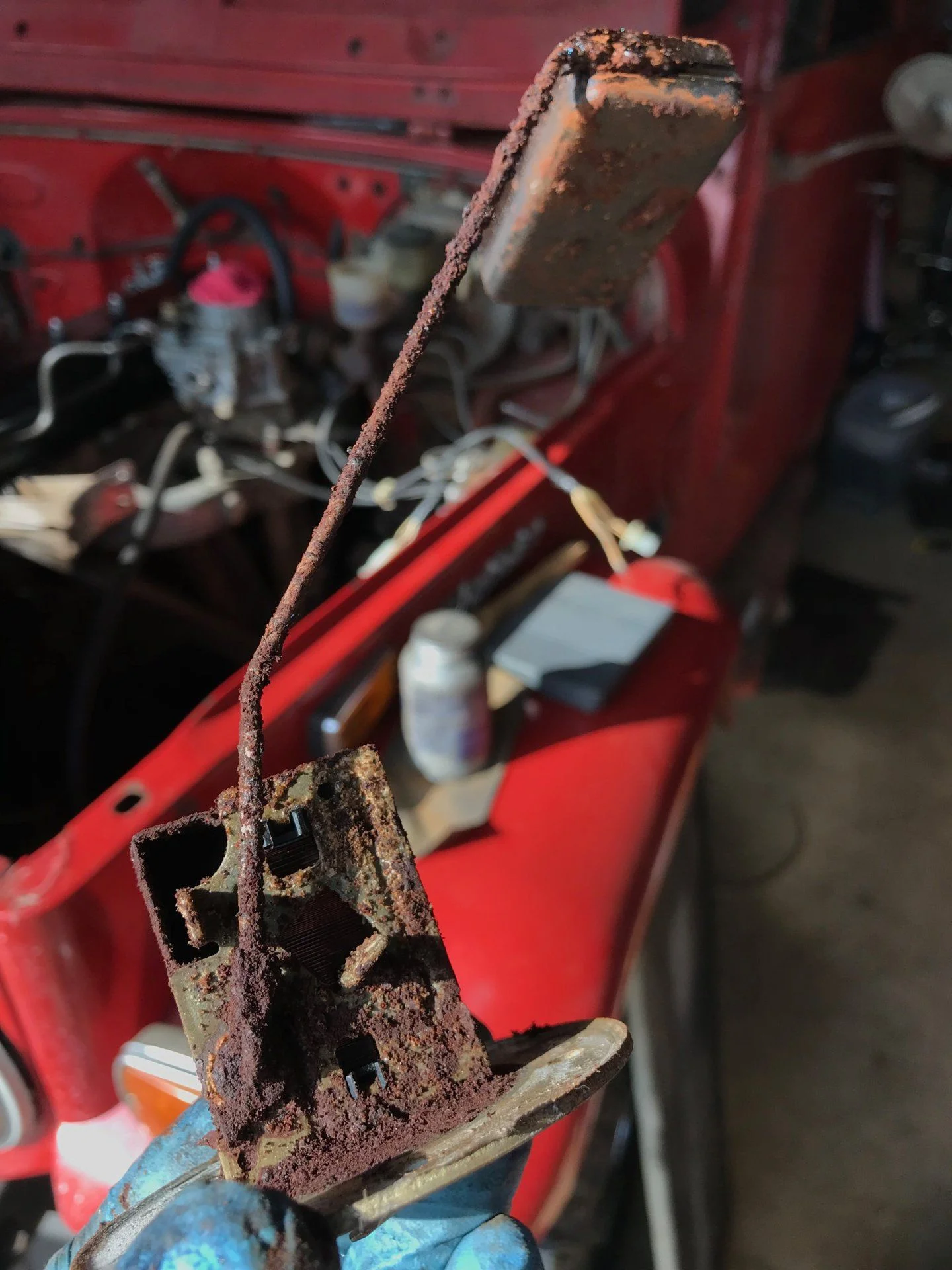

Sending unit is shot. Rusted completely solid in spots. No movement of the arm.

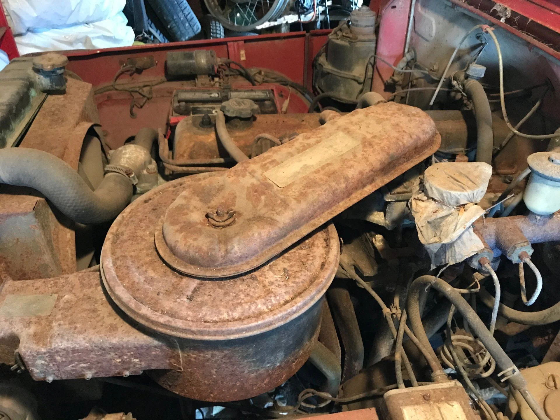

I posted this on this on the weekly update thread, but I'm sharing it here, too. I've been a little bummed about how slowly I'm moving on this truck, but I need to keep looking at the before shots to keep track of how far I've come.
Here is a before shot of the engine bay on the day I brought it home in April, along with a shot from today. I took the day off yesterday to take advantage of the last day of warm, dry weather we're likely to have for a while to paint up the air cleaner, heaters (front and rear),, brake booster and some small assorted parts.

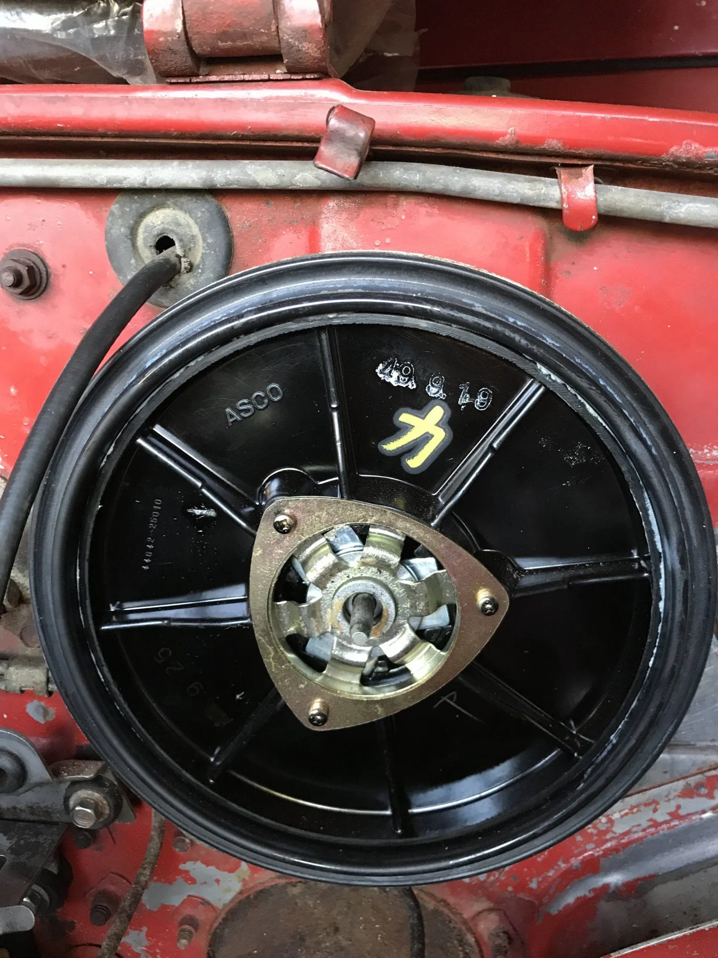

Also thought this was cool. My wife noticed the Japanese symbol for power and strength hiding inside the power brake booster. Thought it was a cool bit of hidden art stashed there by somebody in Japan in the seventies. Or it is an upside-down four. I'm going with the power kanji.
