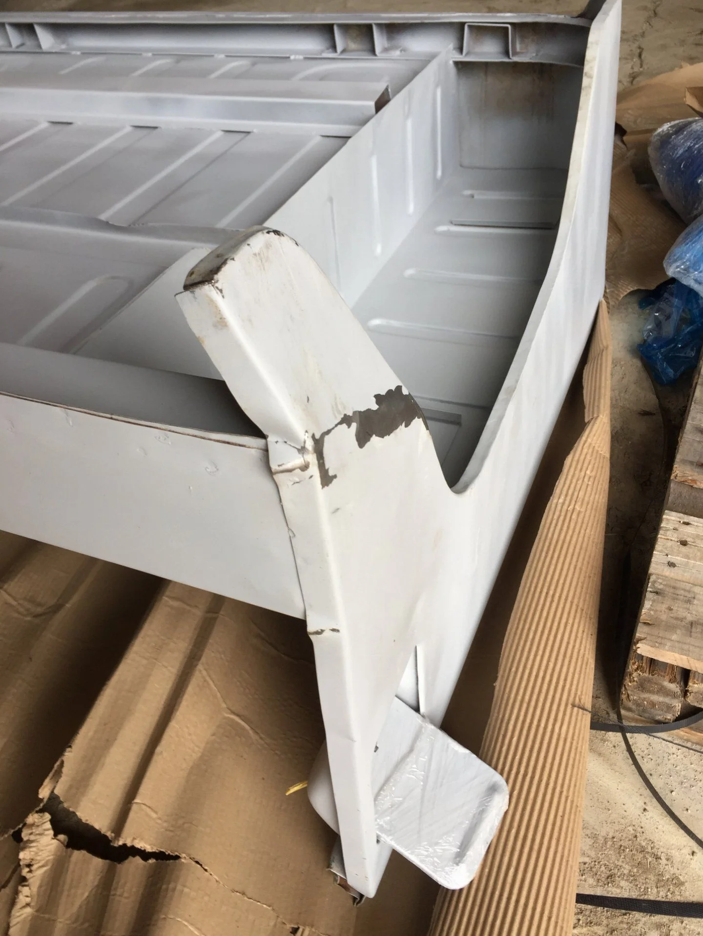

Has anyone used a half tub purchased through landcruiser heaven? I just finished joining the front and rear tub sections. Out of curiousity, I measured the body mount holes and compared them to the old rear tub. Turns out the new rear tub is 1" longer!!!!!!!NO!!!! Not a bad dream. Mine is a 1971 which I specified when ordering. I have no idea how to accommodate this extra 1". It's going to throw off my body mounts, my wheel position in fender openings it's going to hang over the rear bumper by an inch. I've spent countless hours fitting the two halves together and doing body work on the replacement tub section. (It came on a pallet... beat to hell, the sides were both bent inward. The front opening for wheel well (horn?) was bent 90 degrees...). Dings galore....
My question.... has anyone else experienced this??? Any ideas?? I'm thinking about extending the frame rails 1inch. Right now I'm trying to absorb this!! The major part of my budget was spent on this rear tub.....

Where do you think it is stretched? The"horn" looks wide.
