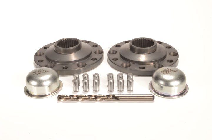

Are the RCV drive flanges not up to the task?
Only asking because they appear to be a easy option if they’ll work for your application.
RCV 4340 Drive Flange Set for Toyota Solid Front Axles
They won't work with the studless hubs. I have stock hubs, but was hoping to use the studless hub instead in order to eliminate the weak point of the drive flange studs.
