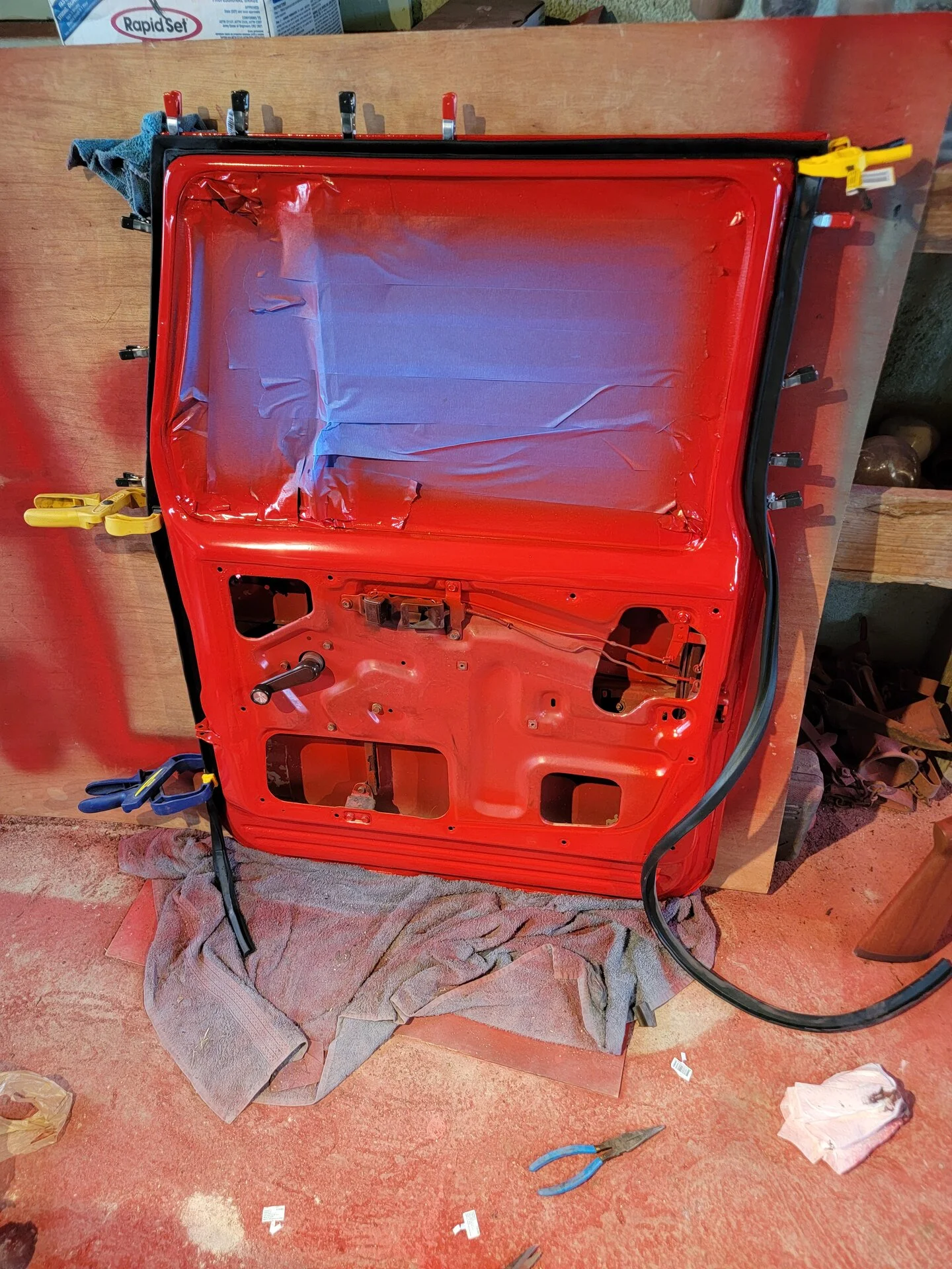

Tiny clamps, one section at a time. Start in the upright position and do top of doors, then lay flat to do bottom in the same manner. Lay generous line of adhesive. Helps to lay gaskets out overnight on the door with a heater on the night before.

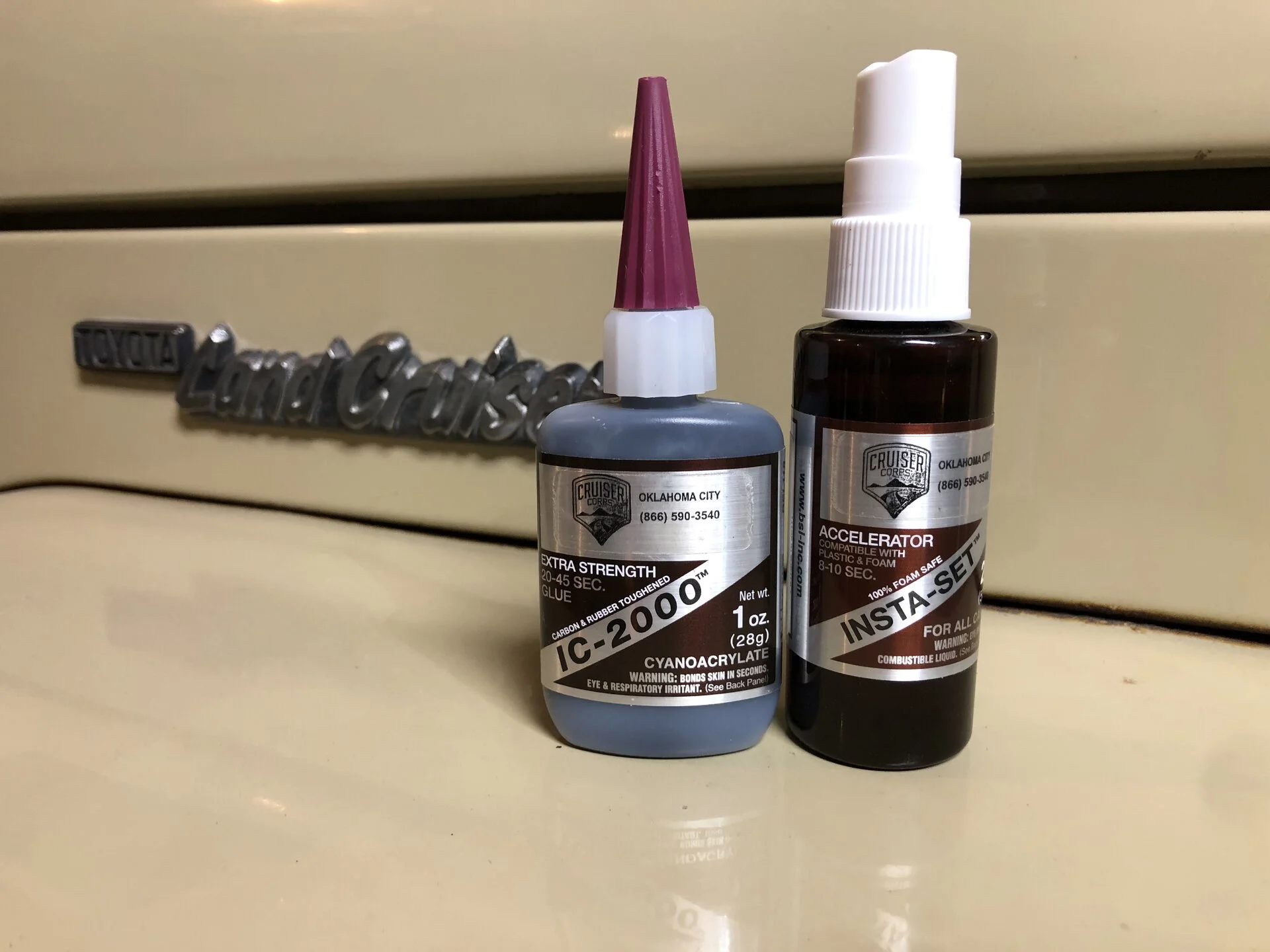

instant bond, no waiting, no do overs, that kind of instant bond.
Applying a generous line of adhesive ensures a secure bond. The tip about laying out the gaskets overnight on the door with a heater on the night before can be beneficial, possibly aiding in easier application and better adherence. This attention to detail and process can contribute to a well-executed and durable result. Nice one 👍
