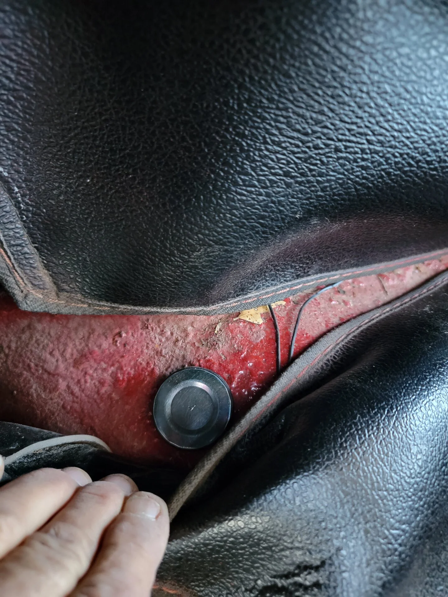

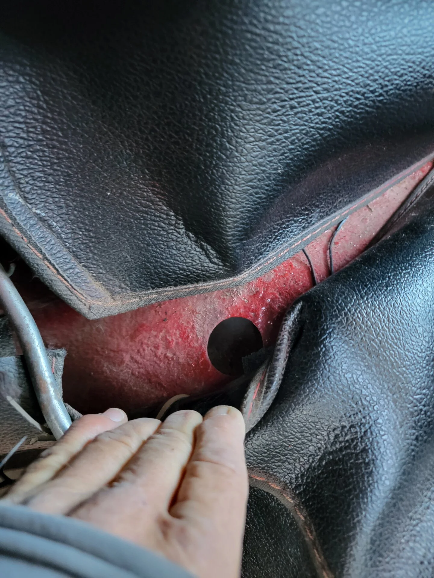

1" electrical knockout plug and an O ring does the trick. Bend the prongs out a little for a tight fit.
