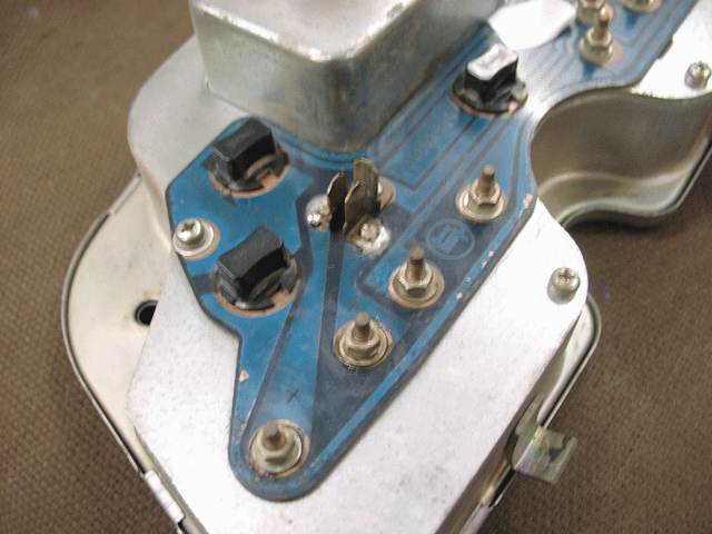

ampboard.gif My 79's gauge never moved more than 1/2 a needles width and when I restored it was determined to make it work. Tracked the problem to dash circuit board amp inputs from wiring harness (both terminals) and one of the gauge to board connections. I chose to just solder the wiring harness inputs to the traces rather then cutting the rivets, cleaning up and re-riveting. Testing with a ohm meter will tell you if the connections are dirty.
