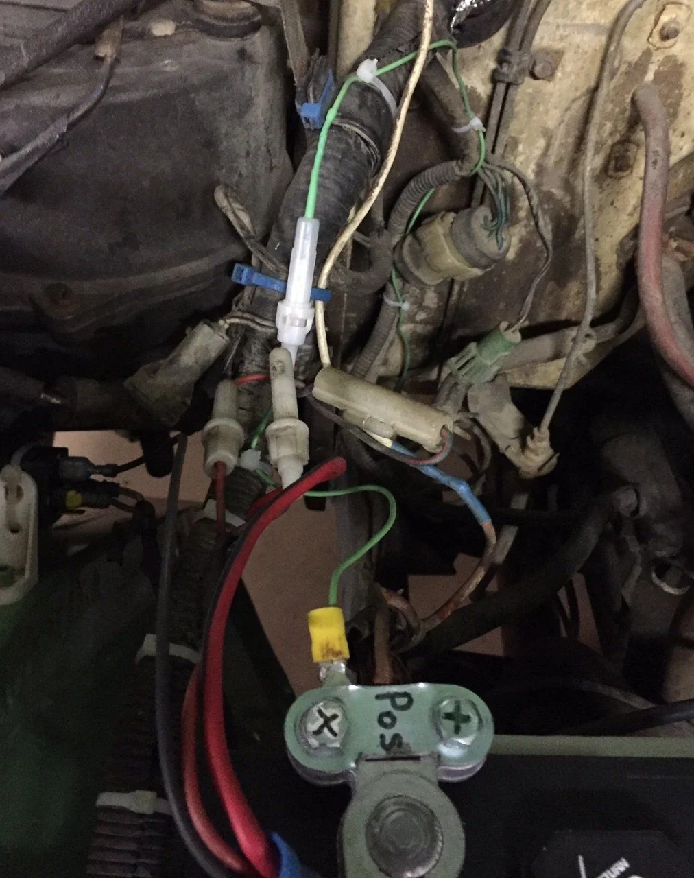

Let me post a pic and you can see if this wiring is stock or if the PO got creative. I say this only because if im remebering this correctly there are 2 wires and fuse holders (one their own) connected to the pos side of the battery but not part of any other larger leads...just direct to some of the lines. (if i said that correctly) - some pics will better explain.

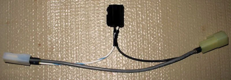

Your fusible link should look like this except it will be taped up. The connector on the LEFT of this image plugs into the main wiring harness. The connector on the right, plugs into a wire that goes straight to the positive battery terminal. The gray wire shown between the two connectors is the actual fusible link.
The two pin connector on the top of this image plugs into the small box that has the two amp meter fuses in it. If your PO has hacked up your harness, I sell the parts and the fusible link to make it whole again.

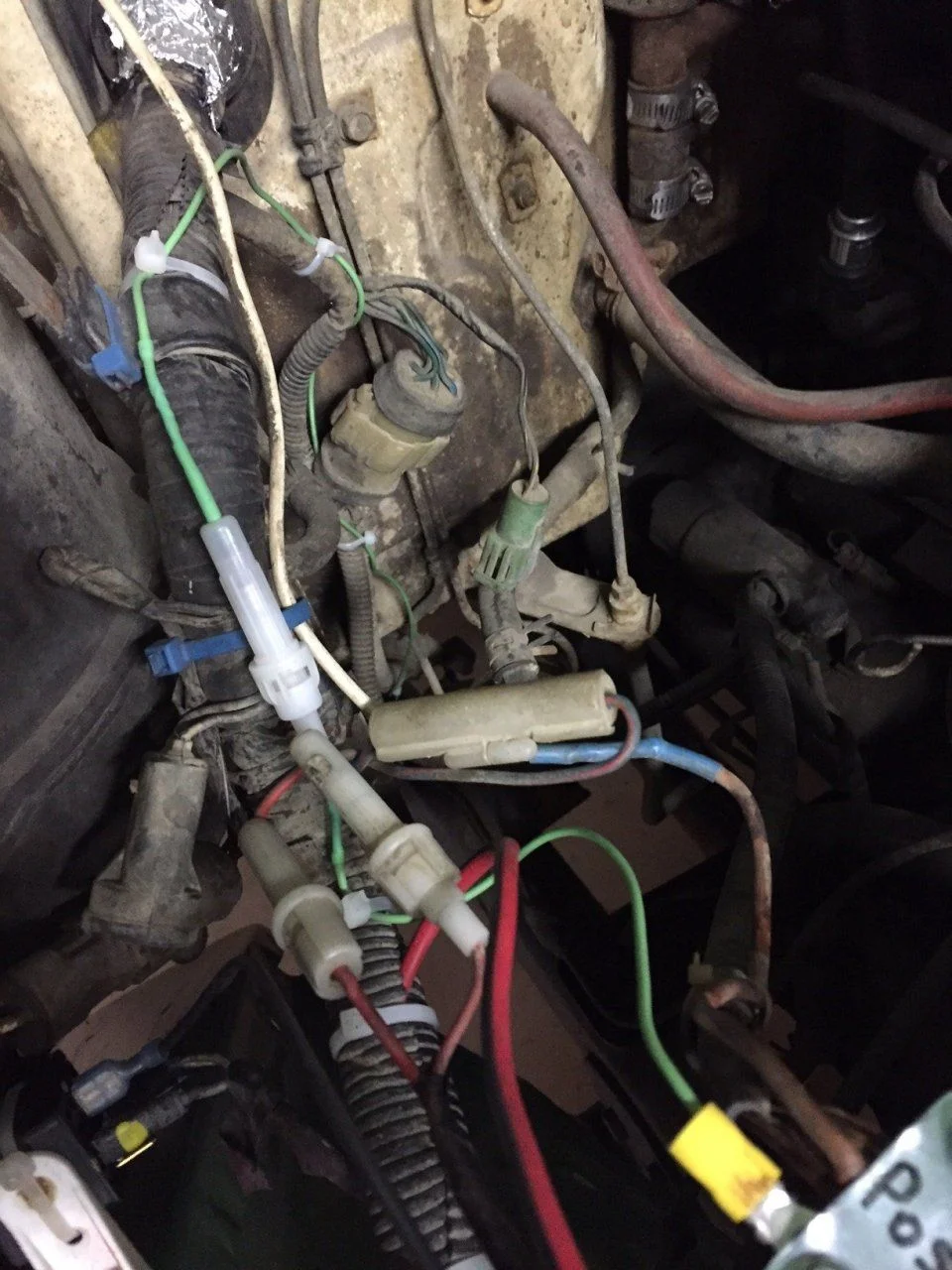

so above are a few pics of my situation. Please ignore the fuse case attached to the bright green wire...a jumper for my back up lights (long story)
Otherwise - im not seeing coolermans connecters hes referenceed in his fusable link pic. Thoughts?
