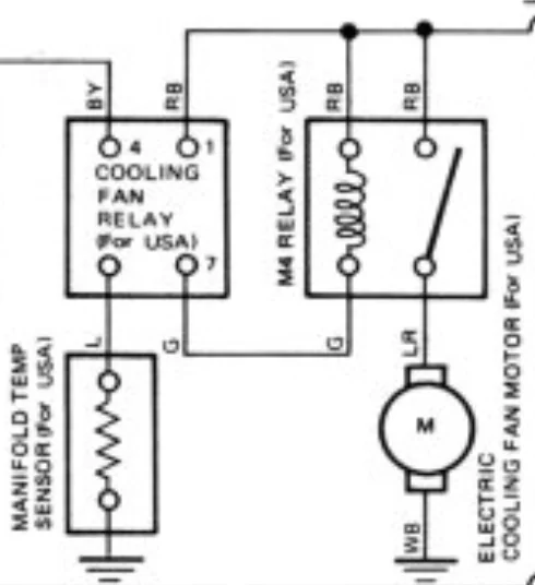

Never heard of that inline fuse! Do you have 12VDC between the hot wire at the fan connector and any ground? Continuity between the back of the thermistor and the fan connector? I don’t recall a computer in the mix here - the thermistor is the path to ground through its threads on the exhaust manifold. When cold resistance is high, when hot the resistance is low and allows the ground path. I guess there must be some switching to make sure the fan is only on when the engine is off though.

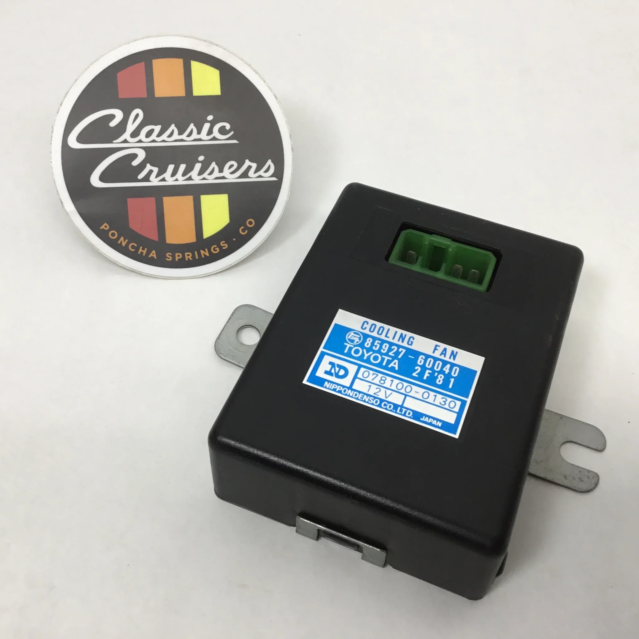

When I removed mine in the process of my LS swap I did find the carb fan controller - it's behind the passenger kickpanel and looks like this

Thank you very much for your offer. I do have a few of them around here and did swap in one to test and no change. I wish I had the electronic smarts to know how to test and see if one of those controllers were actually the issue

So I do have that thermistor on the bottom of the EGR tube. But I chose to direct ground that blue wire vs using the thermistor to see if that was my problem. And no, I’m not getting 12v to the plug at the fan. What I’ve read (and talking with @LETSROLLEM ) is that 12v supply shares some of the same track as dome lights which is the only other thing not getting correct voltage. After googling this and reading the same 4-5 mud threads several times it’s mentioned these two service areas share a 5amp inline fuse. I believe it’s on earlier models but no idea of the cutoff year. May even be 40 related and not on 60’s. More research ahead.

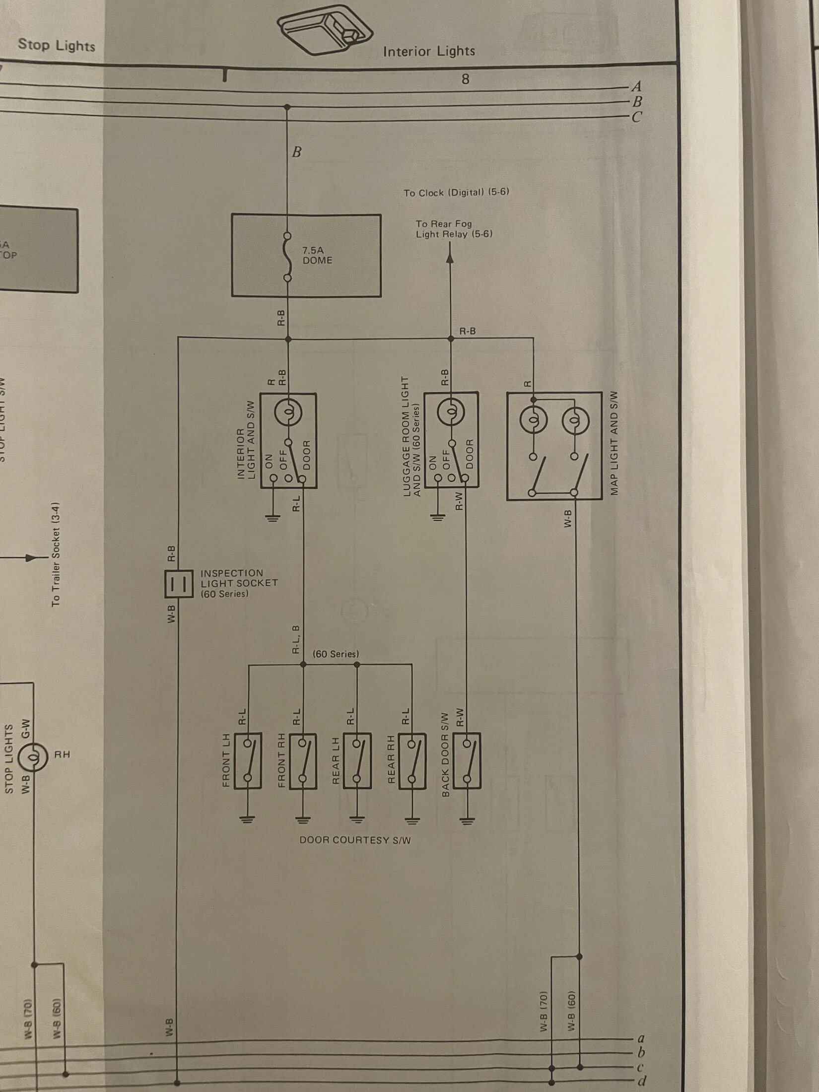

The dome circuit really seemed like Toyota’s trash bin on these trucks. “Uh, guys. We’re all out of fuse spots and we have all these things left that need fuse protection, what do we do?” “I dunno, throw them all on the same circuit and use a weirdly small fuse that’s impossible to remove with adult sized hands. And make it 5A!”
I know there’s a splice hidden inside the harness behind the alternator, so a hidden fuse wouldn’t surprise me. Also, what about one of the dome light door switches shorting out? Might be shorting some amount of voltage to ground which would cause issues: the system voltage would be lower and the body ground would have a slight voltage on it too.

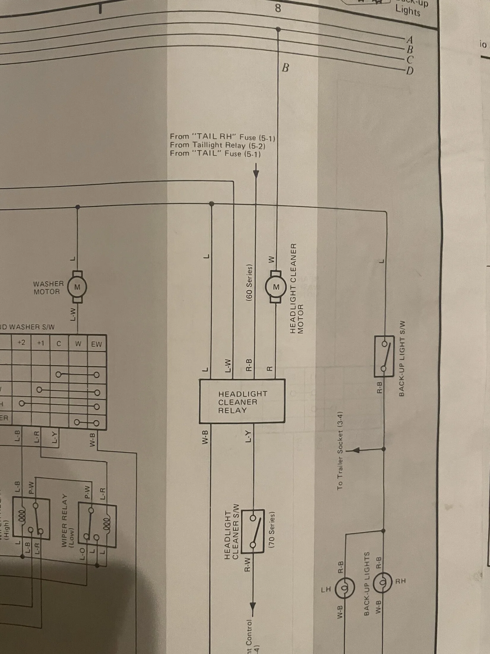

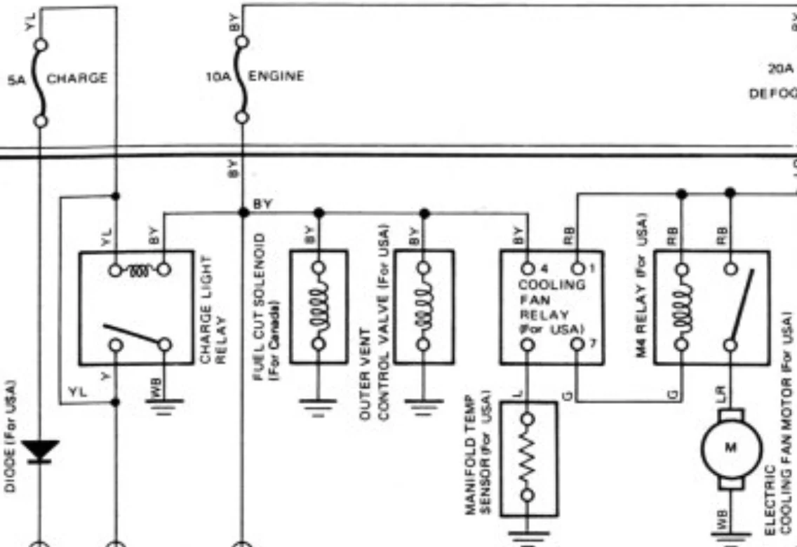

Ok Jim…so your thought in the last paragraph is rolling right over my head :). voltage to ground??? I have zero voltage at the drivers front door switch as well as zero at the center dome light. I perused the wire diagram in my FSM and found nothing on the carb fan. Did find the dome light and 5 switches.
It looks to be powered by row “B”. Problem for me is I have no idea how to read this and do not know where “B” goes. From removing/installing several 60 harnesses I know where to tap in with the multimeter in the kick panel. Also found the power for the headlight reservoir is tied into “B”. Will dig around checking for voltage a bit more manana.
Voltage to ground meaning a short! Maybe there’s some crud in on of the door switches that’s conducting a little voltage to the body (I.e., acting as a resistor). But if you don’t have 12V at the door sensor or the dome something else is likely going on. Is the fuse holder for that circuit getting power? Sometimes a fuse can look good and be bad too.
Anyway back to the fan. I think the earlier wiring diagrams are much easier to read than the multi page madness that n the later FSMs. I can email you an early one if you don’t have it. I’ll take a peak tomorrow too.
That would be awesome. Olddogcruisers@gmail.com. My FSM is from 1984
Sent you the FSM. Here's a couple screenshots. Looks like it's on both the Dome fuse (what the power bus line at the top right of the first photo goes to) AND the 10A "Engine" fuse". There's also two relays.
