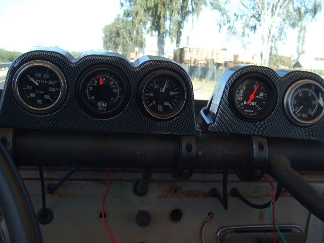

Here is how the gauges look while doing 68mph.
Top pic is flat road
Bottom pic is going over and overpass.

ultra fresh .. ultra low EGT at low boost .. and excelent oil press .. looks lie you have plenty of more room for fuel .. :D
We'll have ductape.. Install on the trail :D
I have the EGT probe in the back exhuast downpipe since it is the hottest part of the exhaust.
ultra fresh .. ultra low EGT at low boost .. and excelent oil press .. looks like you have plenty of more room for fuel .. :D
My air filter is not big enough or I have too big of Turbo on it. (Lol). My little dirty filter monitor slams shut when i stand on the gas pedal to pass someone. Turbo boost goes to 23lbs when i do it as well.
The hottest the engine got was 180 degrees F.
means post turbo .. ?
Diferent engine .. but I cruiser my 1HD-T around 700 - 800ºF pre turbo pushing 9 - 10 PSI @ 2000 - 2200 rpm
Well if it spools up quick enough for you then id say it isnt an issue of turbo being to big but more of not enough air flow.
and im with Tapage, I have my EGT probe At the collector pre turbo so i know what the temp of the gasses coming out of the cylinders is to help prevent a meltdown. mine needs a bigger turbo, Ive had the EGTs in the 2200*F once or twice, and it gets there quick!:bang: the plus side it it hauls some A$$!!
And wouldnt the down pipe post turbo be cooler than pre turbo??
could be wrong, guess tomorrow i can get my infrared thermometer and find out to be sure.:meh:
