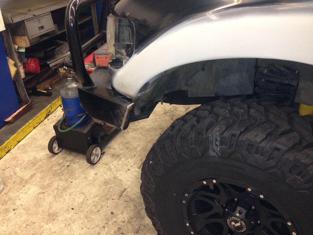

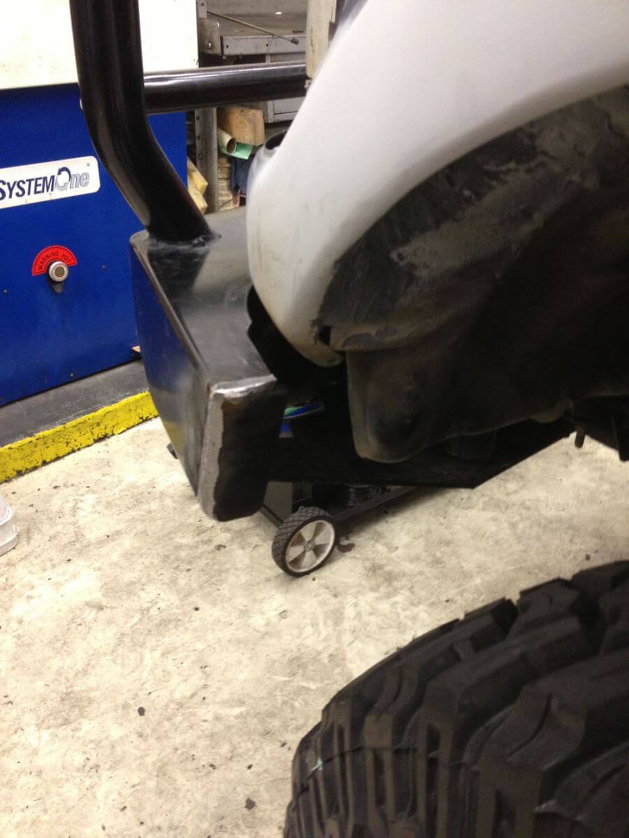

Cutting Front ARB to fit 37" tires
Before I left yesterday I had also cut the front bumpers to better match the fender lines. I used the Plasma cutter and a straight edge which made the job a breeze. Here is how it looks.
Here is the straight edge, ground for plasma cutter, and line I will be cutting.
Here is how it looks cut. I am going to cap this. I was thinking at a later time of adding a led on the cap to help people in blind spot know when I am changing lanes :steer:

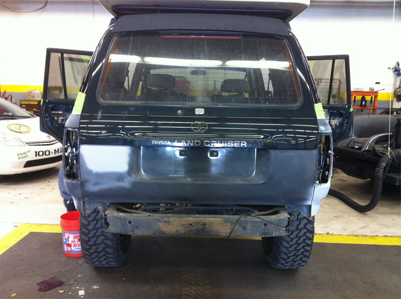

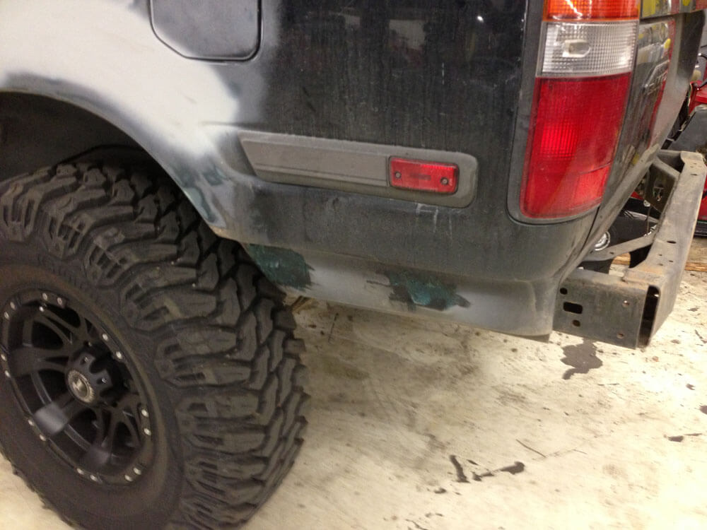

I did find one little project after I pulled the rear bumper. There are two holes in the bottom of the quarter panel one from the factory bumper trim and the other was covered in some type of round tape sticker at the factory. I do a lot of water crossings so I figured plug the holes. Kity Hair Drying:

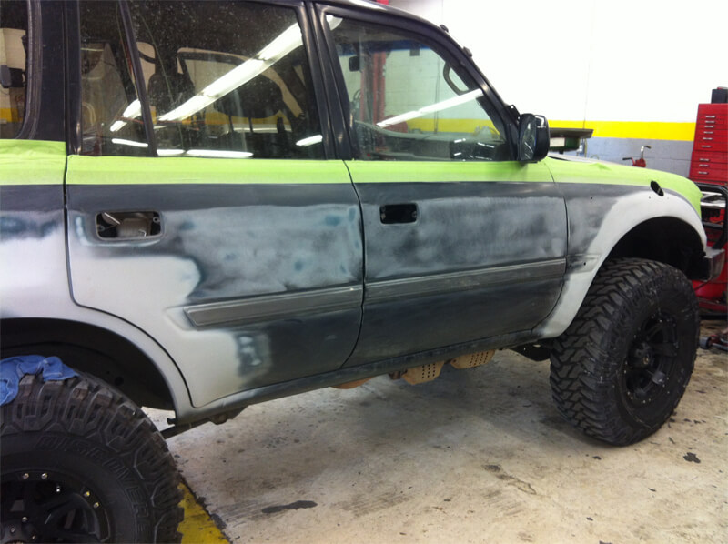

Here is an update. The bed liner was damaged in shipment and was sent back. :flipoff2: Grizzly Grip was kind enough to eat the shipping and ship overnight here by 11am tomorrow!! So I got the truck all sanded and taped. I will be rolling on the bed liner tomorrow from the green tape down. Still waiting for shocks. I may not be riding on the radflos in pismo. Here is everything scuffed and prepped for bedliner.
Scuffed and Prepped:
I also prepped and scuffed the hood. My thoughts are cover that crappy oxidation look with bedliner and I can use the hood as a work surface to hold winchline, tow straps, tools, etc.. without worrying about paint. It will be a makeshift trail workbench. :hillbilly:

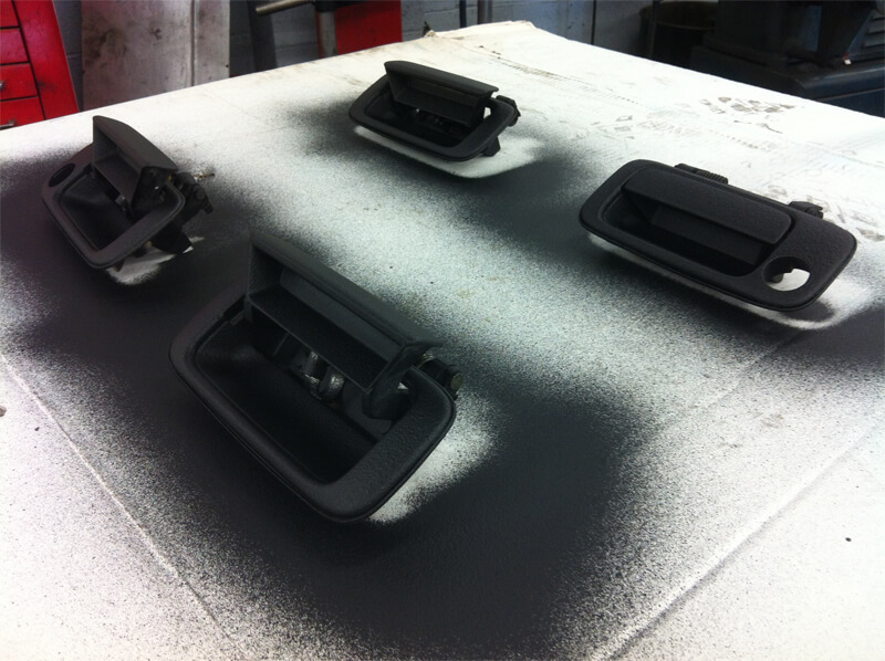

The next step is to get the bedliner on. The one area that really represented an issue for me was the door handles. I pulled them and removed the lock cylinders. I sprayed on the bed liner and they are drying off to the side. Here is how the handles turned out.

Did you tape of the mechanical parts of the door handles on the back before you sprayed? It looks like they might get goober'd up if you didn't.
