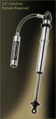

Part of the reason for cutting was using longer travel shocks. I am going 7" travel shocks up-front :clap:
Here is a radflo shock

Delancy, As soon as the radflo's show up I will send some pics of flex etc... my understanding is I will have the CG of rig lifted 4" inches and the travel of a rig lifted 7" now that I cleared room out in the fenders..... back at ya :flipoff2:
