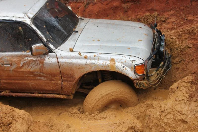

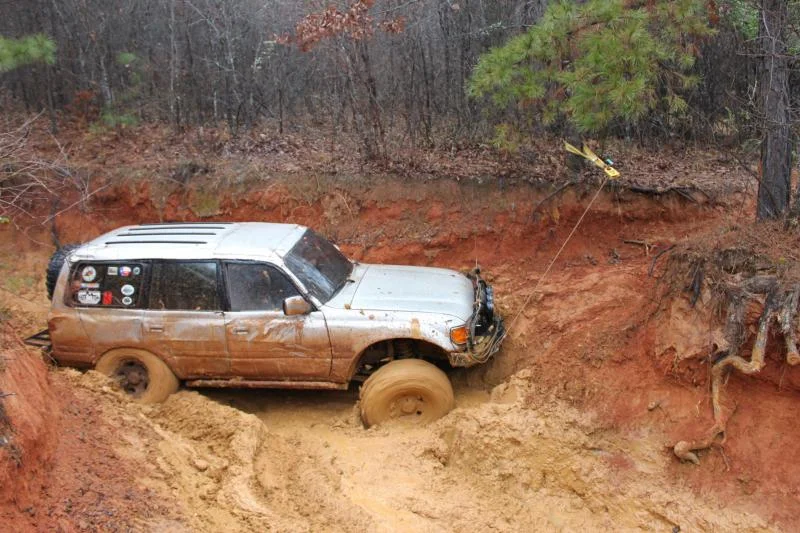

If your going to wheel it you are going to need to trim the ARB bumper also. It will bind up with the tire bad under compression. Not sure if you can tell by this photo. Will try and find another
If your going to wheel it you are going to need to trim the ARB bumper also. It will bind up with the tire bad under compression. Not sure if you can tell by this photo. Will try and find another....

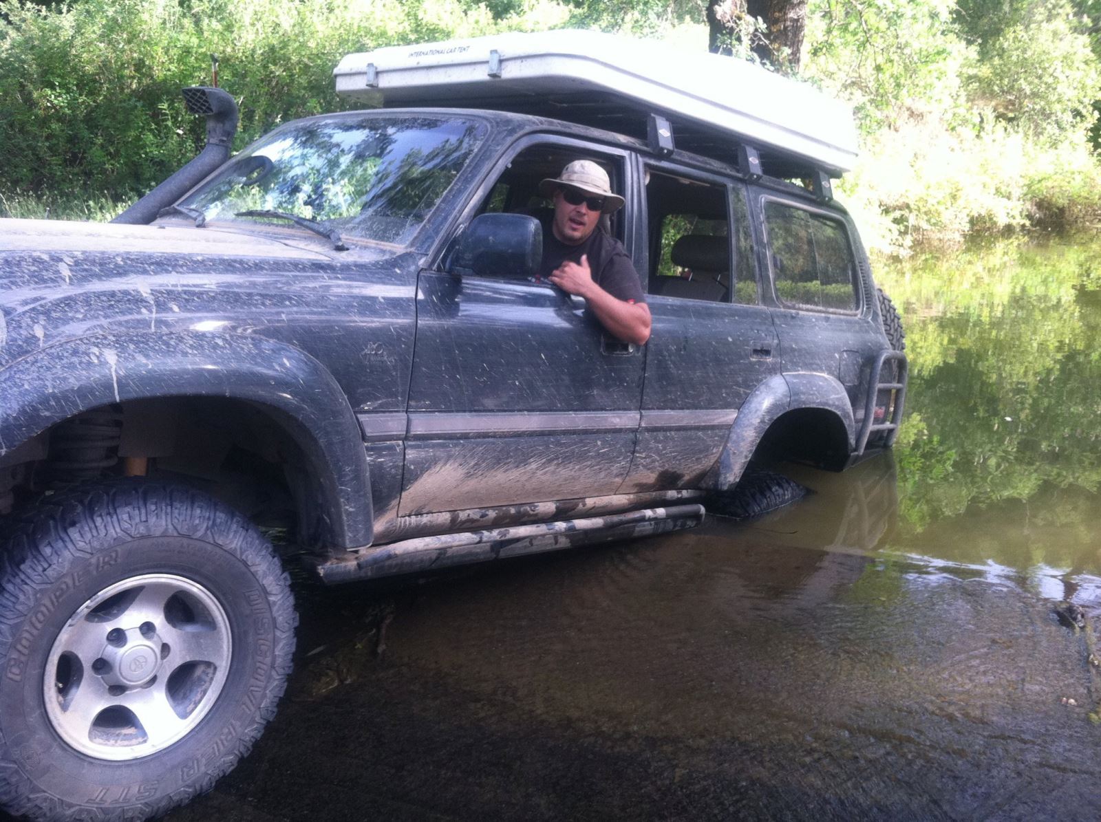

Did you tear that tire off with your bumper cut that much!?! If so F#$K
I will measure my rig to the top of the RTT when I head back to the other lot not quite sure
No, lost the bead on a extreme off camber turn. Just trying to show how much we trimmed. With out it would catch the tire when yo stuff and turn.
Once you trim the front and the bumper its not bad up there. The rear is really stuffed in though.
I appreciate it, I have been looking for a height to reference when thinking about what size garage door to plan for.
37s + RTT should be enough to be on the safe side.
Ok, perfect. Breathing easier now. :clap: I am planning on cutting bumper and sliders when I can get fenders fitted.
(just because / Thread Jacker):
I took the tape out there and measured... 99.5 inches. Heres the details... Loaded drawers(always ready to go) & 63 Quart fridge in the back. Also, full tank of gas.... Factor that in... for what its worth.
"2) I am surprised that part of the ARB can lift the vehicle."
ARB is tough. That truck was upside down at 70mph on the highway. Ground down big chunks of the bumper. NO issue. Do wish we would have welded a plate on the ends where it was trimmed as that has weekend the structure of it.
Sunroof was gone and the roof was laid down pretty good. Used hydro jack to force it back up. Lexan windshield also
