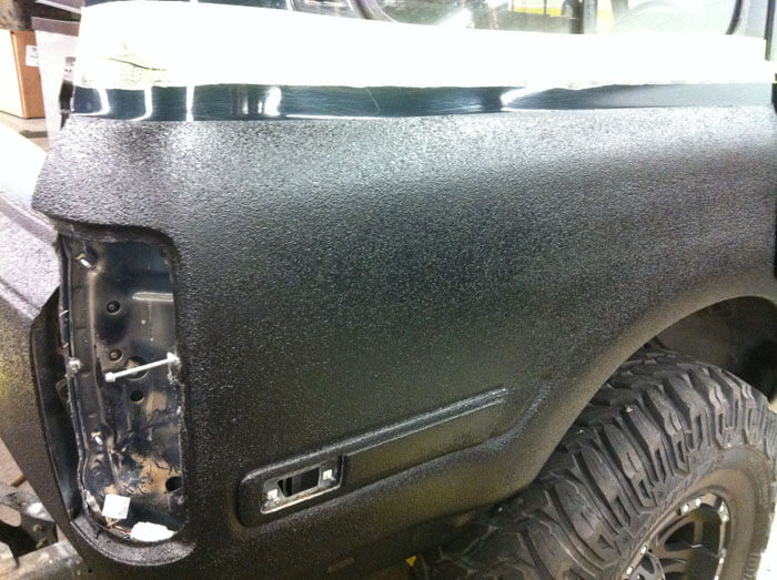

Did you tape of the mechanical parts of the door handles on the back before you sprayed? It looks like they might get goober'd up if you didn't.
I applied a super thin coat of grease. After I sprayed & it dried whatever adhered to the grease simply wiped off.

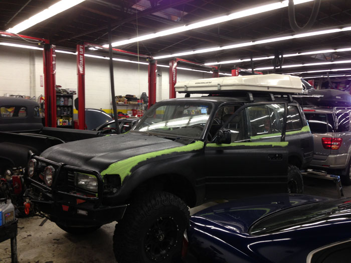

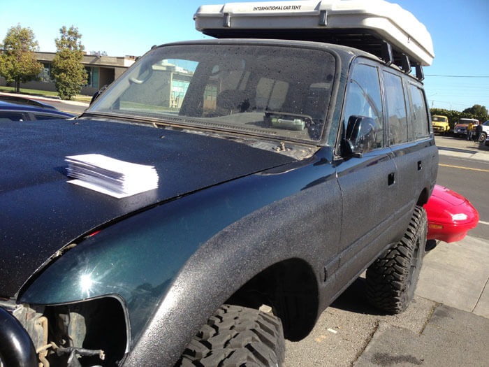

So, I got to rolling this morning early and started the day crazy high on paint fumes :eek:
I have one coat on so far and this is how it looks. Sorry, the light sucks but hopefully you get the idea. Brushed the hard to reach places and rolled the rest. I was stoked with the coverage and everything looks uniform (no roller patterns etc...) The LINEX Guy wanted $4,500 :flipoff2:

Bedliner Two Coats
How many coats are you putting on the truck? What kind of texture is the liner?
Two Coats. I have done this on many different ways on 6-7 rigs. Mine is the 8th. Usually Two coats is enough unless you are doing light color on a dark... Tan on black took 3 coats.
I have used Grizzly Grip: http://grizzlygrip.com/
Finally Seeing the light at the end of the tunnel
Nice! I really wanted to get the whole truck sprayed with line-x after I get it all welded up. But I've been reading lots of good things about the monstaliner, and I'm contemplating going this route. How thick we're you able to get the liner, and how much did you end up using? Also, can you get any close up pics low the texture?
As thick as you want. Grizzly Grip Takes 2 hours to recoat. So you can build it up 1/16th of an inch at a time.

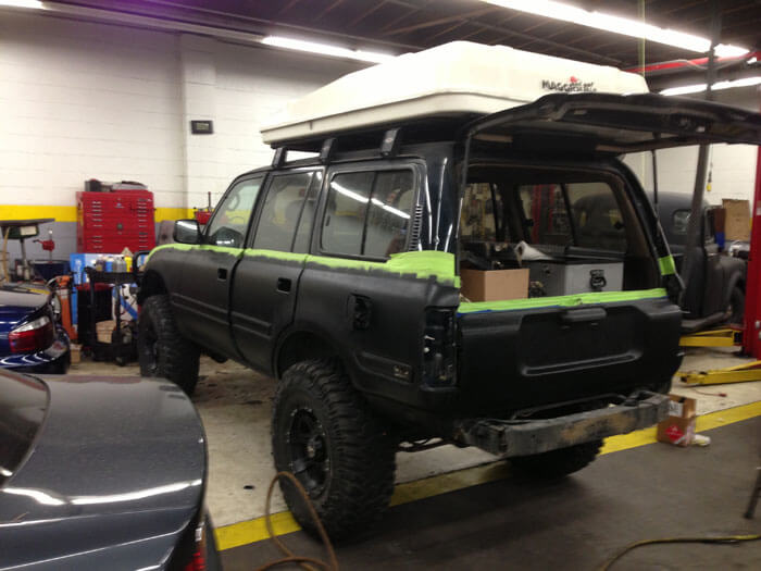

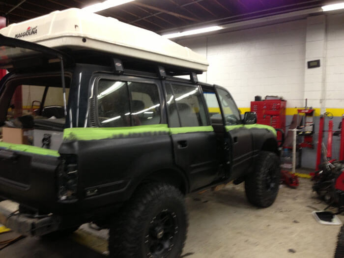

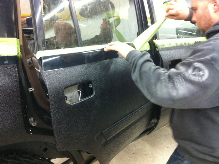

Here is some shots of me pulling the tape off. At this point it was roughly 3 hours of dry time. 2 hours from first coat... pulled tape off 1 hour after second coat. My brother showed up and took some action shots:clap:
Peeling back tape:
Here is the closest shot I got so far of the thickness of the liner, I will get more when I pull it out in the sun:
More tape peeling:

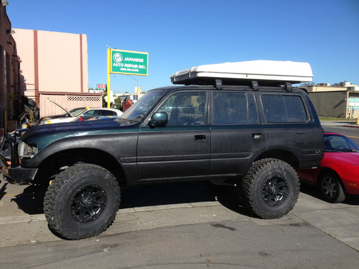

37" Tires FZJ80 finalizing the project
The rig is out front getting some Vitamin D.... Here is what it looks like bare. I will be putting all the door handles, snorkel, bumpers, sliders, and random S*&T back on in a few hours. :D
I was trying to figure out a place to put the (40th Edition) badges back on the sides... any ideas?
Wrapped up fitting the 37" tires - Body Work Done
I grabbed some pictures of the final project:
Drivers side at Pismo in the morning. I am digging the strip of factory paint! :D
The other side of the rig at camp:
Here is a shot of my rig (closest) next to one with 33's, and then another with 35's just to give some perspective of the size difference and the amount of metal removed:
