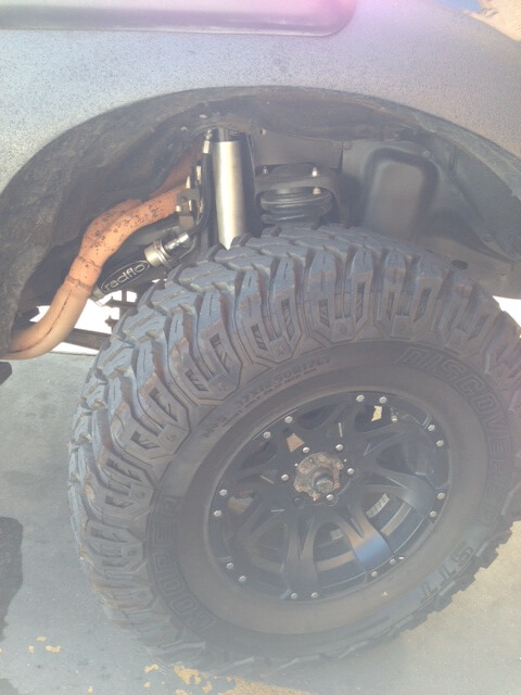

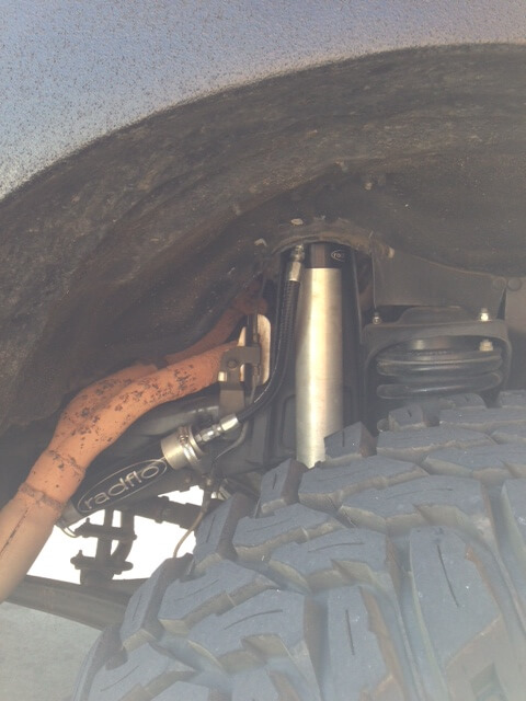

Should be a day or so. I got back in this Thread as I had to pull the Radflo shocks back off. Piggy back style would not work so Radflo is installing longer hoses to remote mount the reservoirs.... More to come

Considering remotes for the 80 Radflo's for a number of reasons, one being an effort to minimize the shock body from spinning, which can put resi in a contact path.
Was there a reason you went with the piggy backs over remotes?
I switched to remote mount for the reason of spinning and ripping of reservoirs in mojave.... After trying every possible position of mounting the piggy backs there is no way to get the clearance with the 37" tires. I tried it all.
How did you mount them?
I mounted the reservoirs like This. And I checked the temp of the reservoir (due to proximity of the down pipe on pas. side) after driving in hot weather and after heat soaking when car is off after a long drive. it never gets to hot to touch... I zip tie 7Eleven burritos to the reservoir and they are perfectly cooked when I get to camp :hillbilly:
