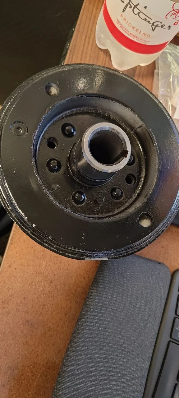

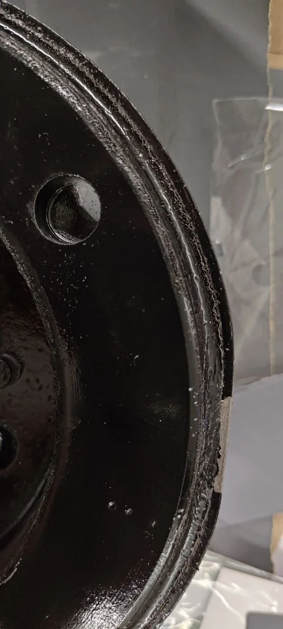

Today i died a bit inside. Again. Im so sad and angry at myself the same time when something like this happens. I was polishing the surface of the harmonic balancer and then it fell to the floor. I was spinning it on a stand drill and it just flew off.. after about 20 min of polishing...
Now that rubber is disconnected. I assume its scrap now. At least my research tells me.
But there is one light at the horizon. Ive bought the Vintage AC unit. From Cruiser Corps. Would i anyways need another pulley? Im just sad i destroy things which are so rare at this frequency.
Any advice is greatly appreciated!
