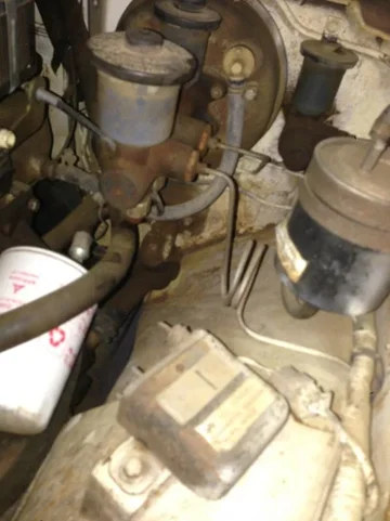

Very preliminary, but considering the pre-OP work commencing, asking for input on a few items to determine what additional work should be done, now.
I'm back to determining AC to be a must if I want to get more than a few months usage in OK. Not crazy about the appearance of what I've seen from an aesthetics standpoint, but little choice if I want to drive more than 5 months out of the year.
Brings several questions concerning the mechanicals, but have seen the combo units and they appear to be the way to go, but uneducated in that department.
Reason for asking is its the ideal time to patch the heater hole in firewall, because I don't want to regret not doing later, yet unsure if I should do it now, without a clear plan to achieve an install.
(Somewhat related: How do the AC kits adjust idle?).
Also, I don't believe any of this will remain on the DS inner
But not certain of that, so posing before cutting off and filling any unused holes.
Considering that she's going to remain relatively OE-ish, is there any other firewall of inner fender holes that should be deleted at this time?
The existing shocks were poked through the inner, but think the Radflo's will too. Should a 1 1/2-2" hole be considered above the shock tower in an effort to clean up?

naw, it drives me crazy seeing the punched up section. never understood why they put stud style shocks on. someone else posted a pic of the punch out drilled out and it looked very clean
No, the little black box is the VSV for smog...you won't need that or it's bracket.
