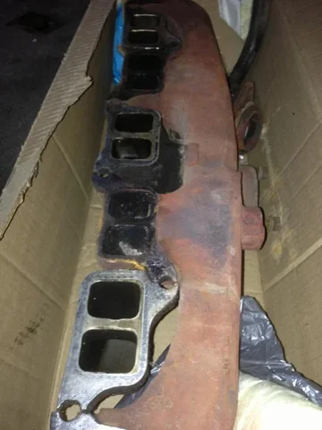

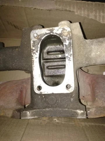

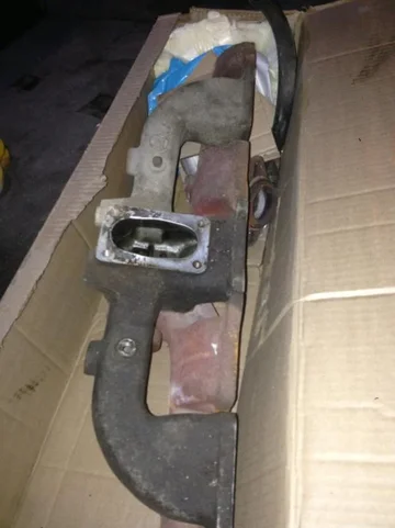

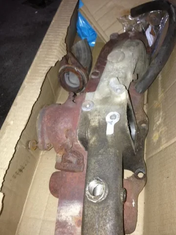

sorry, but them things er boat anchors.....all 2F exhaust manifolds er boat anchors:o. CALIsucks:doh: buuuuut it's pretty OG for that look you're goin for. do not separate them, have the exhaust vacuum tested, and if it still has good vacuum, you can either have it milled for a good plane and run it OR go ahead and separate them, have the heat riser removed the shaft openings rebushed and the shaft polished and turned to fit the new bushings remate the intake to exhaust, vacuum test the exhaust and the know it's good for another 15 years....many of the single piece manifolds have warped or cracked, but that one looks pretty nice, you might have a good rebuild candidate. the 3 piece exhausts are much better cause they don't warp. but they still have more places to leak from. I'm hopin 3FE manifolds do the trick with a nce balance between multiple pieces but not many places to leak from. the head design is what I've realized is the downfall of the f series motor with its paired ports:rolleyes: shoulda done a Ford 300:mad:
School me, please.
oh, don't get me wrong, I'm died in the wool F series bandwagon cheerleader...aside from the Ford 300 having 7 main bearings, it has a head design where all of the intakes are on the right side of the chamber when facing the manifolds, and all of the exhausts on the left. This means that each individual port is completely surrounded in gasket on all 4 sides of it. IMO, where the F series paired ports marry, it effectively leaves each port only sealed on 3 sides of its runner, creating weak spots in the gasket at the longest sealed edge(top or bottom of paired ports, smack in the middle- the weakest point_on the gasket) this is why we are constantly battling manifold leaks. I noticed that the 3FE manifolds are also equipt with runners for each port that separate the exhaust ports all the way to the collector. too bad they'll never pass smog on a 2F.....
Cross-flow head is nice (vs. our counter-flow design), why will 3FE exhaust never pass e-testing on a 2F?
cause they won't look right:rolleyes: even if there is some sort of functional heat riser, it won't count in Cali cause it is not part of the original design...I might could get away with a ref sticker- big hassle, take it to ref, figure 300 bucks per visit, if he don't pass you, he'll give you a piece of what you should do and say come back. their schedule will have you wait another 3 months- but that's ok cause you need to have another kings ransom for the revisit. you can not have a second ref get into things ever. the one you get, is the one you get. you'll have to prove that the system works as it was intended from the factory if any mods are made. IF you can manipulate the system to get a heat riser to work enough to get the refs ok, and IF he oks the non factory EGR cooler location and pipes, and IF he feels it is all mounted in a professional and permanent fashion, and IF the system passes every variation of a dyno'd emissions test, then maybe he'll give you a sticker. FWIU, they don't give stickers to anyone but most valuable return customers;) I will try to build the "best" set up I can with toyota components, while also having the factory manifold kicked back into somewhat working condition and re do an exhaust tract for the "smogger" manifold, put it all into plastic garbage bags in the garage rafters only to be used for a day or 2 every other year:rolleyes: prolly even keep separate carbs. the 2 year shuffle...:mad:
