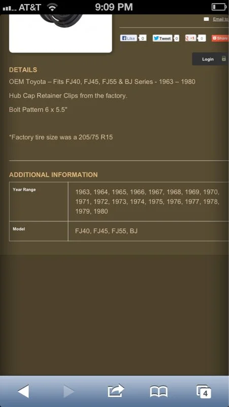

Are those drum-brake wheels or disc-brake wheels?
Answering my own question...Ige says those are disc-brake wheels. No rivets.

and no, that won't affect hub cap fitment. they are a tight fit and with new rims will most likely be very tight. even used rims sometimes require a bit of adjustment with a screwdriver or wrench to pull the clips in a touch and a rubber mallet to motivate the cap onward. better to be too tight so the caps don't come off easily.
Assuming y'all aren't jerking my chain for a laugh, what are the differences between the two and is that a concern, considering disc fronts and drum rears?
No indications of fitment issues were obvious when I purchased.
No. we got plenty laughs without jerking that particular chain...
IIRC (somebody will correct me if wrong) the rivits on drum wheels will interfere with the discs. Disc wheels will fit drums just fine.
