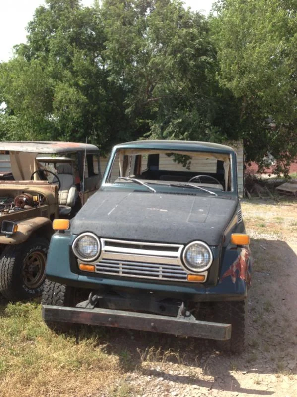

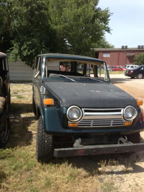

That's not a part out option. It was a running, driving shop truck that, I think, an employee wrecked. It was parked, vandalized, but Josh didn't think it'd be an option unless whole, for reasonable money.
Everything is for sale......
The blue one is what's being offered up as ready to pull and it does have hood, though I didn't see.
Money was discussed on the green and white that I could live with, but thinking they're more motivated, or more willing to pull what I need off the other, at least that's what I understood texting Josh after I left.

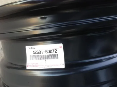

Did score 5 wheels!

Open Country M/T comes in a 33x10.5R15:
That is your tire!
NLA.
Going to check 4WP once they open, because it'll let be add to cart, but the wholesaler here said it's because they've not updated or they may have inventory somewhere, but that they're not being produced.

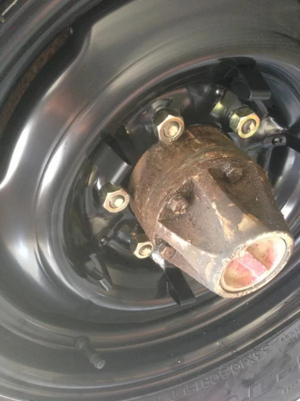

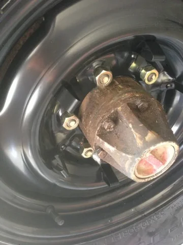

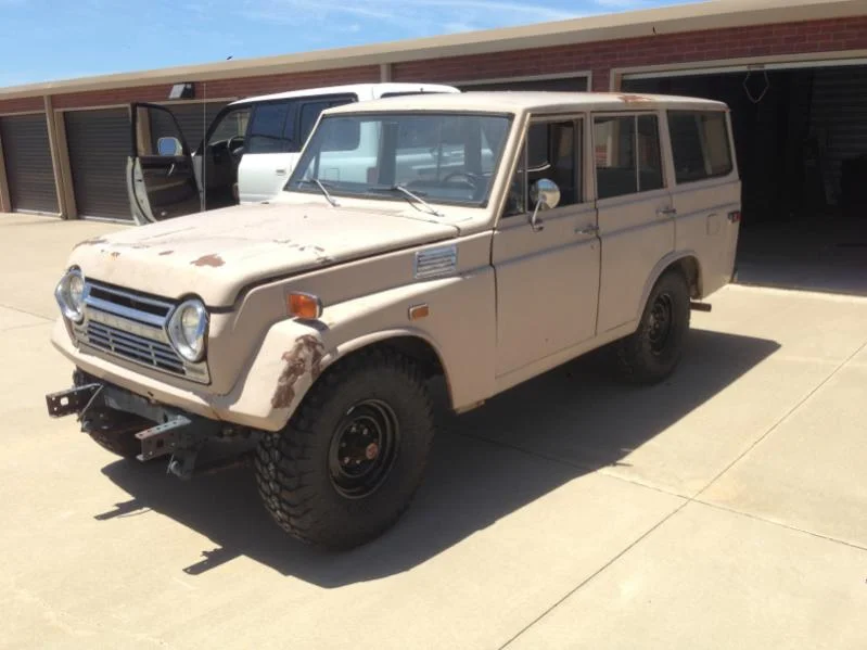

those lug nuts would not bother me at all ...
do a dab of paint marker on each nut over to the stud if really concerned.

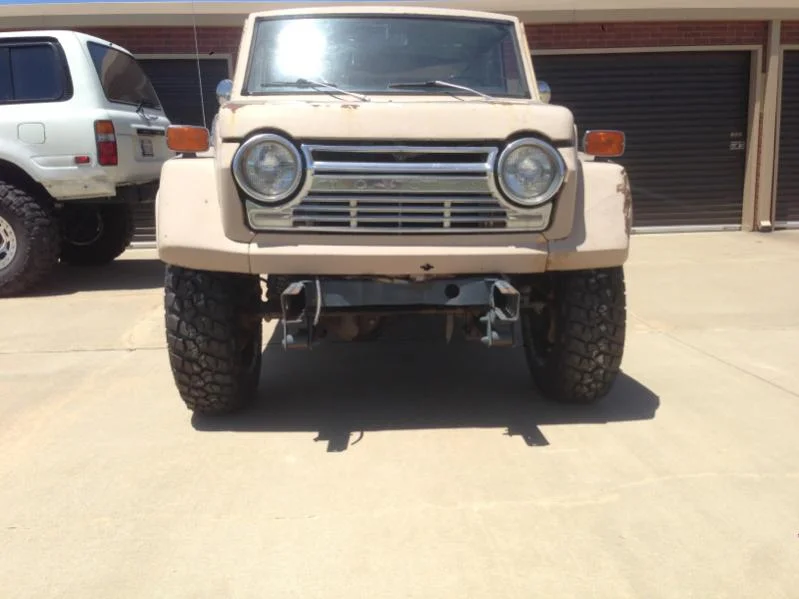

Had to push her out. She wasn't wanting to start and at 130-140 degrees inside the bay, I'm done for the day.
Caps wouldn't fit for love nor money, but last of my concerns.

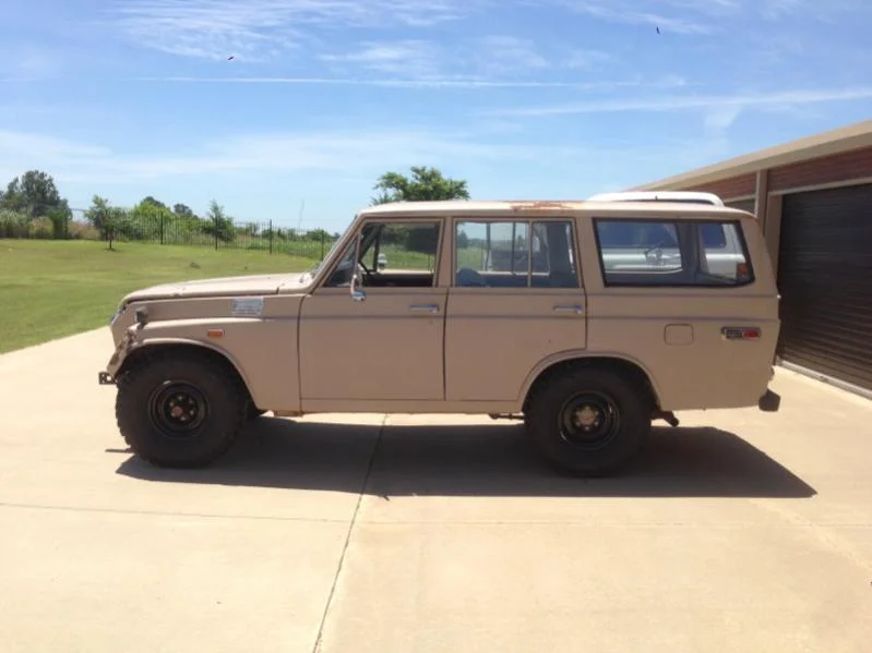

Going to run the 3-link calcs, cause she's dying for a lift now. Haha.
Seriously, think a minimal lift, if not decent springs may be the ticket. These are worn and the Cruiser lean is dramatic.
Thought the bevel on logs was wrong, but think its the bore is worn out from 41 years, so you're probably right and no cause for concern.
Will torque lugs again before/when driving.
You only have a couple of options as far as lift on a 55, either custom Alcan's (they have the specs) or Kurt put together an OME kit with 40/60/70 bits ... but you have to relocate the rear spring hangers. Either one will be a nice upgrade.
Or you can link and lift the hell out of it :flipoff2:
Tucker
The Alcans seen a good option since, I believe, they can vary the rate and height, but mostly because less is more, and 1-2" is all that I really want. Think they can do that.
Have communicated with Kurt and that seems a viable option too, but won't be using the OME shocks nor stabilizer, and until I had a definitive goal, didn't want to harass him about splitting up.
I'm wondering if OE height springs may do the job.
Considering the lean, I know they're tired and it doesn't look to bad, as it sits. Just a little higher will be ideal for mall crawling. Haha.

Talked to Mike from Cruiser Corps last night and struck a deal on the front of the blue and white 55.
Not the best deal, but the panels are decent, inners are good, he said hoods in good shape, so they're pulling everything fire wall forward this week.
Still waiting on a price for the 69. It's solid and the body is in great shape for these parts, but hoping he prices it so stupid high that I won't consider it. Hahaha. (I don't think I can handle one, let alone two).
Delancy, if only 1-2 inches why not just shackles. Inexpensive and quick. And to get rid of lean have springs re-arched. Or find a local shop to do custom springs. Have no experience with Alcans but heard good and bad about.
