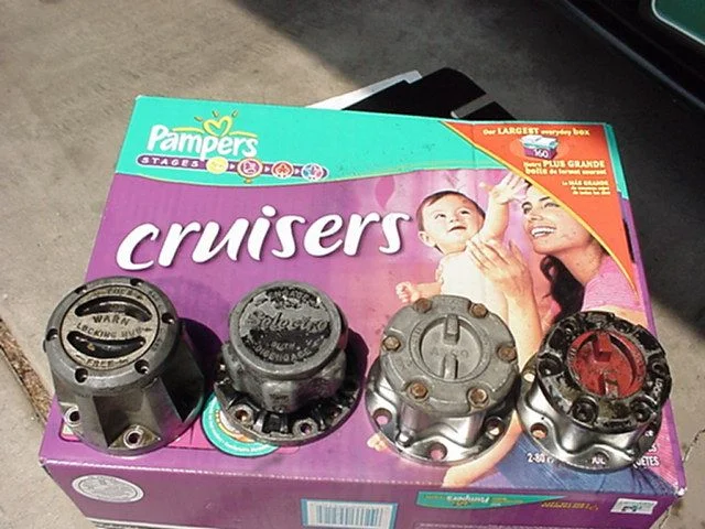

your rig has 30 splines on the diff ends of the axle shafts. your front axles have a 30 spline end where the birf joins the inner axle(or is it 27-nevermind it doesn't really matter here for all intents and purposes, point is they're the same outer end inner axle shaft splining either coarse birf or fine birf) your rig most likely has coarse splined birfield ends where they feed the hub/lockplate. you can put later fj4X/55/6X series birfs on your inner axles. the hubs listed as only for fj4X up to a certain year are most likely coarse spline. a long bodied hub or later factory short bodied hub are all 27 spline outer birfield end splines- unless you go A/M. so, you can get knuckles, arms, spindles, birfs, wheel bearing hubs, rotors, calipers, and lock-out hubs from the same later model rig, maybe some steering rods depending on the arms/steering box, and be good to go. I vote mini truck for everything but maybe the brakes, as stated by others

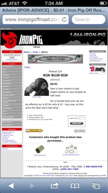

Built to accept the 60 TREs to eliminate the reducers and stout enough to handle power steering. (He suggested IPOR's. May call them today, since it's two cents for a penny. Haha, that's hilarious).

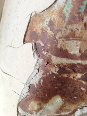

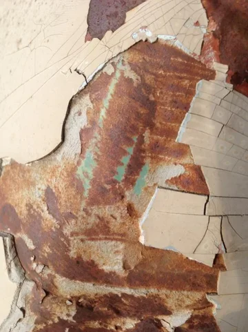

Lastly, little scraping this morning on the front fenders, which appear completely hopeless, and a new color presented itself, but can't tell if a donor fenders color, primer, or possibly the original color (even though the rest is mustard).
The amount of bondo on the front two fenders should be illegal.
Got to be 3/8" thick in spots.
