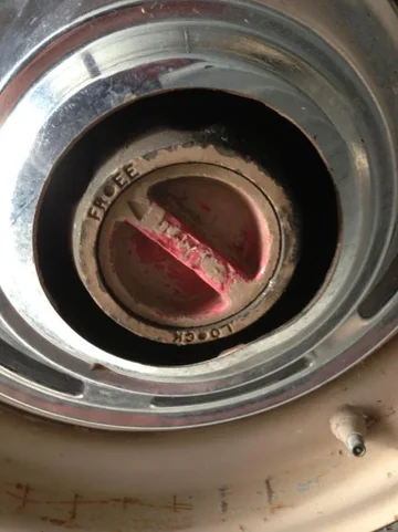

Have no clue what brand are on there, since there's no markings, but they're some kind of replacement, I believe, since cant find any similar in any Mud perusals.

IIUC, all front ends were full time till 76, so there are no correct hubs for earlier. those look alot like the warns I pulled off the drum brake axle I got. maybe milemarker? I believe the hub caps are different betwixt locking hubbed and full time axles, check SOR...
I got it now. Makes a lot if sense, considering the lack of available info on the hubs for the older years.
And the difference would probably be denoted in a long or short bodied hub, then.
Got the wheels sitting in OKC but wasn't certain on caps. Seems the best way to address, from a feasibility standpoint, is get caps for short bodied.
Doubt I'll loose a fair entry over, since the model years didn't have selectable anyway, and don't see a reason to not change to selectable, from a moving parts/longevity standpoint.

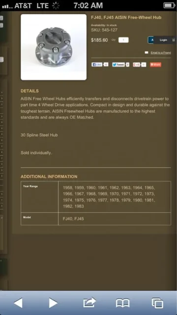

I didn't understand the naming until just now and understand why the search has been futile, due to.
Haven't priced them out elsewhere, but it'll be hard to not leave Cruiser Corps tomorrow or Tuesday when picking up wheels (probably caps, gasket "kit" and hopefully checking out needed body parts) with these.
Doesn't show compatible with models beyond 40/45, but can't see why they won't work.
d ATTACH]773066[/ATTACH]
Well, check to see if they're fine spline or course spline...
of you are going to a 60 series front then go to the fine spline ends at the same time.
Now, I'm confused but in fairness, it's Monday.
FromCruiser Outfitter's website.
Quote and posting for reference.

The CC page doesn't stipulate coarse or fine, but states "30 Spline"....which would elude a fine 27 spline birf, therefore compatible with 60 series fine spline birf.
Now, the rub is, I don't recall if swapping to 60 birfs was ever a consideration. It's not a wheeler (as of now), so trail spare continuity may not be a huge concern, but guess the question is, how's it possible to find a coarse splined lock out if the only available at that time were domestic dealer adds?
