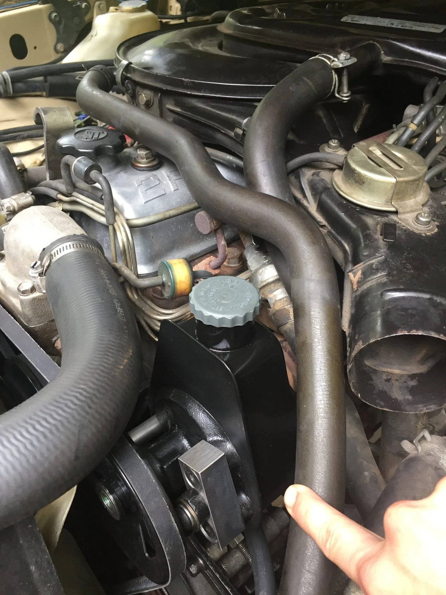

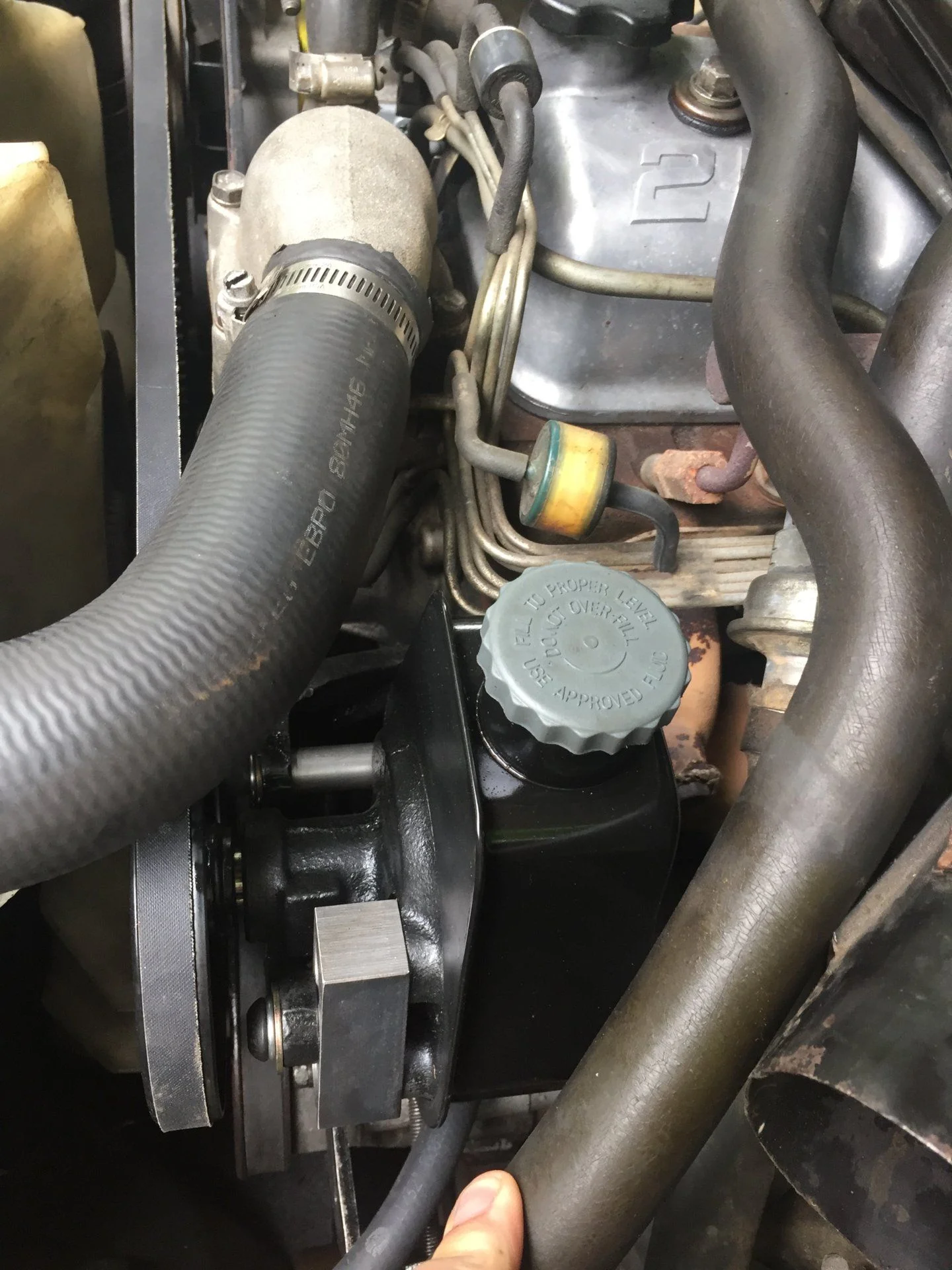

I got my Saginaw adapter and pulley from Georg @ Valley Hybrids on Thursday and churched it up a bit before throwing a coat of black paint on everything. Decided while I was in there to replace all the front cooling hoses and other belts and got to drive it last night. Very impressed with the assist and of course, no more unwanted moaning.
