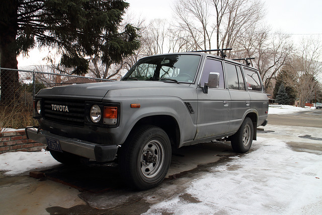

Well some updates and been promising pictures..
Here is the pic of BeBe with her new rack and mirrors!
IMG_0184 by renofizz, on Flickr

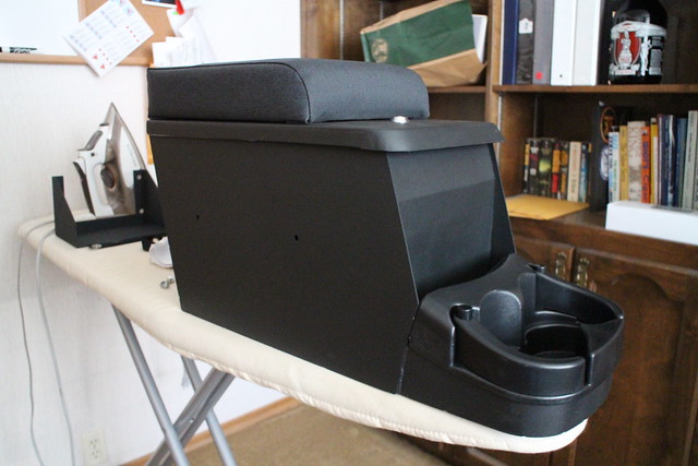

And for Christmas the family got me a bunch of Amazon gift cards, so today the box truck fairy arrived. Looks like I got some fun this weekend!
IMG_0221 by renofizz, on Flickr
Thanks Ed! Hope to get it in this weekend along with the new rear hatch struts.
